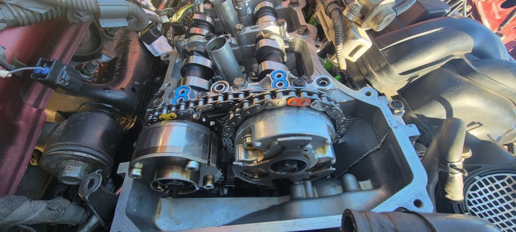

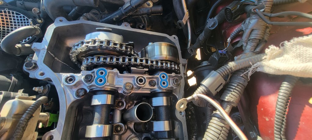

    pulled both valve covers off and the timing looks spot on yellow with yellow and the orange and yellow all line up on top. I have pictures if that helps. We also checked the cam gears and they seem to be in the knock pins. I am baffled still 200 psi on bank 1 and 30 psi on bank 2. No damage to pistons or valves.

    I know that it is a huge job to confirm, but do you know that your timing mark is right on the crank?
    I would find top dead center on one of the pistons on each bank, then compare that cam position on each bank. With the respective piston at TDC, the cam lobs should look to be in exactly the same place rotationally. This feels like the problem since it is all four pistons on bank 2.

    I hate to suggest this, cause it's a ton of work. Take the front cover off and realign the timing marks. Check, double check and triple check. I'm a former ASE mechanic and the 5.7 is easy to screw up. The chain links have to be exactly correct on the cam gears when the crank is in the perfect position.

    Currently I have on the driver’s side intake 13511 0S010 Drivers side exhaust 13512 0s010 passenger side intake is 13513 0S010 and passenger side exhaust is 13514 0S010 it seems the sides are switched but in the correct intake and exhaust position is there a unique difference between the 4 cams and could this be the issue?

    Just an update we changed the cam shaft order to the proper side and the truck runs much better. Definitely the 4 camshafts are unique to each other. Now that I have reassembled it makes a clicking sound (Like a diesel engine) on the driver’s side near the front of the valve cover which I think is the secondary tensioner. I am guessing we banged it up on the cam swap.
    Just a quick question regrinding the primary chain that goes to the crankshaft should the side going down to the crankshaft be less tight than the side coming up from the crankshaft? So the opposite side of the primary tensioner the chain is definitely loser going back to the crank does that sound correct?
