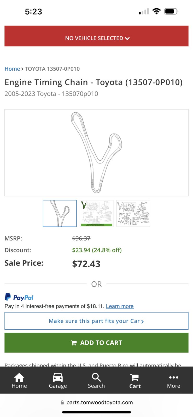

    Who sells a good aftermarket timing chain kit?Oem is just to expansive.

    Jowett New Member

    Nice chain but I was looking for a kit
