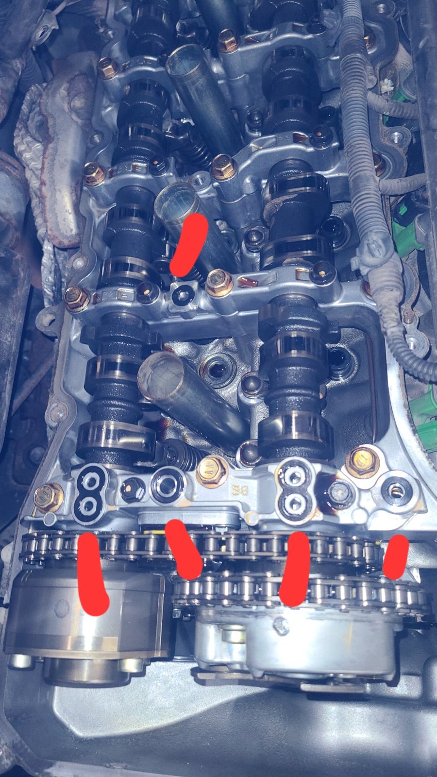

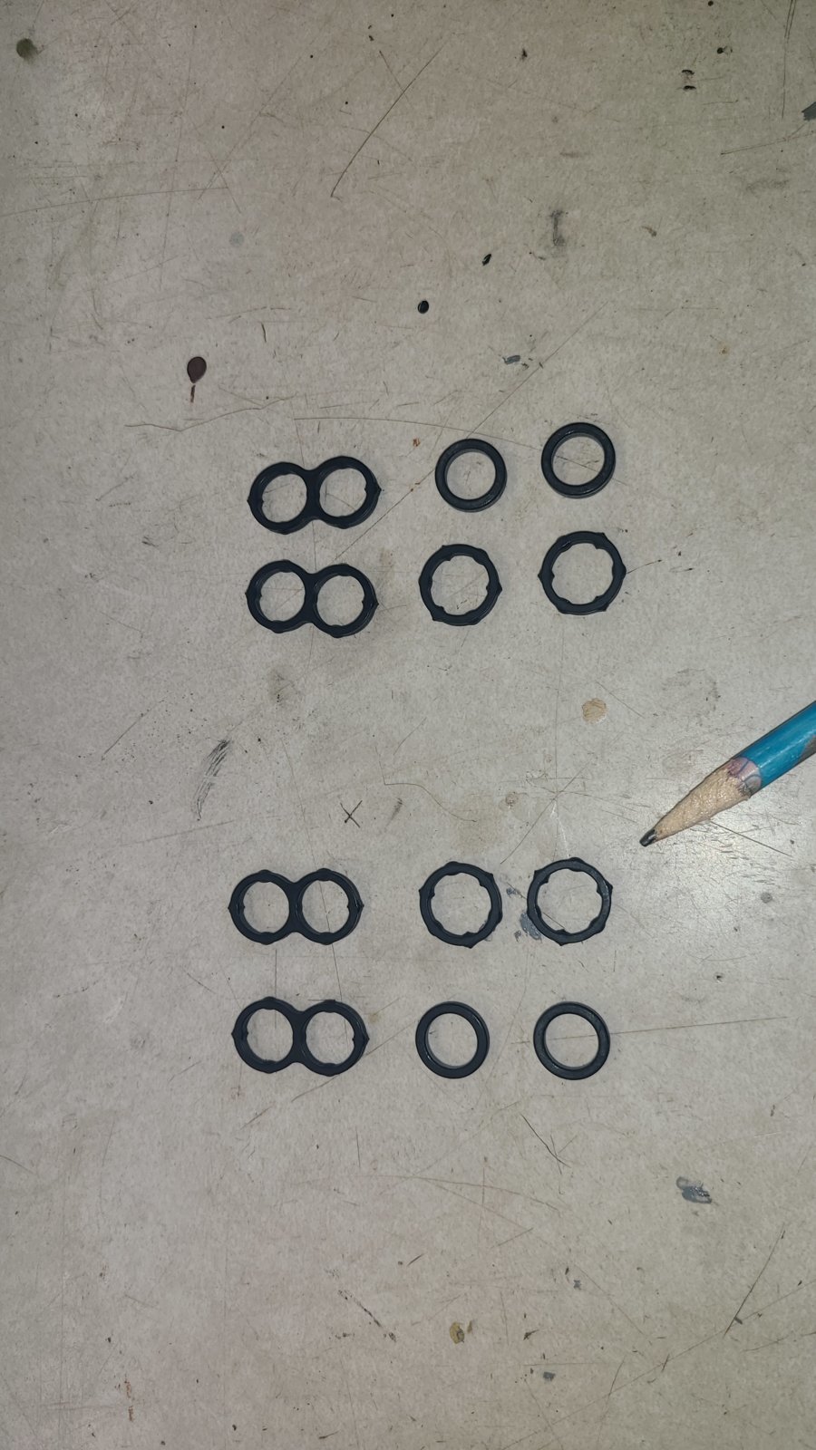

    So today my adventure continues.... I have another oil seal that I cannot find the location for.
    it is in the picture with the pencil pointing to it. There is one extra for each side. I have traced out the concept and I see a place for two of the figure-8s, one large and two small on each head. Any idea where the two additional o-rings go?
    Note: I have the two for the oil filter...

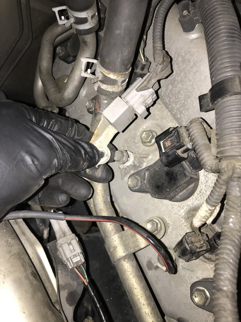

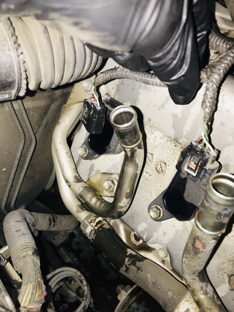

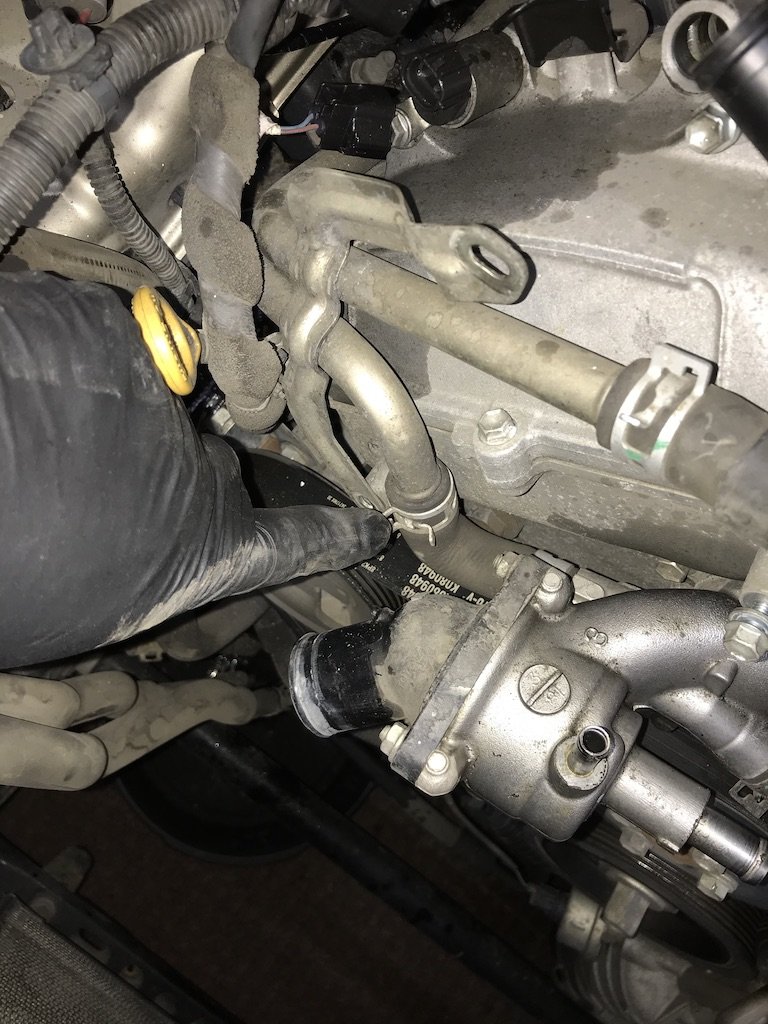

    I am absolutely crushed... Things were going back together really well and when filling up with water, it started running down the back of the motor. It appears to be across the top of the valley too. That heat exchanger pipe seal must not have sealed correctly is my best guess. I am going to slowly dig back into it. Can I access the heat exchanger from the top without pulling the entire case apart again?
  29. Jun 10, 2024 at 8:20 PM
    #149
    sixweeds
    sixweeds New Member
    Jan 22, 2020
    #41595
    65
    Trace
    2007 Toyota Tundra GoldRush

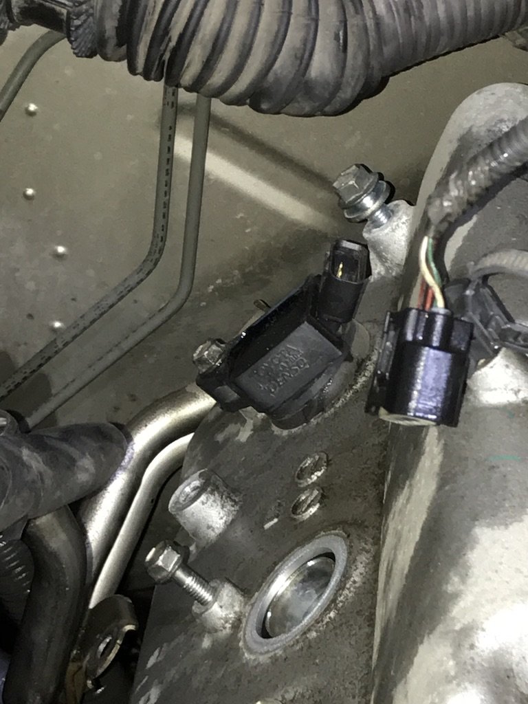

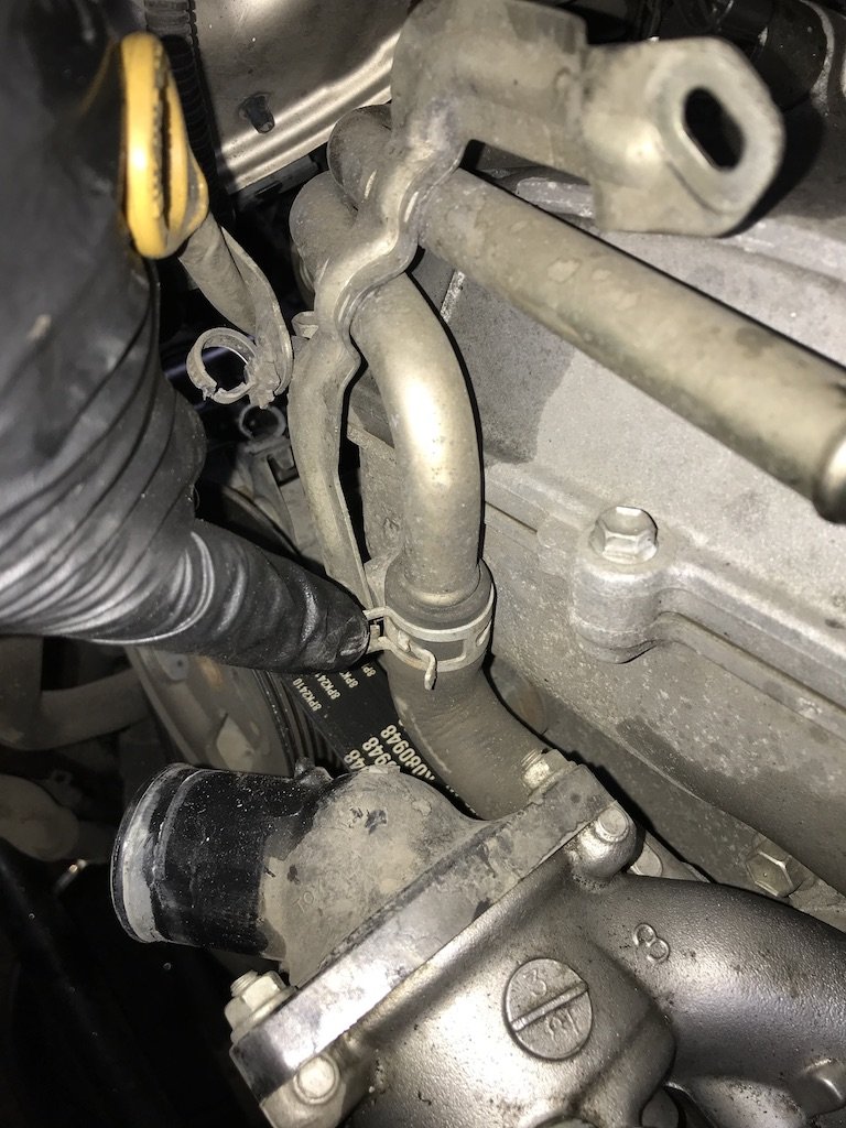

    Boy, that's too bad. I really don't know the answer to your question. This may sound dumb, but do you have a factory service manual or similar (Haynes/Chiltons)? I had to refer to mine a few times. And did you take pictures. There's no way I could have done this job without a factory service manual, pictures I took as I removed each and every single piece, and YouTube. It took me a couple of weeks working on it a few hours a day after work. I reassembled in reverse order of pics I took and downloaded to my Mac. Anyone else got any ideas?
    Is this the heat exchanger pipe. I took everything off to get to the cover, but couldn't name what the parts were. I did not remove this pipe from the back of the engine. Just moved it out of the way. Not sure if this is what you're referencing.
