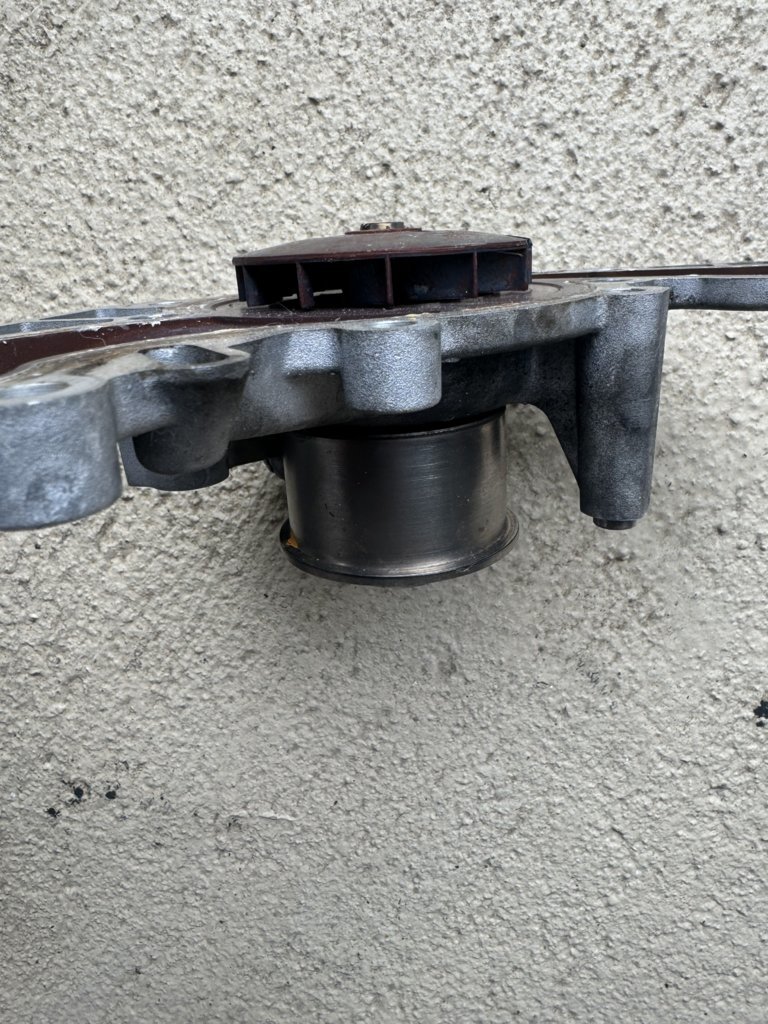

Timing belt tensioner pulley does not "pivot nice & freely"
Discussion in '1st Gen Tundras (2000-2006)' started by Weagle, Sep 16, 2024.
  1. Sep 16, 2024 at 10:24 AM
    #31
    Weagle
    Weagle [OP] I survived my timing belt change
    Sep 24, 2023
    #104402
    1,074
    Prattville, AL
    2006 Tundra SR5 DC 4.7 2WD LSD towing pkg
    Bilstein 5100's with 2883's - close to 2" Replacing the 2883's and going back to the bottom perch ASAP -mobile/apple play stereo with sub and backup cam -Power stop HD front calipers and rotors for towing -20" wheels with 32" tires (305/50's) Toyo AT 3's with no rubbing -Westin nerf bars -Detroit axle new (not rebuilt) steering rack with poly bushings, inner and outer TRE's -Suspension Maxx extended front sway bar links -Overland tuning - medium level -Power front leather seats and steering wheel from 06 Sequoia -fully de-chromed/blacked out trim -all light housings incl 3rd brake light and tag lights replaced with smoked lenses, LED where appropriate -mini projector headlights -fully rebuilt trans and new torque converter -new complete drive shaft with spicer u-joints and carrier bearing -all LED interior lights including backlighting -new lower window seals for all 4 doors -all new hardware and clips for tailgate Next: Dirty Deeds racing exhaust with LT headers, yellow box, 12 hole DD fuel injectors, redo or replace door panels
    I would install the bracket and pulley on the new oil pump and torque it down so I would know before I went through all of that trouble to install the new pump
    if I went the route of milling the bracket down, assuming it is an extremely small difference, I would be peeling back that cover to inspect it regularly

    I did a quick check and it appears the labor is about three times as much for the oil pump as it is for the timing belt if that is any indication.
    major job, but doable. I saw at least three other people on the forum that have done it.

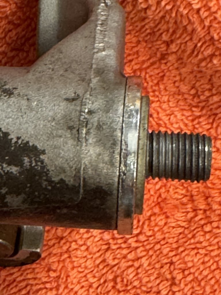

    yes, I looked into it a good bit and they have tech-support there to tell you what type and options, etc. etc.
    And if it comes down to that or an oil pump, I'm definitely doing the time cert first. And that will work, assuming it is installed properly
    Just for shits and giggles I installed the bracket with the thinnest washer I could get with a hole diameter that would accept the bolt. it pivoted freely and I could not get the bracket to slide back-and-forth

    I tried the old bracket with the old bolt and washer with the same result

    I'm sure this would be met with immeasurable skepticism, but it is so very tempting to get the thinnest washer I could find with similar diameter to the Toyota spacer/washer and put between the oil pump/engine side and the existing washer as when I just tested that

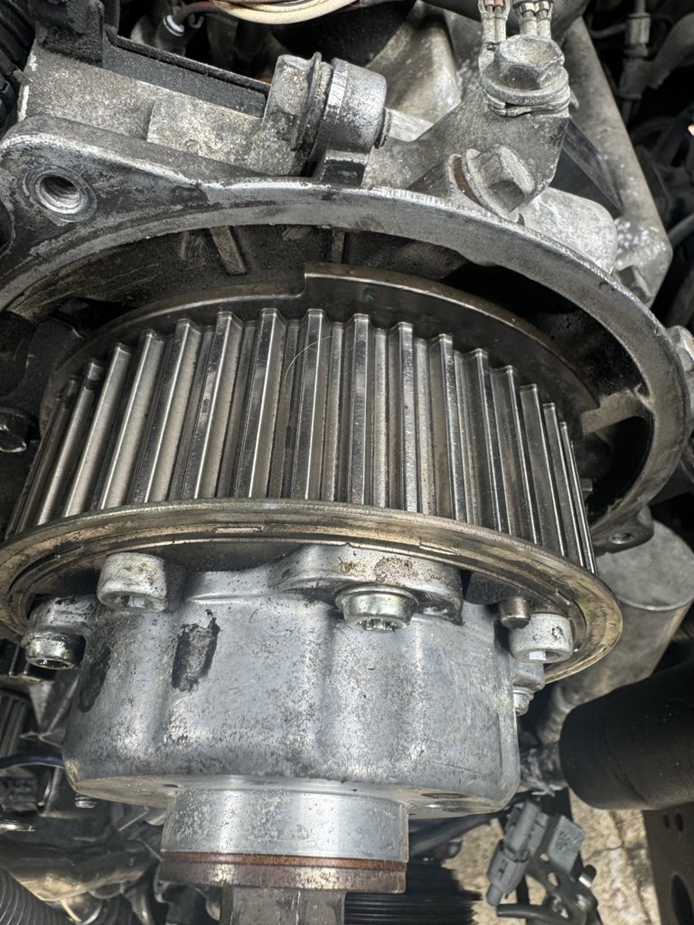

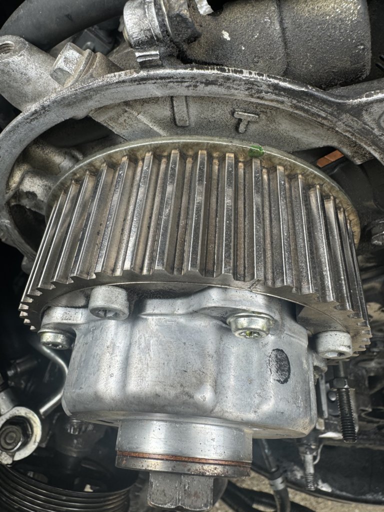

    I would peel back the passenger side cam pulley/gear tb cover to inspect. It has no flange on the passenger side and it goes there immediately after the tensioner pulley. So that should be a good indication if it is walking
    thinking this through
    Given the direction of the engine rotation, it would go from this tensioner pulley to the passenger side cam pulley which has no flange
    then it would go to the water pump and the driver side cam pulley that both have a flange to keep it in line
    then it goes around the other idler pulley and the crank neither of which have a flange
    that seems like it would be enough to keep it from walking But it would be even better if the pulleys immediately before and after the tensioner pulley both had flanges

    From the tensioner pulley to the passenger cam pulley/gear without a flange
    To the water pump pulley with a flange
    To the driver side cam pulley/gear with a flange

    Would have to inspect that at the top passenger side timing belt cover as well
    I would be tempted to get another passenger side TB cover from the local Toyota truck junkyard. Drill 2 inspection holes in the cover - one to inspect the edge of the belt and one to check the belt position relative to the passenger side pulley. Then cover with duct tape
    Would allow for quick inspection until I do the time cert. if no walking, I would not be in a huge rush just sometime next year. If there is walking, it would be very apparent at the passenger side cam gear/pulley
    this would allow me to finish testing the ECU mods, headers, etc and resolve the front passenger side suspension squeak at very low speeds after I let my shop deal with adjusting the coil overs

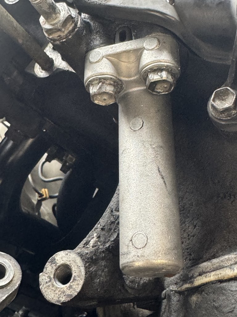

    I know you were dying to see my TB tensioner
    shifty`[QUOTED] and KNABORES like this.

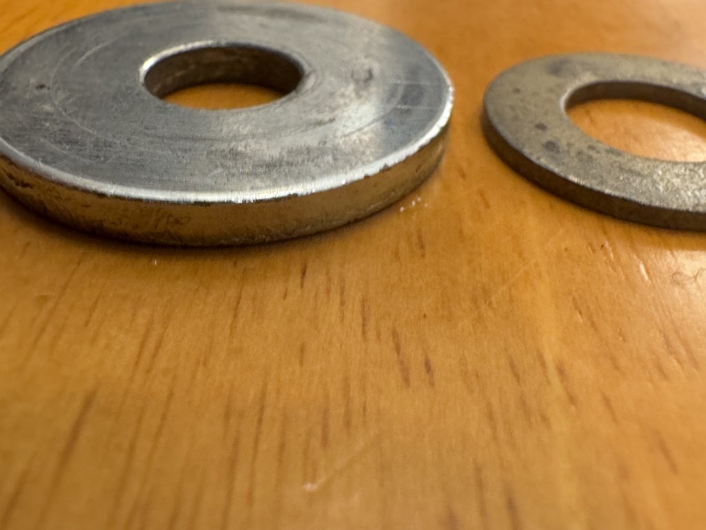

    That's what I would do. But use a stainless steel washer, it will be about half the thickness of that washer in the pic. What size does it need to be? (What's the size of the threaded portion and the sleeve portion of the pivot bolt?)
    Weagle[QUOTED][OP] likes this.

    Excellent point. True, it's not ideal. But I think we're well beyond ideal. I'd put a light coat of grease on the washer and call it good.

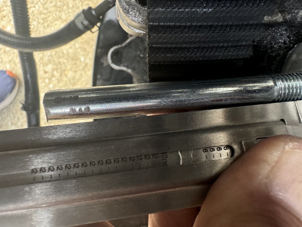

    Well, I was all ready to go the washer route and do the timesert later if needed. Even had the timing belt back on and was ready to torque down the harmonic balancer/damper.
    But I had a hard time going to sleep last night. All I could think about was how would I feel when I want to test out those headers or pass someone on the interstate getting it up to 4000 rpm's or better. That timing belt tensioner pulley is roughly the size of the crank gear so it would be spinning roughly 67 times per second at 4000 RPMs. Would I trust it? Hell no
    then I also remembered this:

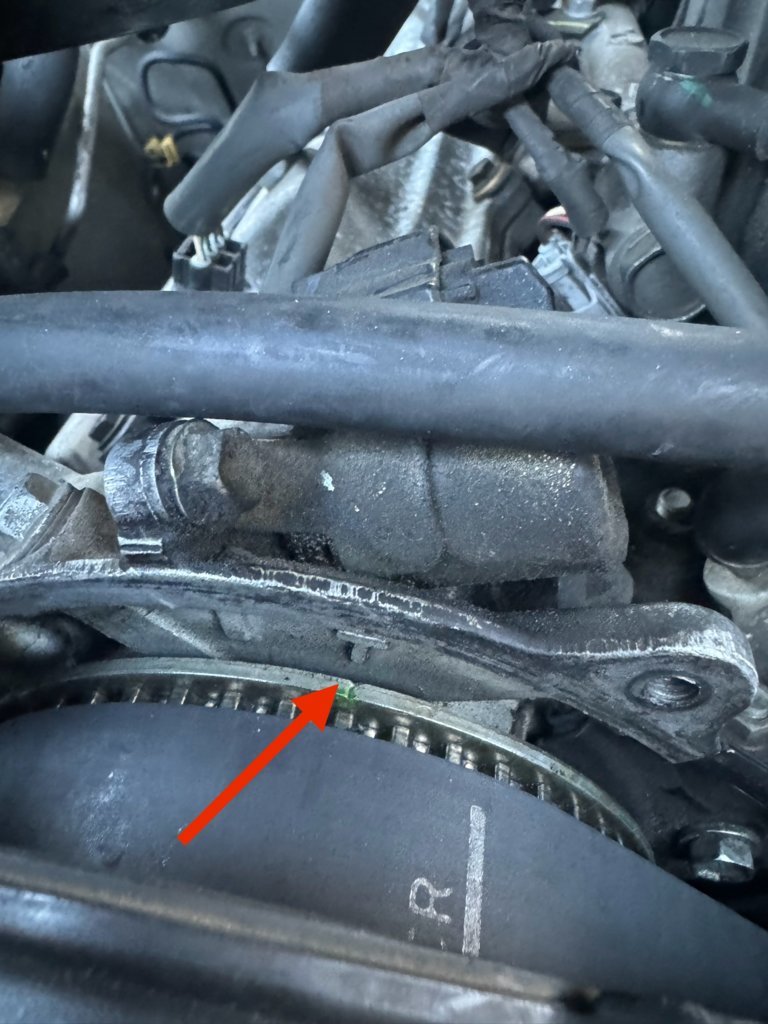

    At first, I thought it was due to that sleeve/spacer getting between one of the gears or pulleys. But I knew I had to confirm if that bolt for the bracket was perpendicular and caused It to walk on the passenger side gear/pulley which is next on route after the tensioner pulley
    Granted the timing belt would take several crank/pulley revolutions to make one complete circle, but still. If that timing belt tensioner was not exactly perpendicular and the belt ever got up on one of the flanges for the water pump or driver's side cam gear/pulley at those RPMs, it's toast
    so I just took the tb off and got a bolt and cut off the head and tried to test to see if it was perpendicular. The space is tight and you don't have Much space at the base to test. But still, this is what I saw:
    Now that tool I used to measure Was not touching the unthreaded portion at the base. It was up against the threads. So there is a small gap at the base, but there is no doubt that gap gets larger at the opposite end.
    And coincidentally at that angle, it perfectly explains why the belt had walked at the passenger side timing belt gear or pulley
    So as usual, I'm very long-winded to say, I'll be in touch with the time sert people today

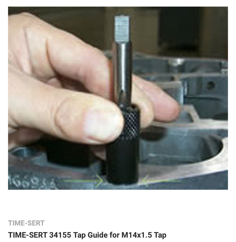

    One more concern even with a time sert there's not much room at the base of that bolt for a guide.
    Since you can't use a table drill it is going to be difficult to ensure the time sert is perpendicular. Hopefully the time sert people will be able to offer the best possible solution
    EDIT: well, here you go. This is their guide and it will work in the tight area. The bolt for the tensioner bracket is 10x1.25
    and before I hear from PHM saying my hands are made for radio, those are not my hands

    are you putting the spacer on? I assume it's got a spacer like the 4.7.
    Mine was because the bolt hole was stripped and it got tapped to try to repair with a Heli coil, but in that process the hole was not bored out perfectly perpendicular
    That clearance is very tight and it doesn't take much to bind
  27. Feb 3, 2025 at 12:32 PM
    #57
    JakeCN22
    JakeCN22 New Member
    Feb 3, 2025
    #129798
    3
    Jake
    2012 Black Tundra
    Yes I'm using the old bolt with the spacer, tried the old bracket and still wont pivot. The bolt seems short and with torque it pinches the bracket.

    When I pushed the bolt through the bracket, I could feel with my fingernail to see that it was ever so slightly longer than the bracket. Yours should be the same and I believe you've tried both the old and the new so I doubt this is an issue
    if you push on the bracket slightly at different angles while torqued down, does the bracket then start to move freely? There's not much clearance so it doesn't take very much to cause it to bind. This was the case with mine, but my hole had been tapped out and wasn't perfectly perpendicular. Not sure how yours would've ended up that way.
    you could put a very, very thin spacer between the existing spacer and the oil pump housing and it will probably move freely

    I ended up taking a measurement with my calipers of the width of the bracket, and the width of the gap between the spacer and bolt head and I had .030 difference. I ended up just milling about .015 off of each side of the bracket and torquing and it pivots nice and freely, but didn't have any slop or play. I think it will be fine. Before I could tell the bolt shoulder did not go all the way through the bracket so it was in fact pinching it. Thank you for your responses.
