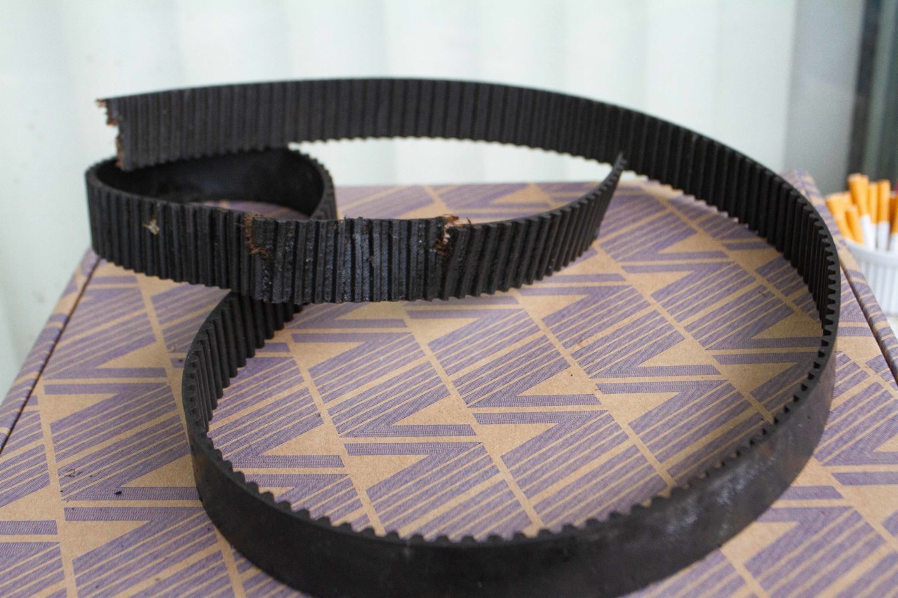

    This was the result of a leaky water pump for me. Got lucky, it broke on start up, no engine damage. If I was hurtling down the highway, it would have been game over. Put the OEM belt/pump in asap.Timing Belt Shots-2.jpg

    Your situation was different than mine. Didn't you say you were adding a lot of coolant? I'm adding maybe 2-3oz once or twice a year. The drop in coolant is barely noticeable.

    Started out very slow then escalated quickly. Toyota notes that the coolant is corrosive to the rubber in the timing belt. Just concerned for you. Best of luck!

    My belt snapped after owning the truck for a few weeks. My fault for being ignorant and not inspecting it before/after purchase. Engine was fine putting a new one on and I was good to go without issues. Granted it snapped while traveling less than 5mph through a drive through goodwill drop off.
    Edit:
    Vehicle was over 286k miles when I bought it. I don't know how many miles the belt had. I can't remember why some reason I was thinking ~90k. However the broken belt was not OEM it was a Gates belt. I used the Aisin kit for the swap.
