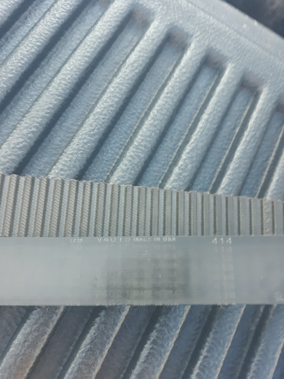

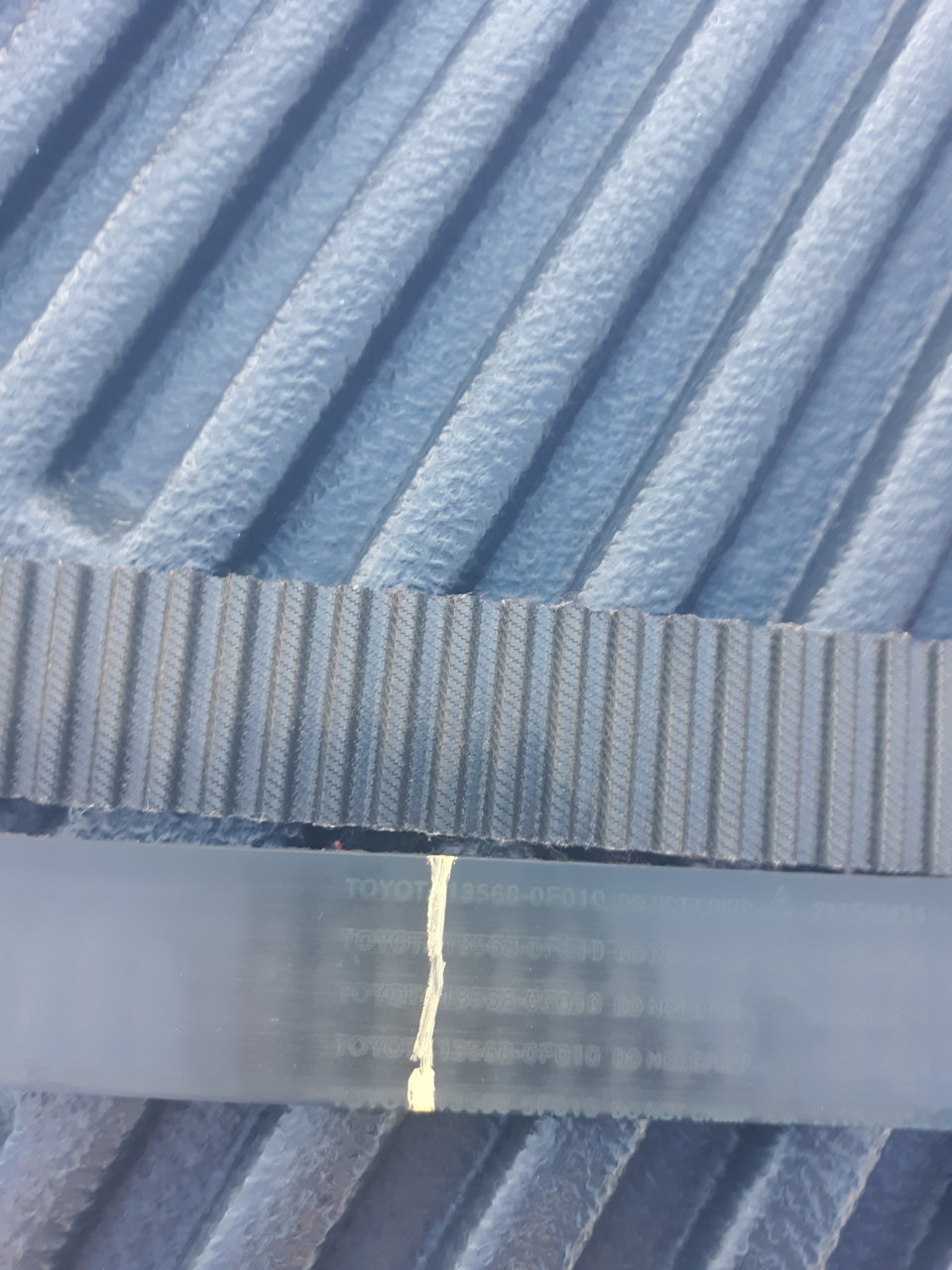

    First of all, I'm going to say replace it.... Now that I've got that out the way, I was on my original TB on my 2004 4.7L until YESTERDAY at 195,1xx miles. It didn't snap, but I got it replaced along with water pump and tensioner because after planning to trade it in, I finally decided to keep it. Here's a couple photos of this 18 year old TB with over 195K miles on it... Don't yall yell at me too much.

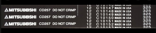

    Did you own the truck its whole life?
    Only asking because that looks like a Mitsubishi timing belt, not an OEM Denso timing belt. If it were the the case, your words could give people false hope theirs could last for almost 200k miles also, and it's "OK". We know it's remotely possible for one to last that long, but ...

    Now you've got me confused, because I got it in 2005 with 14K miles on it. Was never mentioned that a TB replacement was done on a one year old truck The biggest job I've had on it since then was axle shaft bearing.

    Not only that, but it looks really good for a belt that old. It doesn't even look cracked.

    Sometimes the cracks in the rubber won't show until you zoom in while flexing the belt.
    That belt definitely has a good 80-100k miles on it. It's also possible Mitsubishi was making Denso belts back then, or Denso makes Mitsubishi belts today, or they share a manufacturer (dunno which). I haven't seen a 15-20 year old Denso belt, but I recognized the writing on that one as a Mitsu belt. Took me a few minutes to sanity check it on Google Images.

    Could be but we've had other members post pictures of their old belts and it was immediately clear it was past its normal lifespan.

    I had to go out and look at that old belt again, because I was wondering why a barely year old truck at 14K miles would have a TB replaced

    Looks original to me.
    that said I’ve seen belts that look good, fail. That’s why I’ve replaced 3 of these 4.7s at work.

    Well, I'll do a visual check on mine, but that one looks pretty good.
    Seeing as my V6 is a non-interference engine, I'm gonna let it go.

    Huh. Maybe they do share a manufacturer. Or I guess it's possible Mitsu is/was making it for Toyota back then, and re-branding.
