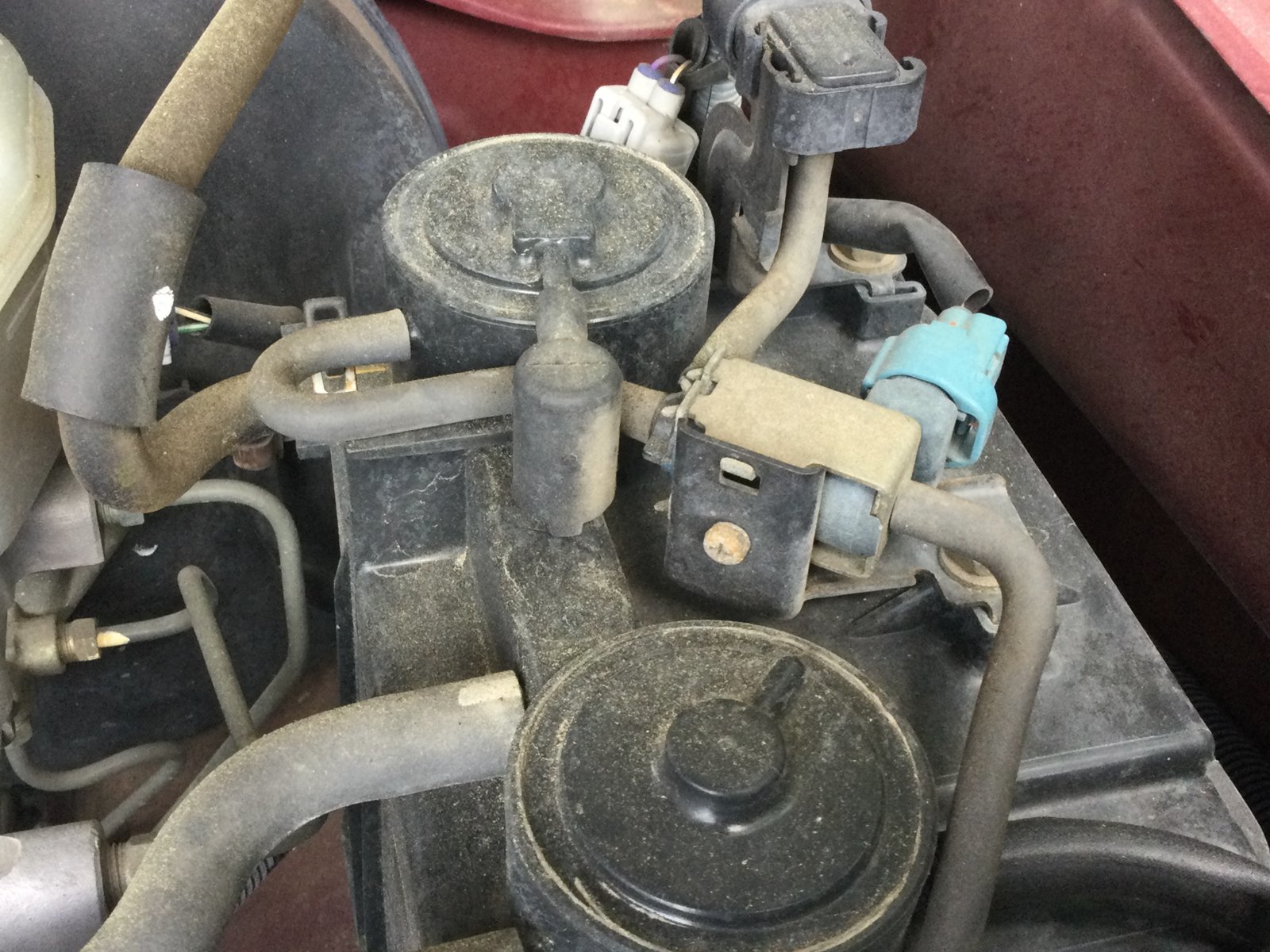

    Could you by any chance take a picture of what this vacuum line that's below and next to the dipstick is? This was the one I was talking about when I said this line is the one of concern. My girlfriend took some pictures and said it's attached at both ends, but from the looks of it, it isn't.

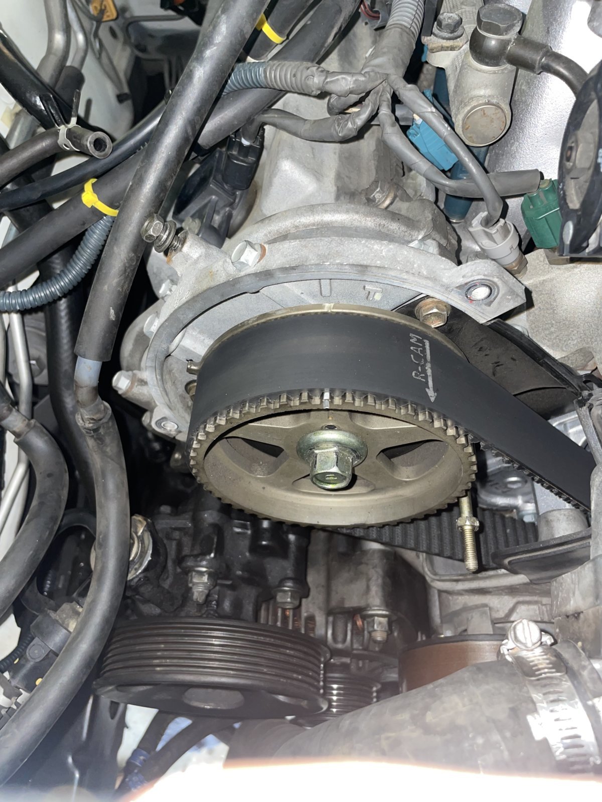

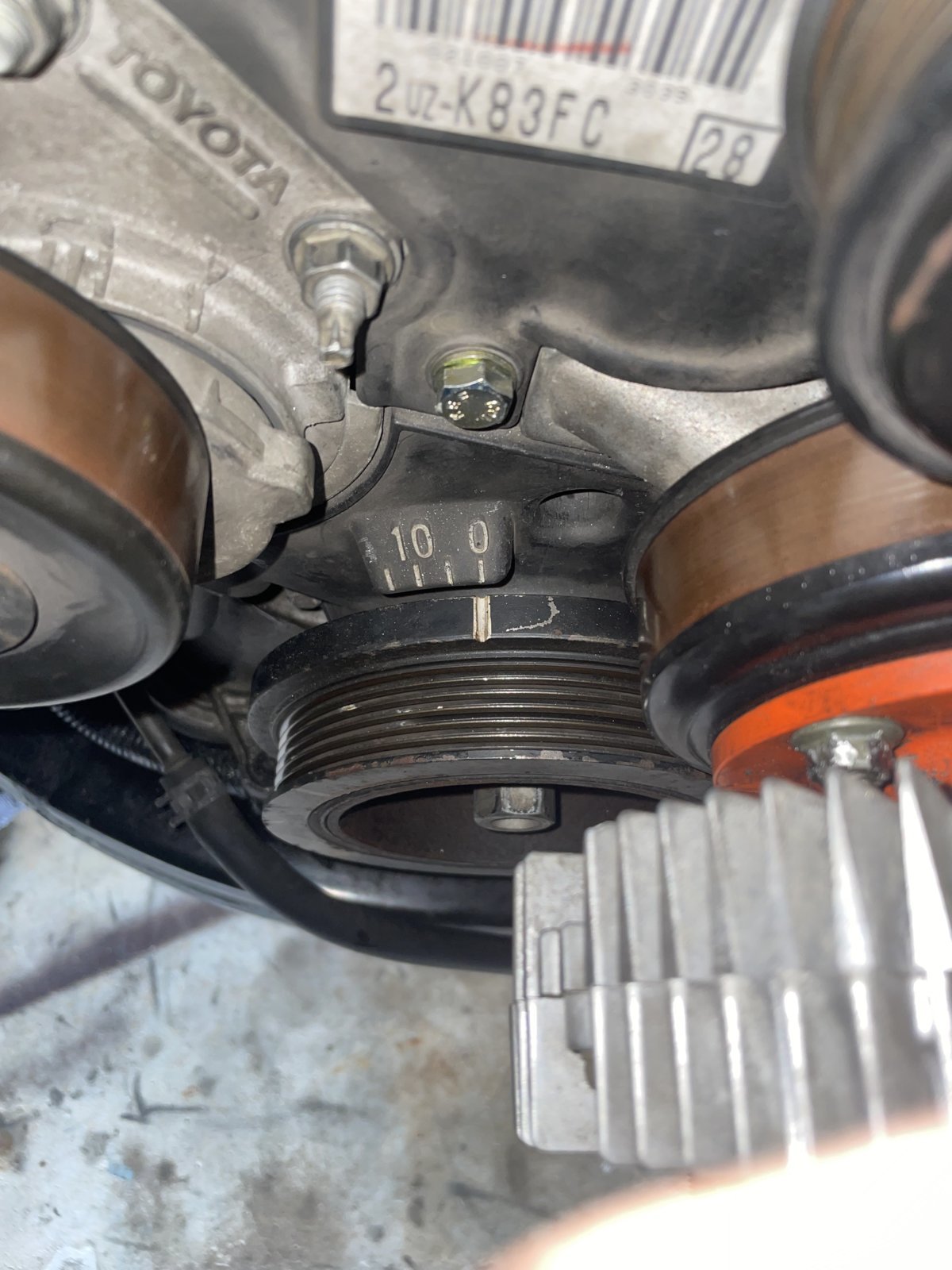

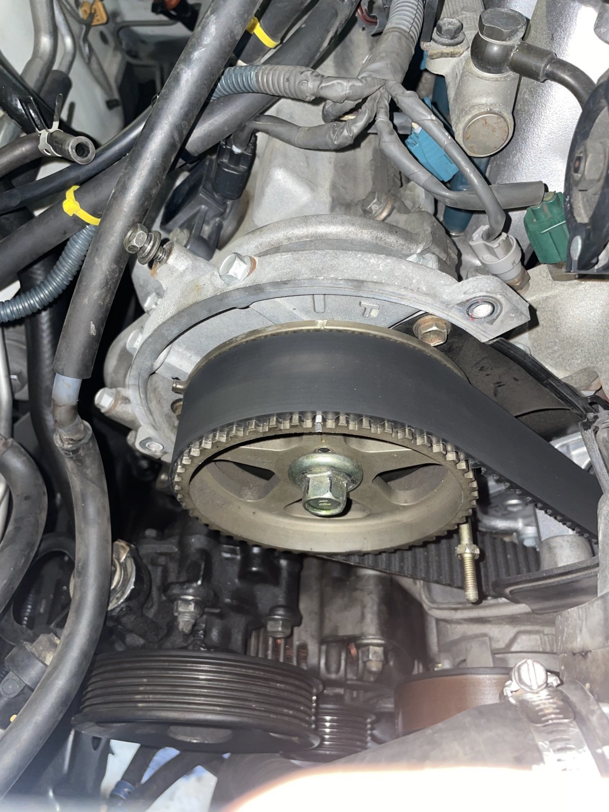

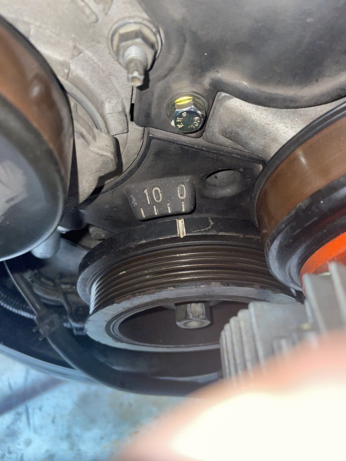

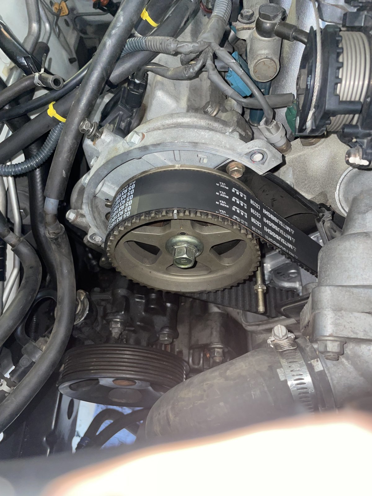

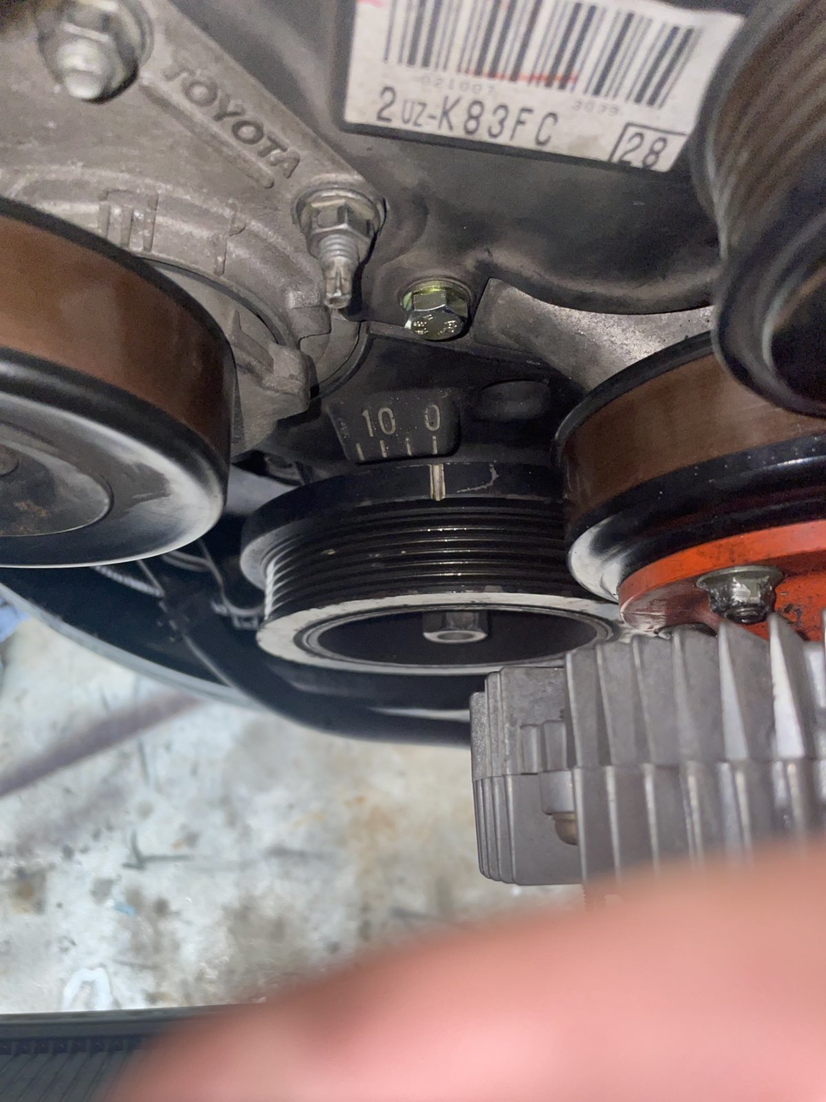

    Okay, just took it apart and this is the verdict:
    First revolution which wasn’t a full rotation:
    Second Pass which was a full 720 rotation of the crank:
    Third pass, 720 crank rotation again because I couldn’t believe my fucking eyes:
    So, again correct me if I’m wrong, but Im in perfect time! Actually really happy I don’t have to take the engine apart again.
    I noticed that when I was taking the covers off that the cam sensor wasn’t locked in place, so that may be the culprit. Regardless, probably going to go around the engine and recheck everything tomorrow. I need a break from engine shenanigans and a family friend is coming to help me diagnose things Friday.

    Looks like it is timed correctly! Whew.

    Yeah I was preparing myself for the worst, but so happy it’s nothing serious! Now it’s diagnosing the current problem.
    Luckily I don’t have to worry about damaging the valves, so once I install my outer tire rods I’ll give it a test drive and hope it’s the ECU fixes it. I got some hoses to probably replace or maybe even the MAF sensor. Pretty sure most of the vacuum lines are still from stock 24 years ago, same with the MAF.

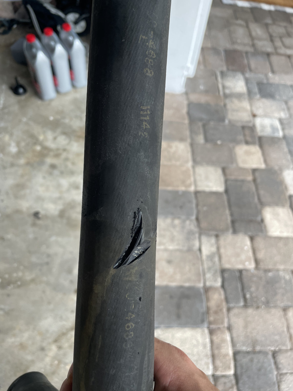

    Unfortunately reviving this thread for a different issue. Water pump is most likely leaking. It must’ve started when I took it on the highway to go to dinner, because when I came out after dinner there was a gushing puddle underneath the truck with drip looking like it was coming from one of the main radiator hoses. I said no biggie, topped it off with some water and drove home.
    I came home, popped open the engine bay, and there was dried up coolant all over the place with no issues with the hoses as I could see whatsoever. I thought the leak was coming from the bottom hose, but it looks like it’s coming from behind the power steering motor and just dripped down. Regardless, coolant was all over the place, front and back of the engine and all over the cross member.
    I Checked the thermostat since I thought that’d be the culprit because I used gasket maker and not the recommended, but that was bone dry.
    Truck barely leaks when it’s off, and is pissing bad when it’s on. I checked the torque on the bolts three times before I threw everything back on so I’m unpleasantly surprised.
    I haven’t found the source of the leak, so I’m going to give it a look over after work and hope it’s just a cracked or slipped hose, but it just sounds like the water pump from what I’ve read. I don’t think the seal would shift or cause a leak due to higher speeds and would’ve just started leaking after install with pressure on. If it was the seal though, it must’ve been faulty for not leaking until now.
    Hopefully it is just a loose hose, but if it isn’t, I’m Gonna have to buy more seals and O-rings. Getting a pressure tester loaner kit and I’ll upload some pics tomorrow ): hoping for the best!

    Got the loaner pressure tester kit from autozone and diagnosed the problem in 5 minutes. Big ass hole in the thermostat hose that plugs into the radiator. I must’ve put the hose on backwards because it was rubbing against the one of the pulleys.
    Easy repair. Just gotta flush the coolant since probably 80% of it is water. Hopefully no more leaks after that.
