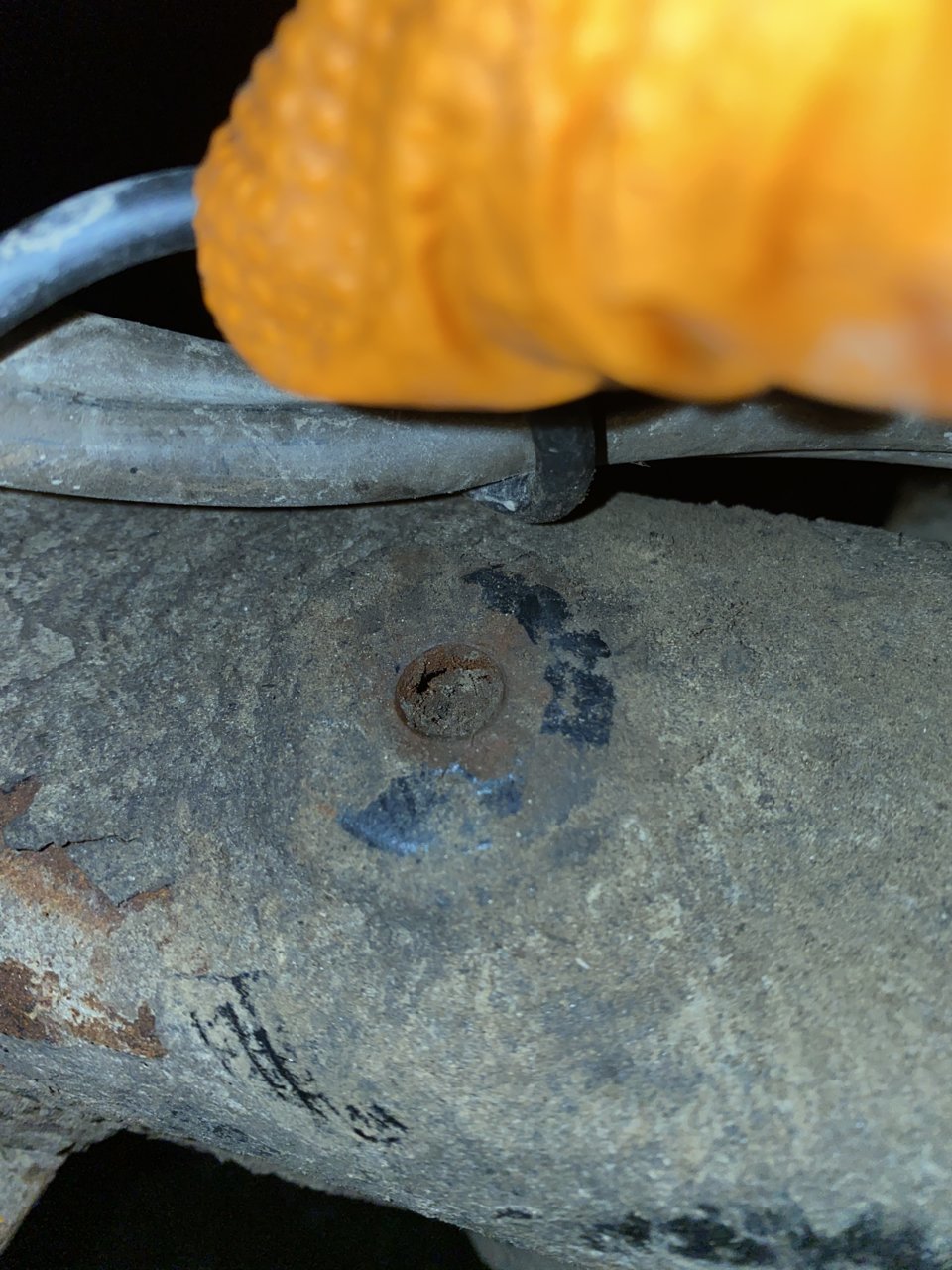

    Um, this is my breather
    Took a few months but I feel like I’m finally getting to know this truck, sigh…

    Man, it’s an old truck. Clean it up with a needle scaler and rattle can it. That leak probably isn’t from the housing. Good thing about the needle scaler is you’ll find out quick if the metal is thin.
    I doubt you need a locker. If so, I’d stay away from the factory lockers. Way too problematic.
    I like using gaskets on diffs, but FIPG works just fine.

    Change fluid, replace breather, clean up leak as best as possible, get rid of any loose metal, then paint it and see if your leak persists. May just be pushing past a seal due to no breather for pressure differential. May be difficult to get the rest of that breather out without getting any pieces in the axle though.
