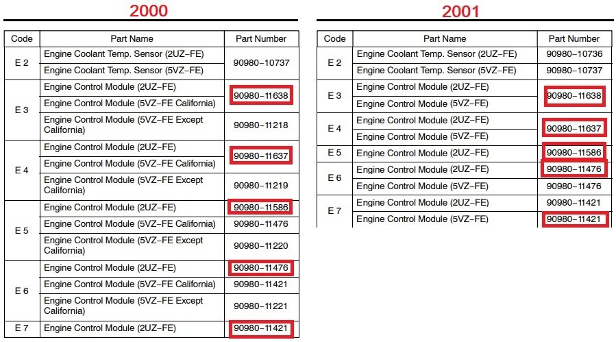

    Some Googling confirms that number I think I'm seeing there is legit for a 2uz-fe w/4x4:

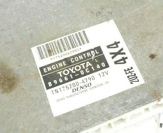

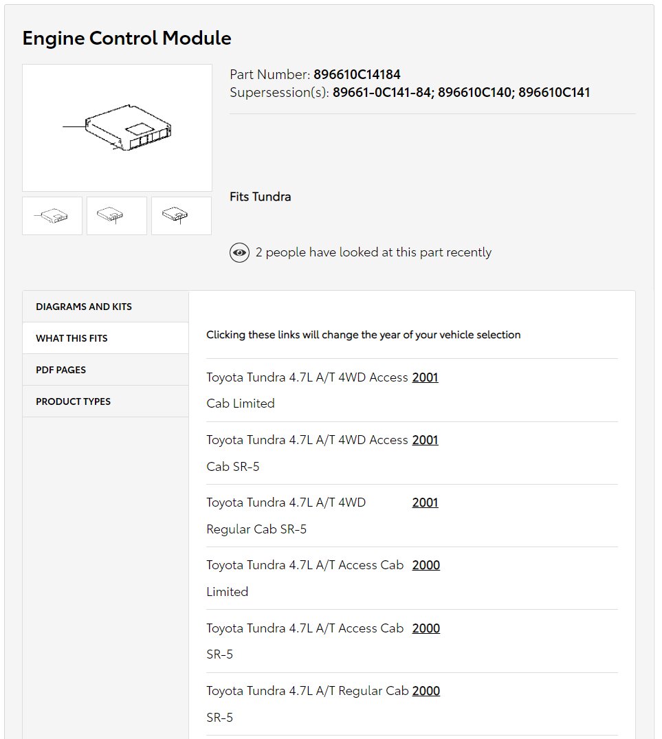

    Last post on it. Not saying Noah's won't fit, and could still be a good option.
    This is what Toyota is showing for fitment the part number I think you may have. Sucks it got wiped off. I think your truck may be 1st in the list.

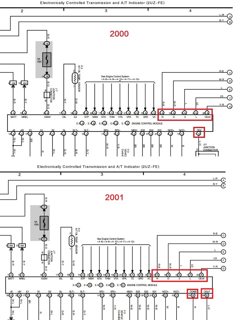

    According to the Electrical Wiring Diagram(EWD), the 00 and 01 did use the same part # connectors. However, there are some differences in pin number/functions(a few noted in red below). Whether that's a clear indication that @Tundra2 ECM will work or not work, I personally can not say emphatically but it's not looking good IMHO.

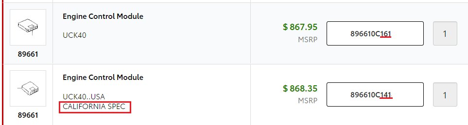

    From what I've seen most Toyota part numbers have a logical format. Like, using this example: 89661-0C161
    The 1st five numbers "89661" is the part category, like "electrical", "body", etc.
    The 2nd five numbers "0C161" is used to define feature variations.​
    What do I mean by "feature variations"? An example, when I was doing my wood grain upgrade...
    84013-0C010 => Matte black dash center piece (with 3 climate control knobs, with 4WD buttons)
    84013-0C310 => Wood grain dash center piece (with 3 climate control knobs, with 4WD buttons)
    84013-0C350 => Wood grain dash center piece (with 3 climate control knobs, with 4WD buttons with the extra VSC button)​
    Using that same logic, the difference between the two could be something relatively simple and chassis-only, like ....
    89661-0C161 => ECU for 2UZ/4WD regular cab, with tow pkg
    89661-0C141 => ECU for 2UZ/4WD access cab, without tow pkg
    The regular cab and access cab main differences would be small, like, roof wiring for example. In which case, the truck is going to start up, drivetrain is going to work fine, but you may see something stupid, like maybe the rear door-ajar switch doesn't work, or you gain/lack tow package lighting. (edit: these are bad examples, not sure ECU would have any say in those)
    However,
    it's also possible it's something more significant, like...
    89661-0C161 => 2UZ/4WD without VSC equipped with automatic transmission type B
    89661-0C141 => 2UZ/4WD with VSC and equipped with automatic transmission type A​
    In which case, your truck will probably start up, assuming both transmissions types used the same neutral safety switch setup (maybe?), but if your truck had VSC traction control, that may not work correctly, or the shift points may be slightly different if the auto trans types didn't match.
    It's my opinion, and just my opinion, but I genuinely believe buying Noah's part is a cheap, valid way to test startup based on seeing your current ECU's PCB rot.
    I think @BubbaW understands more about the vehicle chassis option details than me. Somewhere out there, someone has technical chassis type details for each part. Maybe some parts database has details for each part somewhere, like this? (these numbers are only an example, not reality)
    89661-0C161 => 2UZFE; UCK40L-ARSLKA
    89661-0C141 => 2UZFE; UCK30L-ARSLKA​
