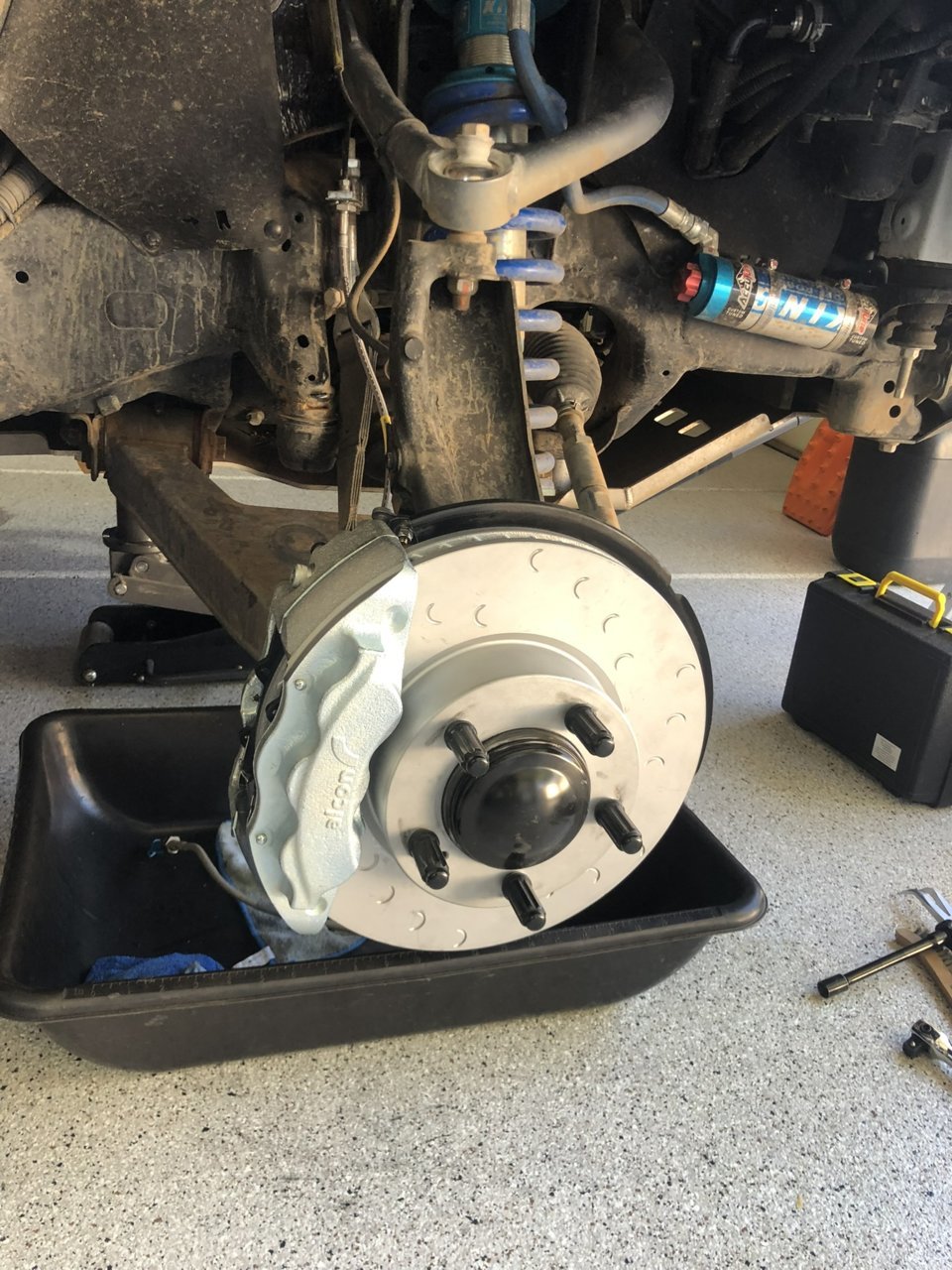

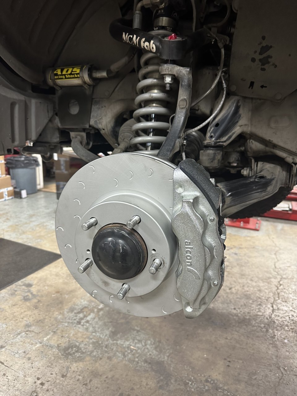

    No more fuckin’ around with brakes! Got my Alcon BBK put on yesterday. After a good bedding process, this thing is ridiculous when you hit the binders. Braking is off the charts.
    D1FDDD8C-9DF8-477D-9B14-185D53D7986E.jpg F2757FB1-43AD-479D-BE11-5595F5790477.jpg
    Thanks to Rey for the advice and help spending my money. Also put longer wheel studs all the way around, and replace the Uni-Balls in my UCAs with Delta Joints via MCM. Realignment of the front end afterward, with about 5° of caster to help make more room for the taller tires in a few months…
    Don’t judge me, I’m not good at washing my shocks…

    Hell yes!!!! Aren’t they absolutely ridiculous lol the stopping doesn’t even make sense with how big these rigs are.

    It’s crazy. I haven’t even tried an aggressive panic stop yet. Just got them bedded and want to give them several good heat cycles before I hammer on them.
    Guessing I’ll want to have my seatbelt on. I had no idea that brakes could be like this…

    Let me know what you think when you really crank on them. I know! It’s really hard to describe the power and feeling. Congrats I’m siked for you
