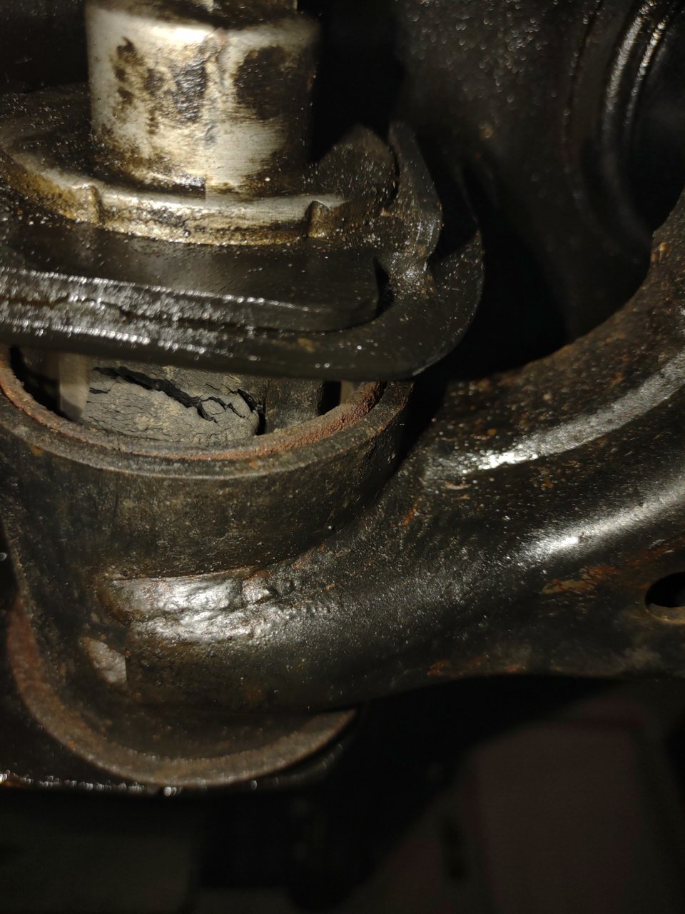

    As far as I know, my arms are original at 181k miles. After looking at the bushings this week, they are worse than I thought.
    When I rebuilt the front in 2019 these were the only parts I didn't replace.
    It sounds like there are only a few good options.
    • OEM @ $240 each-$480 total
    • Napa @ 175 each- $350 total
    • Solo- $1,130 can't imagine why I need these but I'm sure they quality is great
    • Last option, replace just the bushings? I know some have done this. It looks like the bushings alone would be over $200 plus the labor to press them in.
    • Did anyone reuse their cam sleeve/bolts/eccentric if they weren't rusty? Very little rust on my truck. Just grease and fluid film.
    Last question, my lower ball joints are 3.5 years old with around 20k miles. Would anyone install new ones while you have it apart or should I just keep using these? I have no reason to think anything is wrong with them.

    I reused my CAM hardware by just sanding smooth any rusty ones and reapplying nickel anti-seize. I only replaced the sleeves on the back two that were rustier than most. I would invest that $200 in a 20-ton HF press with adapter accessories and replace the bushings on the original arms myself.

    I put napa arms on the silver truck 2(?) Years and the bushings according to dad are starting to crack. I havent seen it myself... I used OEM cams. I'd replace them anyways due to fatigue. That's just me. Metal can only be stressed so much.

    Seems like cracking and failing bushings is common for non-OEM, regardless how "quality" the brand is. I'd just go OEM.

    If the arms aren't super rusty, replace the bushings. If the LBJs are 3yr old genuine Toyota parts, leave em alone if no play is present. Reuse the hardware if you can.

    Are those bushings supposed to crack maybe?

    I was wondering that too. Or maybe not supposed to but very common. They are cracked on the RAV4 too.
    I really don't want to replace mine but they are almost 21 years old.

    And we have no idea how much longer OEM will be available either... I mean if everyone went, and looked at their bushings I'd bet even low mileage trucks like @shifty` s truck has crackie bushings.
    I mean think about how often, and how much those bushings flex. Literally all the time with the full weight of everything

    If anything, I'd expect low-mile like mine to be cracked. Rubber dries out with lack of use. When you actually use it, drive in rain, you kick up oil and other things off the road, and it helps keep rubber pliable.
    I've said it too many times on here: Low-mile trucks are not better trucks.

    I'm wondering if the fluid film dried out those bushings pre-maturely.
