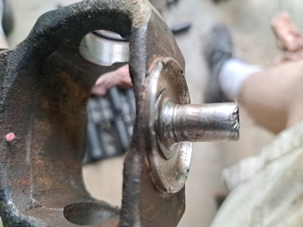

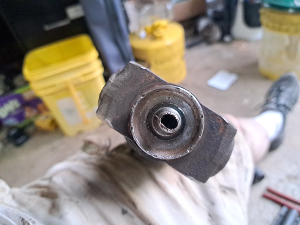

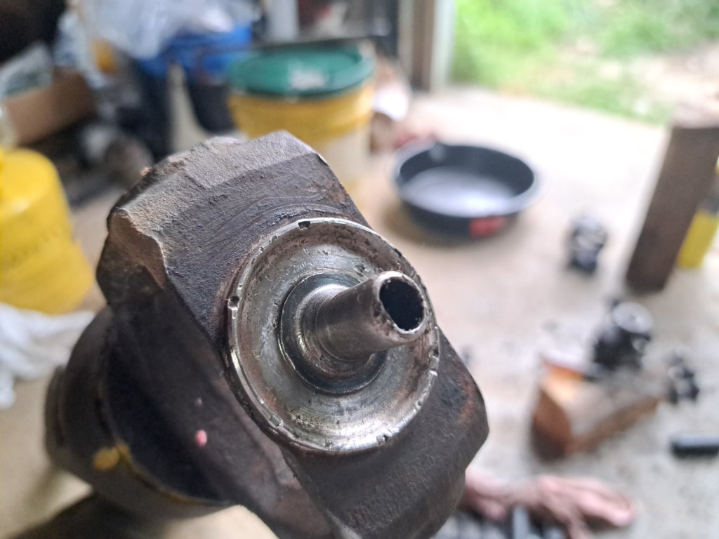

    Old cardan joint pics.
    @Mr Badwrench
    The used driveshaft I got was loose like you said earlier. It had ever so slight bit of play and made a clunk when I moved it. I put the new carrier bearing on so I snuggled it up good.

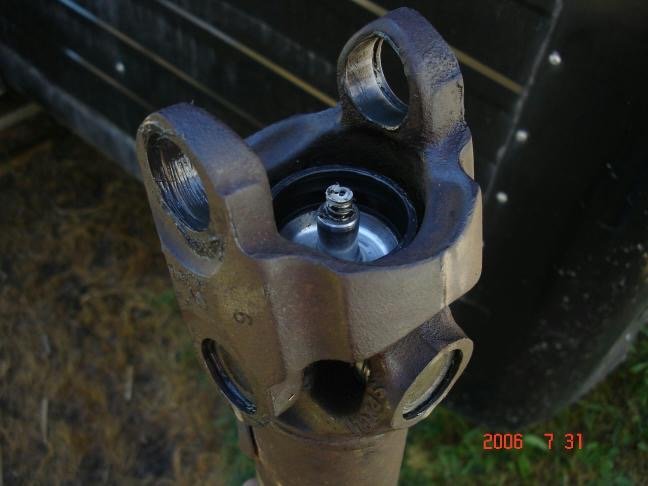

    Anyone have a photo of a good one for comparison? I have no idea what that's supposed to look like.

    That tube should be round and a little longer.

    I wonder if you buy a double card an CV head from Dana Spicer and only use the ball section and joints if it will fit.
