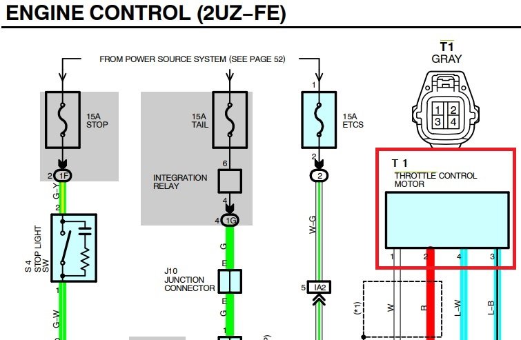

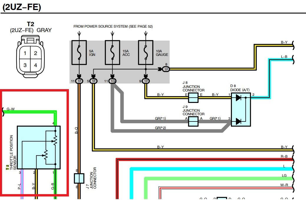

    They say picture is worth something, perhaps he/she can post pics of connectors. I mean we have access to EWD’s.
    I’ll take look at 2000 drawings until someone can post a pic….I mean we really like pics, like a lot @bmf4069
    If it's their Throttle Body plug T2, pic below should help
    pins
    1 Green-Black
    2 Black-Yellow
    3 Purple-Blue
    4 Green-White
    If Throttle Motor
    pins
    1 White
    2 Red
    3 Blue-Black
    4 Blue-White
