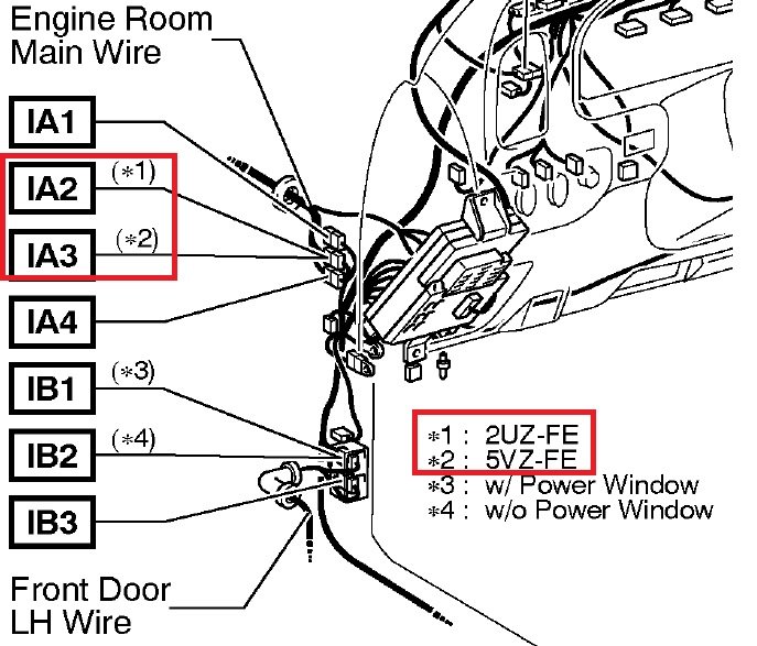

    To be more complete, P1127 is "ETCS Actuator Power Source Circuit Malfunction". Meaning the voltage to the ECM from the ETCS fuse is coming and going and is below 9-12vdc periodically.
    As you can see from pic below, batt voltage at the ETCS fuse goes to 1A2 connector to the ECM. The 1A2 connector is located at drivers kick panel area, which is a known area of problems if one has/had water penetration issues.
