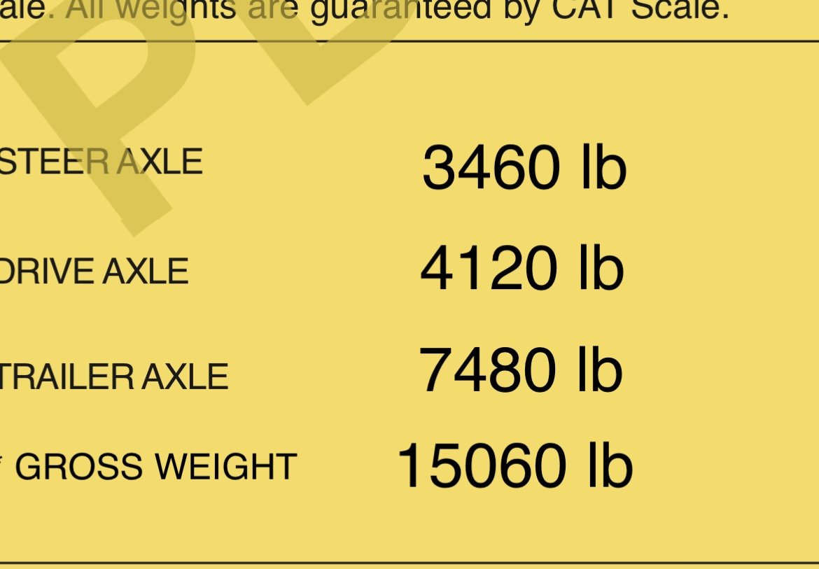

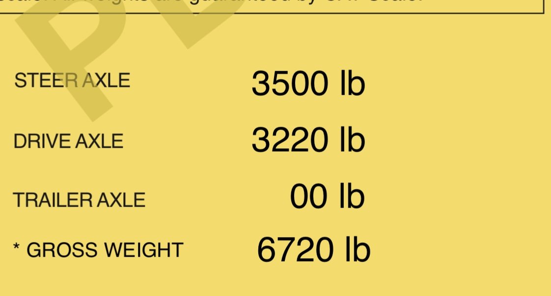

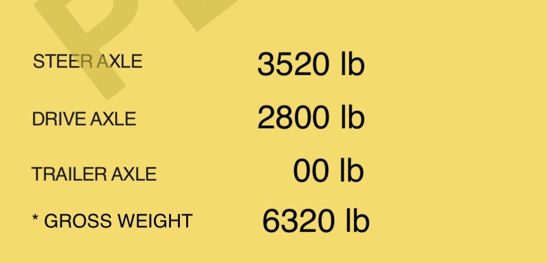

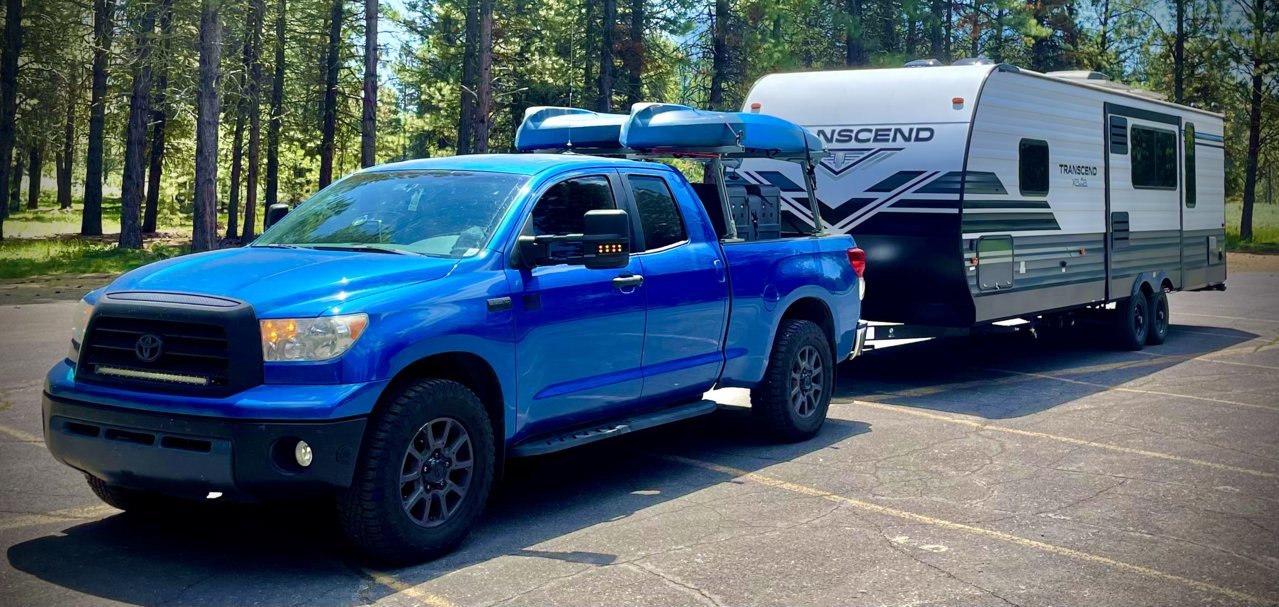

    Goodyear UltraTerrain AT 275/70/r18, Stoptech Cryo Slotted Rotors/Hawk LTS Pads, DECKED, and lots more!
    still figuring out best way to load the new rig will certainly help
    Not in my example from the first weights but I have another example for you. This was all the same trip. I know this is a 3rd gen towing question so I don’t want to intrude too much and feel free to roast me on my weights. I got a new trailer last year and this was early on in the season trying to dial weights and figure out best way to load the new rig combination. All weights are from the trip with the combo in this picture. All weights with full fuel tank
    Fully loaded
    Unloaded with all gear still in bed (kennels, rack, kayaks, dogs, generator)
    Unloaded “normal” truck only
    If my math is right, that means when I was loaded up with the trailer and gear, I had a total of:
    Weight of truck / on truck = 7580lbs
    Weight of trailer = 8340lbs
    Tongue weight of trailer
    7580 - 6720 = 860lbs
    Gear in bed = 400lbs
    Over GVWR / Payload = 480lbs
    Not over any axle ratings
    It’s easy to overload just keep that in mind. I’ve taken steps to account for it with a good hitch, airbags (doesn’t do anything for weight fyi, just nicer towing experience), E rated tires, and slotted cryo brake rotors with Hawk LTS pads. All that and I know that technically…it’s over.
    I plan to weigh the rig again this year after balancing better with the experimenting I’ve done. We will also not be bringing any kayaks or bikes, just dogs/kennels on the first trip out because I’ll be at sites with power. That should help give me even better insights. I’m not new to towing or trailers, but finding the sweet spot of balance with my new rig is a lot of trial and error. I had my 24ft trailer dialed perfect, this one I’m almost there. Tongue weight is almost a perfect at just over 10%.
    Feel free to roast me, criticize, etc. it’s how we all learn stuff and strive to do better. Hope this helps a bit!

    Kevin, It seems to me that you are very aware of the important aspects of your rig.
    I see that the front axle didn’t get much weight moved from the tongue. I wonder if the airbags are getting in the way of that? I would expect to see about 1/4 of the tongue weight moved to the front axle in a typical weight distribution application.

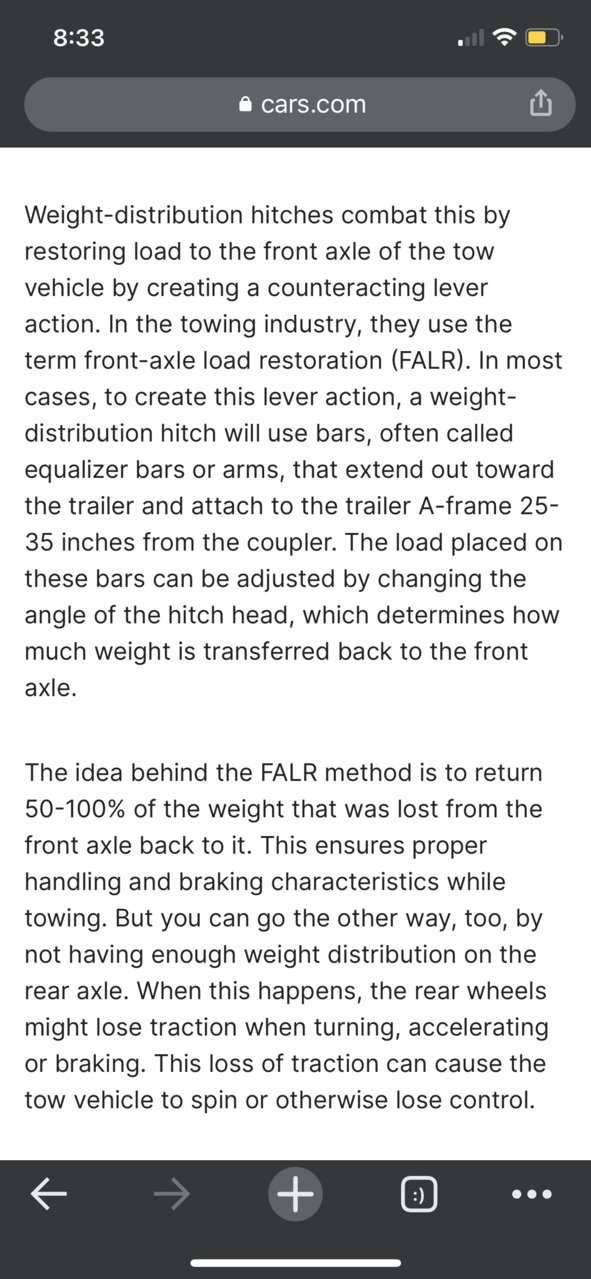

    I suppose we can agree to disagree, because the documentation of hitches and many others state the point is to get weight back onto the front axle at or slightly over unloaded weight. The idea is to get the steers back to “stock” weights. Without the bars I would be taking 500lbs+ off the steers. When I get a chance to weigh the trailer without bars that will help confirm it. That means I’m putting all of that weight back on the front steers with the hitch that I otherwise would have taken off with the trailer. The rear a axle should carry a significant part of the extra and the steers should be as close to stock as normal has always been my understanding. The bars with the bags set to 15-18psi still have TONS of tension on them. Seems near perfect to me. Here’s a perfect article from an engineer for Progress who makes the equalizer hitch describing what I’m talking about.
    https://www.cars.com/articles/half-...tribution-hitches-why-and-when-to-use-454793/

    50% weight return to the front wouldn't fly with me. As close to 100% as possible. Considering you now have to control the steering for more than twice the weight, I want all the weight on the front tires I started with, not less. On a scale I would want to see the same weight on the steer axle I started with, yours are pretty close (within 60lbs). If it tows great and handles well, you may be as close to dialed in for your rig as possible with your setup. Happy towing.
    kparrow[QUOTED] likes this.

    Absolutely. As close to 100% as possible is my goal and 50% certainly wouldn’t fly with me. I’m using my bags solely to supplement the spring rate of the leafs that are no question worn out. Bags were less expensive and quicker install for now but the goal is eventually new leafs. Will be moving my lithium batteries from the front storage to the under bed storage just behind so that should shift weight just a little bit. Will have to do lots to trial and error on the scales once spring comes around and I’m gonna get it as close to 100% as possible. Happy towing for you too.
    KNABORES[QUOTED] likes this.
