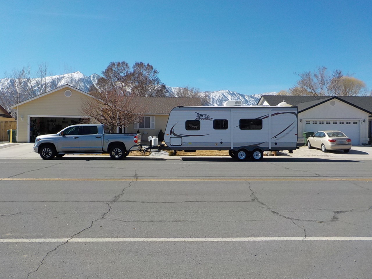

    There are a dozen of so trailer that have a 24' box size that are under 6,000 lbs dry.
    I have a Jayco Flight 240RBSW. Dry weight 5,700, and has 1,600lbs cargo cap. I bought it on sale 7 yrs ago for $20,000.
    For your information travel trailer have about a 30% markup. Take your time Looking.DSCN0965.jpg

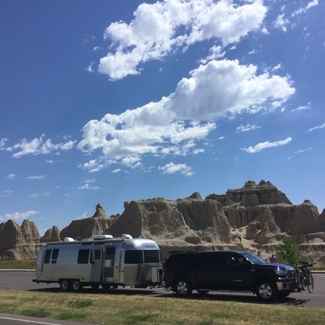

    Rig looks good, Have you tried pulling your Airstream with your 2022 Tundra?
    Andy Thompson from Canam RV in London Ontario has been setting up tow vehicles for decades and is worth reaching out to discuss any questions you have. He is very helpful and also very busy.
    Malinois38 likes this.

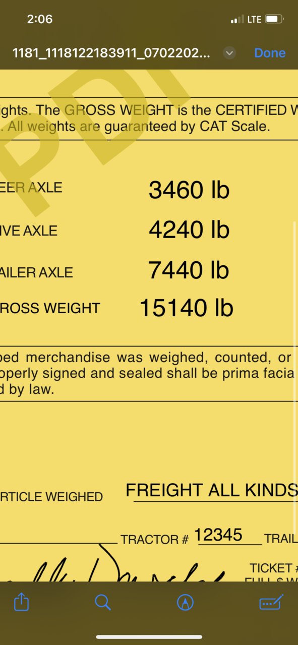

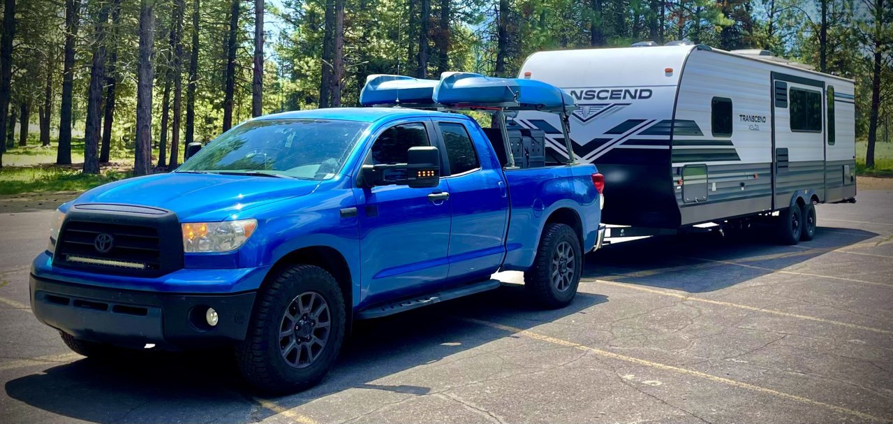

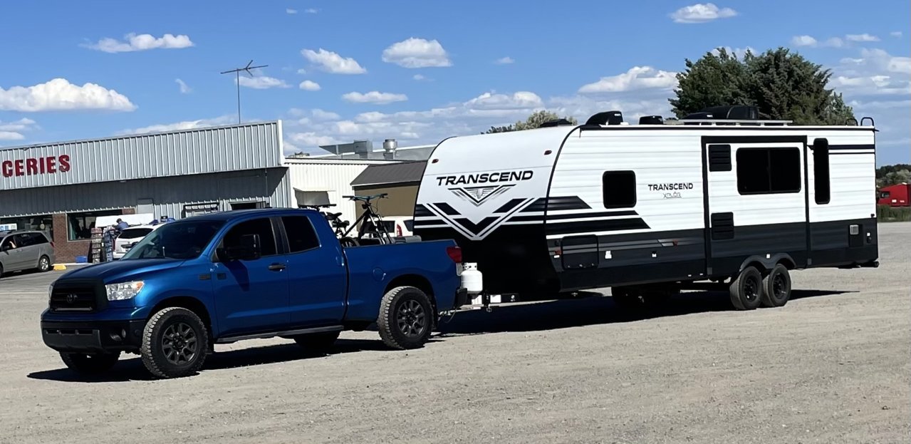

    I can’t comment on towing with a 3rd gen but I have a Transcend 265BH that is 33ft and about 8300lbs fully loaded out at most. I have an equalizer 4 point setup correctly. With my dogs and their kennels and generator in the bed I’m right at rear axle weight, good amount back on the front, and a couple hundred over rated payload. I’m not overly concerned. Truck doesn’t skip a beat. It’s worth noting that was on a recent trip that was 10 days and had TONS of stuff in the camper. Typical weights are 8k or under for weekends and 3-4 day trips and I’m typically right at payload or slightly under. I scale the whole setup quite regularly because I’m curious

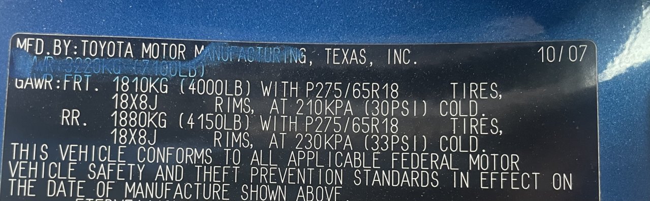

    Whats your payload on that truck?

    I’m a “tow police” style guy in that I don’t think things should be grossly overloaded but I’m a realist in that they may at times be slightly. Here’s a weigh slip from my last trip, and my door sticker. I was 600lbs over GVWR and 90lbe over RGAWR. Is that a super concerning amount to me….no not really. Was still under all other weights. That was with a full fuel take too. I have E rated all terrains so the tires have the carrying capacity, I know the axle was tested well over that capacity by Toyota, I’m comfortable with it considering I tow 1x a month on average for only several months out of the year. Typically the trailer is lighter than this, we were on a 10 day trip “loaded down”. I confirmed I had about 350lbs in the bed between the generator, dogs, kennels, and bikes.
