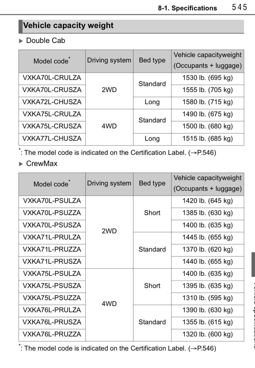

    The yellow sticker is only 1 of 15 or so possible numbers. If you open up your owners manual and go to the payload section, they list the payload for each truck configuration. The yellow sticker on every Tundra will match one of those numbers in the manual.
    So, basically, they are just slapping a generic number on every truck. They are not calculating the actual payload number for each individual truck based on the trim and options like Ford, Chevy or Ram would. As a result, most people are finding they actually have more payload than the sticker says once they weigh the truck on a scale

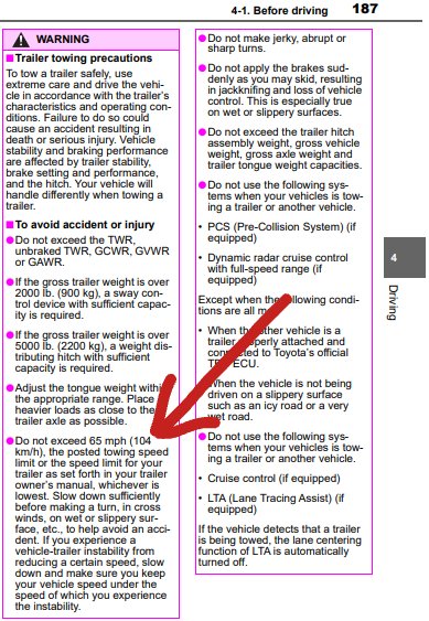

    The Tundra is not rated to tow at speeds exceeding 65 mph:

    I think the manufacturers use that as a template maximum speed as that is when sway potential increases dramatically. It is safer to say that and if you go over, then liabilities get muddy.
    If no weight distribution hitch is used staying around 60 is the safer speed.
    Toyota has no understanding of what gets hooked up once the truck leaves the lot. They give guidance but they can’t verify the setup afterwards. They can put a speed limit on as well but there will be times when you go over intentionally or not.
    The trailer tires might not be good for higher speeds as well. I think Goodyear Marathons had a low speed limit and have been discontinued.

    You missed the part where it said “To Avoid Accident or Injury”… that’s an advisory statement, not a statement of capability. The tundra will do 100mph with a trailer; I mean that literally. It’s the trailer you need to worry about, NOT the truck. Most trailer tires are rated for 65mph, hence the cautionary statement. I always put trailer tires on with a higher speed rating.

    Sure the Tundra will do it no problem, Toyota just doesn't rate it for that. You also don't have to use a W/D hitch or remain within payload capacity - you're just on your own if you choose not to follow Toyota's ratings. If you think about it, the dynamic loads on the chassis are much lower hitting a dip in the road at 35 mph when overloaded 10% than when hitting that same dip at 70mph loaded to capacity.

    The typical ST rated trailer tires used on most trailer are speed rated at 65mph. Mine are ST load range E tires and carry that rating.
    Tom
