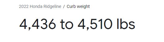

    Paul, I had a 2019 Ridgeline before the Tundra and we actually had a higher payload in that car/truck than in the Tundra. We were expecting a higher payload with the Tundra. Fortunately for us, our trailer is on the lighter side so not really an issue for us even with all the stuff we bring along.

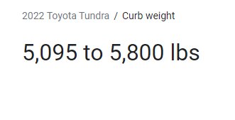

    @PBNB yes, I see that too. Wow, how did our half ton Tundras end up with such lame payload? Is Toyota really under rating it or is there something about it that is holding payload rating back?
  10. Jan 1, 2023 at 10:54 AM
    #40
    34,182
    18" TRD Off Road Wheels
    If you look in the manuals, since the last generation they state that the vehicle's primary purpose is as a passenger conveyance. They are not trying to compete with the big 3 as work tools. They have no interest.

    I am not too sure what the weakest link is in the payload puzzle. I know that they factor all sorts things like frame, brakes, suspension, tires and wheels to name a few. If you compare the Tundra to something like a Ridgeline, you can easily see the massive differences in the Tundra that should give a higher capacity. It is hard to understand why our payload numbers are so low.
    I think the 1794 model with the Hybrid is closer to 1,200 lbs.
    I put some rather heavy duty tires on the truck that have a max rating of ~3,700 lbs each. I am sure that those are better than the near bald Michelins that came with the truck but I am still stuck with a payload of 1,390 lbs!
    Perhaps Toyota has a rather large safety factor in this payload calculation.

    Godzilla, It looks like the heavily optioned Ridgeline does not get the same payload hit since there are only a few configurations. There seems to be 100's of configurations for the Tundra. So if you are running an SR without a sunroof, your payload could be closer to 1,900 lbs.
    The marketing department seems to have missed the part in the shinny brochure! The picture shows a well equipped higher trim that has all those towing gizmos. Probably over on payload in the photo and the AVS is cranked up to try and level the truck.
    GODZILLA likes this.
