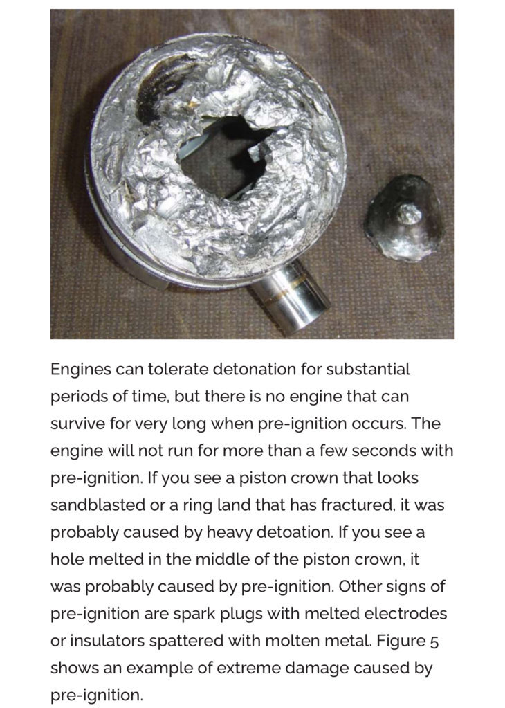

    Granted I’m not familiar with the new low tension rings.
    I’ve seen 3 engines, one right after the other, with pre ignition damage (390 ford heavy duty, big block Chevy, and an international gas engine; bus engines destroyed when fuel
    supplier delivered some bad gas to their storage tanks). They not pretty.
    I would lean more towards detonation if it were engines I was familiar working on.
    Took a bit of looking but finally found picture of piston damage from pre-ignition like i saw in the bus engines.

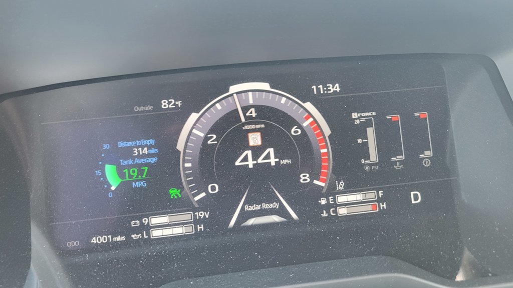

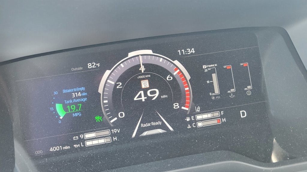

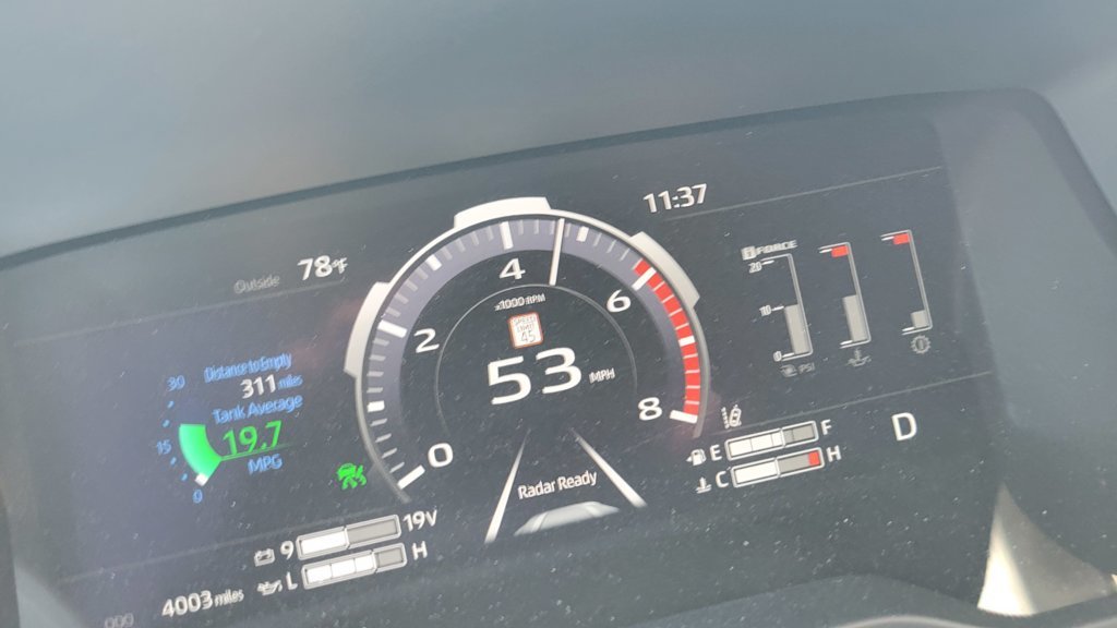

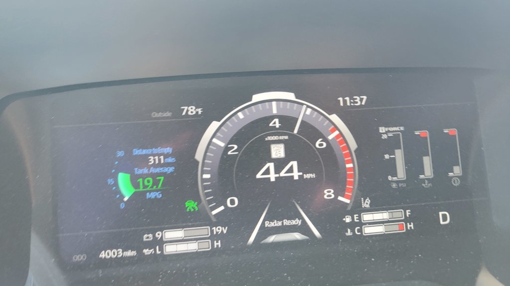

  7. Jul 10, 2025 at 11:57 AM
    #37
    34,356
    18" TRD Off Road Wheels

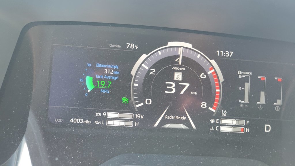

    Just got back from my lunch break, and I grabbed some pics. First, I was mistaken, the boost gauge does have numbers on my usual display. The oil and transmission temps do not have numbers, but the boost gauge has half assed ones.
    Anyway, I floored it from 30 to get to 55, and then again from about 25 to get to 55. Both times it seams to peak around the 17 to 18 PSI mark, but as speed is gained after 40-45 MPH it starts to bleed off the boost.
    First two pics are the first run from 30-55.
    The next 3 pics are from the 25-55 run.
    This was with foot to the floor driving. With normal acceleration the boost is staying below 10 PSI.
    G_unit3000 likes this.

  13. Jul 10, 2025 at 12:30 PM
    #43
    34,356
    I've got some little hills around town. I'll try to get out and cruise up one to see what boost does in that scenario. If memory serves, it downshifts for anything but a tiny hill. We'll see.

    How did you get that display? Is there a place to change to it?
  24. Jul 11, 2025 at 10:26 AM
    #54
    34,356
    I assume you are asking me? Quoting or tagging helps people know.
    With the truck running, but not moving, go to the settings (gear symbol) in the left menu of the dash. If you scroll down until you see the option "Customize Right Side" and you can change it there.
