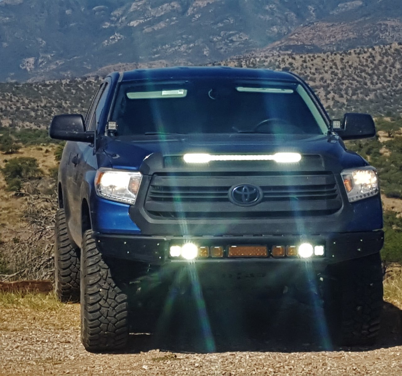

    I'm not entirely sure I have enough pics for a build thread... but eff it.
    September 2018: Just got back from Teluride CO. What a blast
    April 2018: Day Alot: Had it for just over a year now. Upgrades thus far:
    March 2017:Day 1: 2014 Double Cab w/ 34960 miles.
    Armor:
    Front Bumper: nFab M-RDS
    RCI Steel Engine Skid
    SDHQ ABS Guards
    Suspension:
    ADS 2.5 Remote Resi w/ 700lb Coils
    Camburg Tubular UCA's
    ADS 2.5 Piggybacks
    1.5" Adjustable Toytec Shackles
    (Springs are next, not sure what route yet)
    Tires:
    35x12.5R18 General Grabber X3's
    MB Wheels 352 (custom)
    Lighting:
    Rigid SR8 30" - hood bulge w/ custom mount
    Rigid Dually Pro's - x2 - Center
    Rigid SAE Fogs - Center
    Rigid Radiance (Amber) - Center
    Rigid Hi-Low - A Pillar
    Rigid E-Series 10" - Center
    Blue Sea fuse block in engine bay
    All new wiring loomed with some fancy blue/black stuff.
    Other:
    'Murica Tailgate Wrap
    Bedlined Grille/Bulge
    I'm currently designing a mount/brace to go over my transmission hump that will house a CB, bigger HAM, switch mount, and other goodies.

    What ball joint are you going to use? I just swapped in a set of ACDelco Pro Series on an extra set of lowers I have.

    I hear Moog makes good stuff. How do you like the ACDelco's? Do they come with a new boot, too?

    I have had a lot of issues with rubbing because the tread on these tires is ridiculously beefy and I'm only rockin a 3" ish lift. The tires are MT's so they're loud, but not obnoxiously so. After 10k miles I have only lost about 1-2/32nd tread. Traction is great, especially when aired down.

    The ACDelco Pros are good quality...made in Japan. I haven’t installed those arms on the truck yet, though. A lot of people hate on Moog these days because some of the stuff they put their name on is of a lower quality than what they used to sell back in the day. Their replacement ball joints for Tundras (K-series) are probably similar quality to the ACDelco Pros, assuming they are made in Japan. Moog also sells an entire lower control arm (r-series) with new bushings and ball joints. Those ball joints are probably lower quality. Beck/arnley is another quality ball joint that is made in Japan. Probably the same as the ACDelcos/k-series. All of them will come with a new boot, castle nut, and cotter pin.

    @UTTundra thank you for the info sir! I found your write up on the differences between the manufacturers. :thumbsup::dancingbacon:

    Looks good Ryan! I'm guessing your rubbing is in the rear of the wheel well? Camburg builds a lot of caster into their UCAs.

    Yeah, I need to have my CMC done by an actual shop cuz its definitely half assed. I only rub when I make a really tight left hand turn so its not too bad anymore. I'm running +5 degrees caster. I need to mess with the ride height adjustment on my shocks, too.

    +5 caster sounds perfect IMO. But I don't know sh**.

    Its worked pretty good thus far. I went from -2 to + 5.. the drive down to get my alignment done was fun.

    Finally got the last of the 3/1 leveling kit off, with help from @boardude. Holy crap, so much smoother on the rear end. Chopped the exhaust just above the axle, aaaaaand finally yanked out the stock spare/chopped off the spare mount holder chain thingy.
    Next up, re-wiring electrical to a more permanent set up and playing musical pods with my lights. Turns out the amber back light on the radiance pods sucks - could be from the rest of my lights being so bright. Or they just suck. Not really at all impressed either way.
    Current engine wiring:
    -Changing out to blue/black braided loom (cuz OCD)
    -Adding Blue Sea 12 circuit blade fuse block in place of in-line fuses.
    -150A 4 stud bus bar for grounding
    -Not really sure what to do with the relay blocks yet, but the double sided tape on top of the fuse box seems to be doing a hell of a job
    Musical lights:
    - A pillar - From Dually Floods to Hi/Low
    - Fogs #2 - From Radiance pods to 2nd set SAE pods
    - nFab bumper gap -
    2 sets of Duallys w/ amber covers, (Maybe a 3rd set of pods :bananadance:if they'll fit. Not sure yet.)
    20" rigid bar​
    I'll try my best to remember to take pictures of all this as I go. I may have to hire a photographer so I don't forget.
    If anyone has any ideas for bracing a hood bulge mount, I'd appreciate input. I built my own and bolted it straight through the bottom of the hood. It flexes A LOT when going over bumpy shit so my bar flops up and down.

    Been busy. Here's a few pics and a list of mods over the last 3 weeks:
    Broke my driver side shock which led to a whole slew of upgrades and fixes
    The shop that replaced my LCA ball joint for me turned it into a mini smore's roast cuz it was stuck haha. They broke one of their handheld presses trying to get it out.
    New:
    -ADS Rebuilt my driver side shock
    -Upgraded to 700lb coil springs
    -Replaced driver CV joint
    -Replaced driver LCA Ball joint
    -Front Diff flush
    -LIGHTS LIGHTS LIGHTS (Thanks a TON for all your help @eccracer104!!)
    -10" Rigid bar w/ amber cover
    -Dually floods w/ amber covers
    -Moved Hi/low dually's to A-Pillar
    -Moved SAE, Spots, and Floods w/o amber covers to center of NFAB bumper​
    -Loomed wiring in engine bay
    -Added fuse block and secured relays
    -Will be adding in-line fuse between battery and fuse block shortly​
    -Fixed Hood bulge light bar mount so it no longer shakes when on bumpy roads
    -Fixed/Replaced hood bulge + repainted (broke too many clips to reuse old one)
    -Repainting/replacing grille (broke several clips) - In progress
    -Added TRD Punisher decals to bed sides for a gain of +1776 HORSE POWWWAAHHHHH. 'Murica!
    -Fixed/Repainted NFAB's shitty aluminum skid that comes with the bumper. I bent the hell out of it on a log at T2S haha
    To do:
    - Alignment semi-corrected steering pull to the right.
    - Find what's causing vibration at high speed (probably driver tire, haven't had time to have them balanced after my mishap)
    - Detail interior/exterior
    - Build center console bracket to house lighting switches, HAM/CB, & other goodies
    - Replace/tint front windshield
    - Fix remote start (or be lazy and make one of my co-workers do it since they installed it haha)

    Hell yeah the lights turned out great! Good call swapping out the bar :thumbsup:
    Sub’d for night output shots :popcorn:
    And how’d you break a shock?
