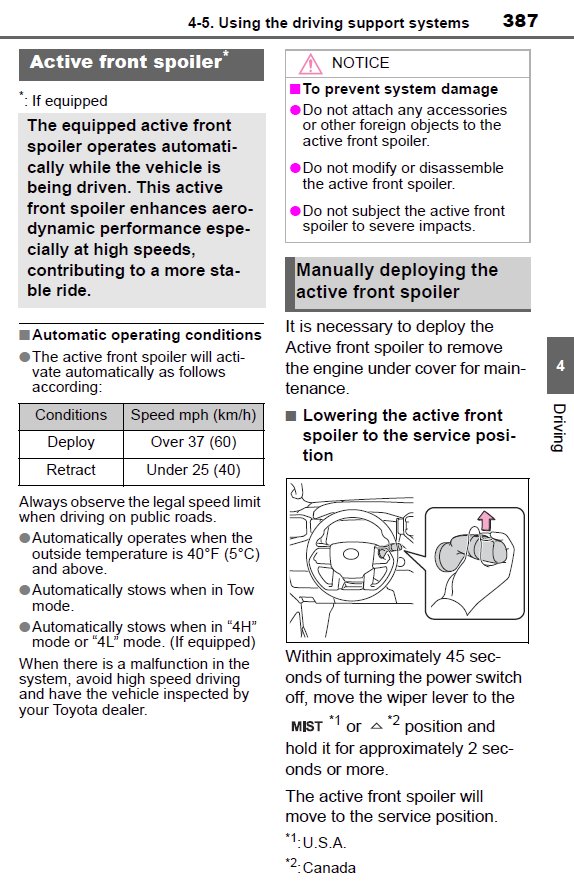

    Super easy to deploy while parked, simply hold windshield wiper switch in mist position for more than two seconds after ignition is turned off and within 45 seconds of ignition being turned off. Another way to deploy without starting truck is to just hit the start button three times with foot off brake pedal and then move wiper switch to the mist position for a couple seconds, spoiler will deploy.
    Embarrassed to say, I didn’t think my CM SR5 4x4 had the deployable spoiler when I looked under truck when I bought it. Today I noticed what looked like a little electric motor down low in front of radiator area and was thinking what the heck is that thing for, looked at it with mirror and light bulb still didn’t go off. Crawled under truck and looked to see WTF and realized it’s hooked to a bracket that deploys the spoiler. It’s kind of funny because since I bought the truck I thought it exceptionally stable on the highway and didn’t need a stinking spoiler.
    I think it’s a cool gizmo.

    I’m not positive but I heard that it doesn’t deploy under like 40 something degrees so hopefully snow isn’t an issue
