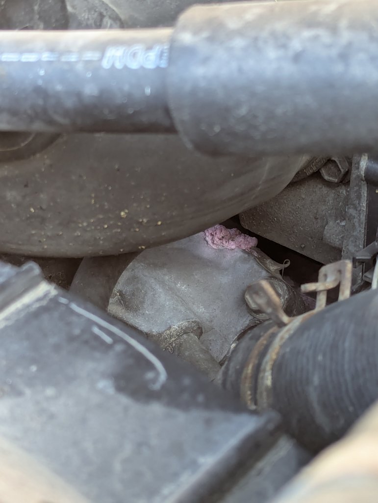

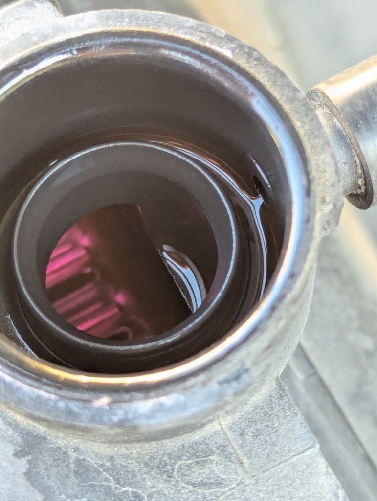

    Cleaning my 04 DC this afternoon and spotted this gem. Looks dry at the moment and coolant overflow is still at the full mark.

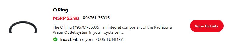

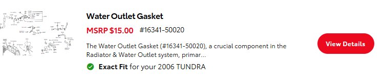

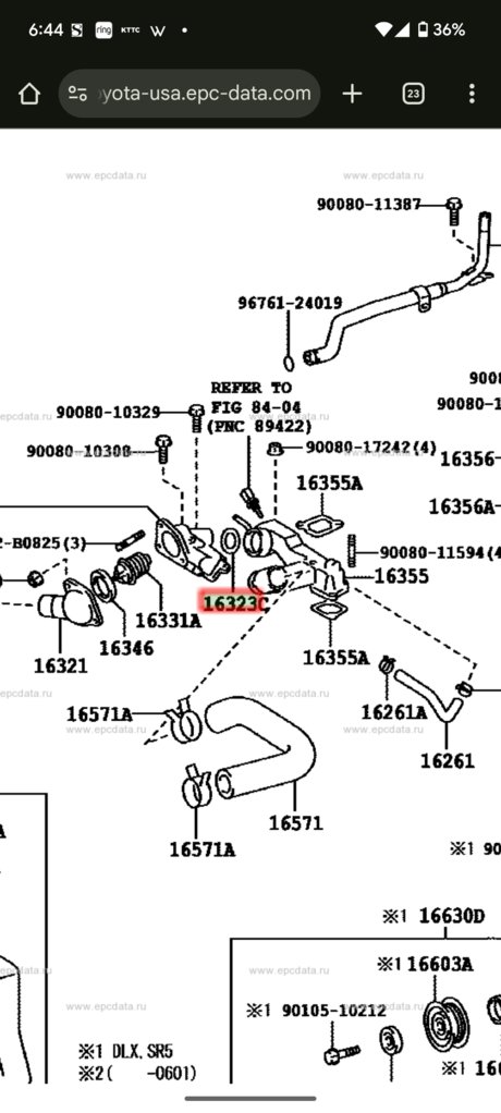

    For the repair it looks like i need a new o-ring (96761-35035) and some sort of gasket maker for the square flange.
    08826-00100 = $$$$ green stripped tube
    00295-00103 = $20 a tube and I’ve read it’s been a suitable replacement.
    I’m leaning towards using the 103 tube, anybody done the same?

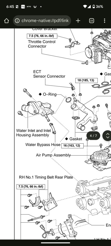

    I did this repair before.

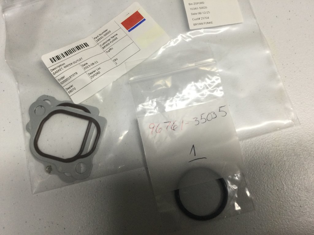

    I went with the same part number. I would recommend replacing your thermostat while you have the coolant out. Mine recently went out causing a grenade of problems
    Part Number
    96761-35035
    Engine Coolant Pipe O-Ring $4.11

    Super easy fix, took me 20 minutes I just used permatex gasket maker and a new oring. Also changed the Thermostat and gasket while I was in there!
