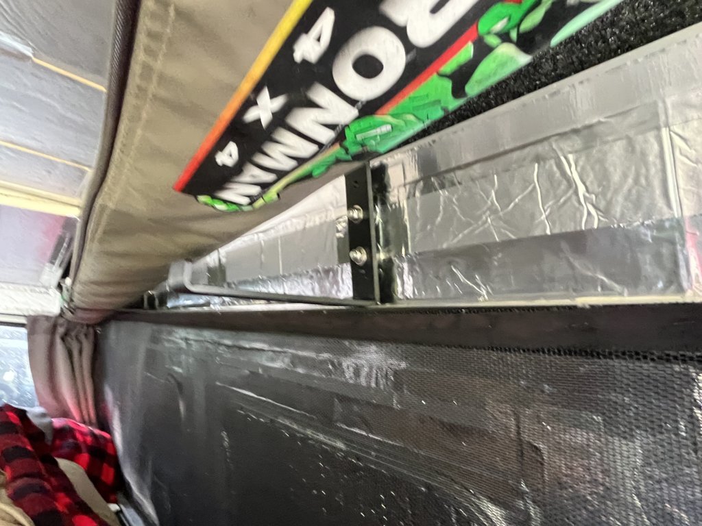

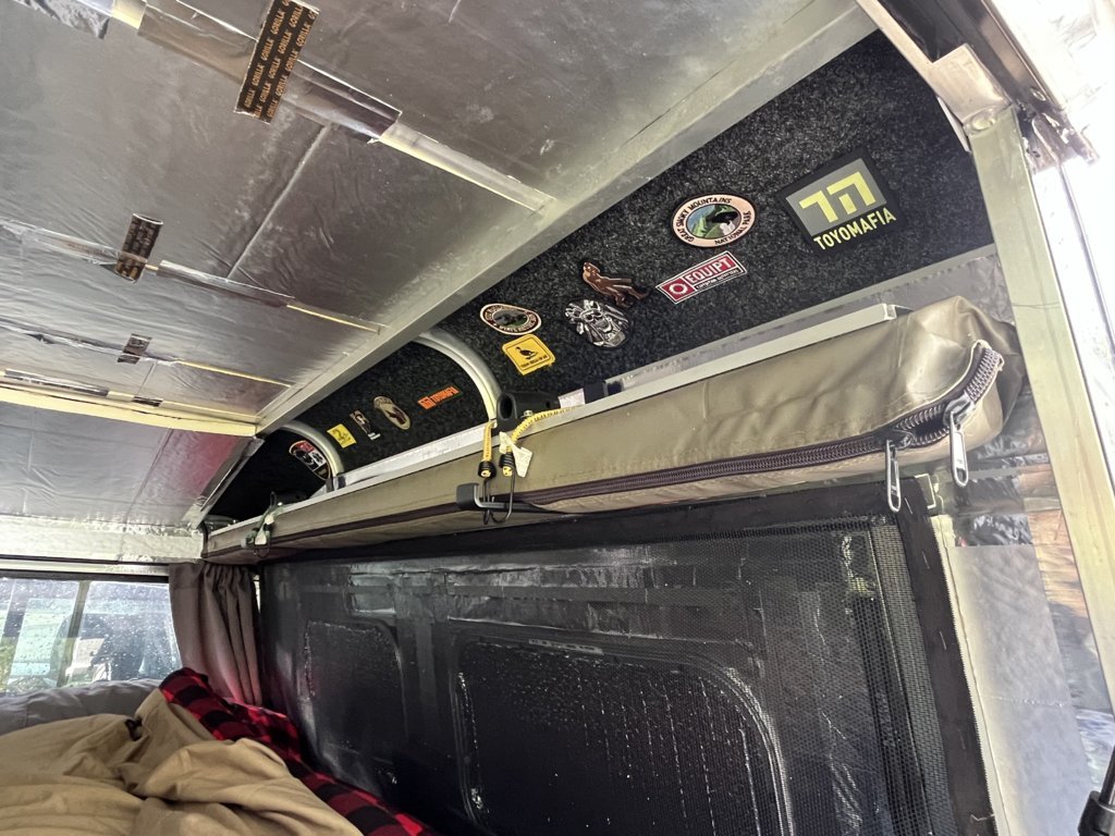

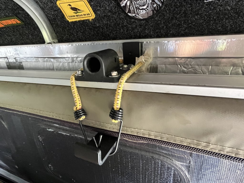

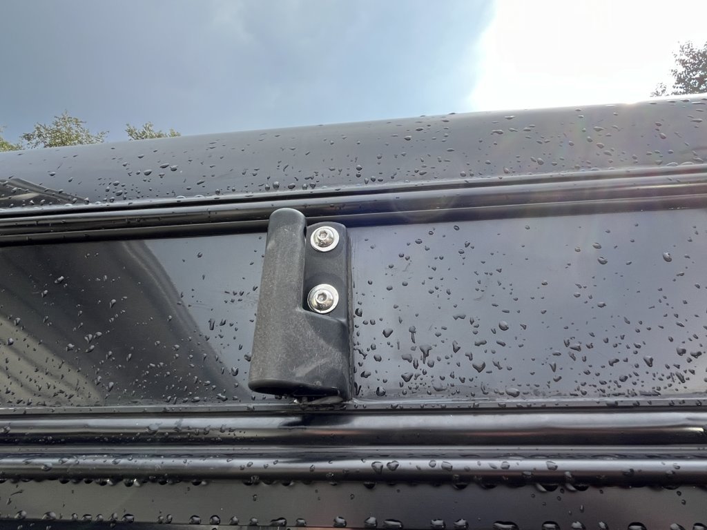

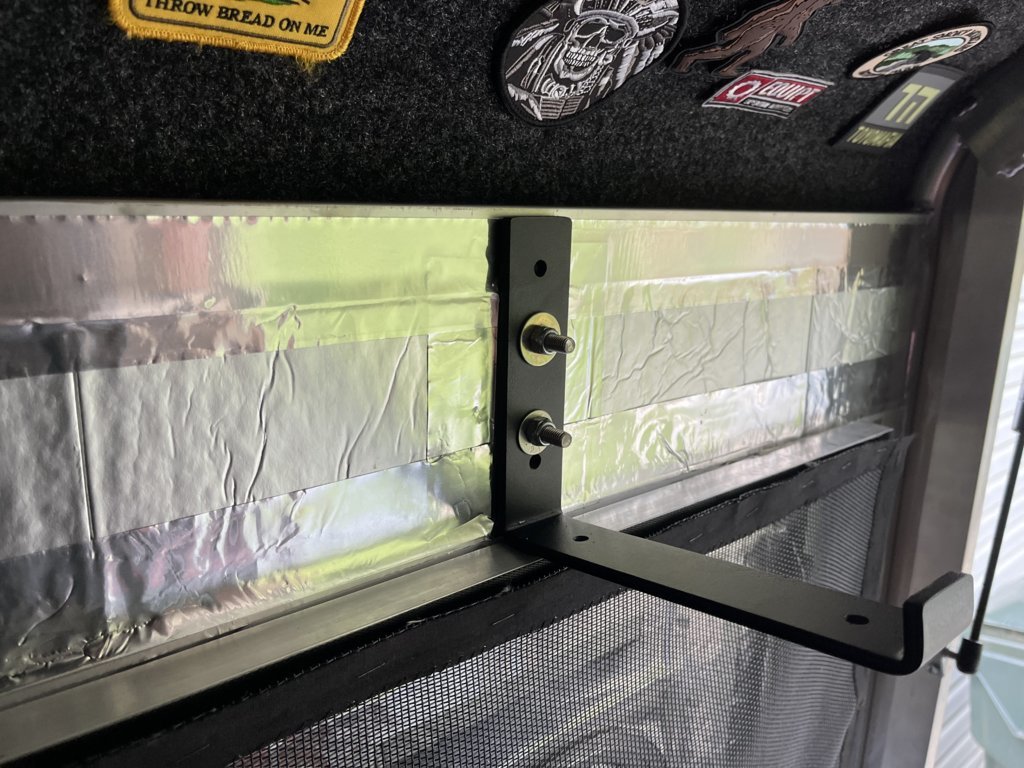

    Finally sorted out where to store the awning. Bought these shelf hangers off Amazon. Had to bend them in the vice to improve the level when installed.
    Drilled some holes and attached them to the bolts that hold the Ironman 4x4 quick release awning mounts on. But probably should reconfigure this to where the awning shelf brackets are flush instead of backed again the nut of the quick release bracket.
    For now using some old bungie cords to hold the awning in place.
    So far so good and we will see how it holds up. Happy to have the awning up and out of the way.
    Really have to get that insulation completed. Been lazy. :rolleyes:

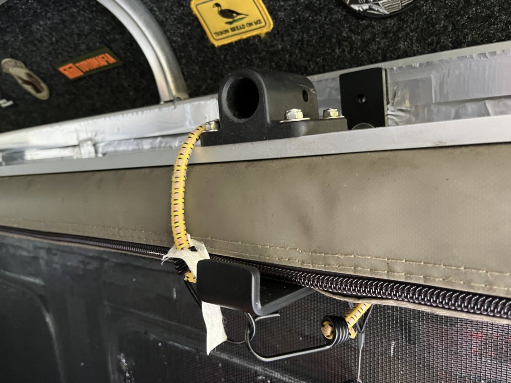

    Ok well the OCD got the best of me. Reconfigured the mount. Feel it’s a lot stronger this way. But will now need to shorten the bungies or find another way to secure it.

    Nice, i like the idea of keeping the awning out of the weather and theft prevention as well. i will steal this idea when/if we get an awning.

    For sure. The sun destroys those things if left out all the time. And it’s more low key this way. I’m in the woods a lot so the awning only really gets used if the weather is bad. So it’s nice to have the option to pop it on or off fairly quickly.

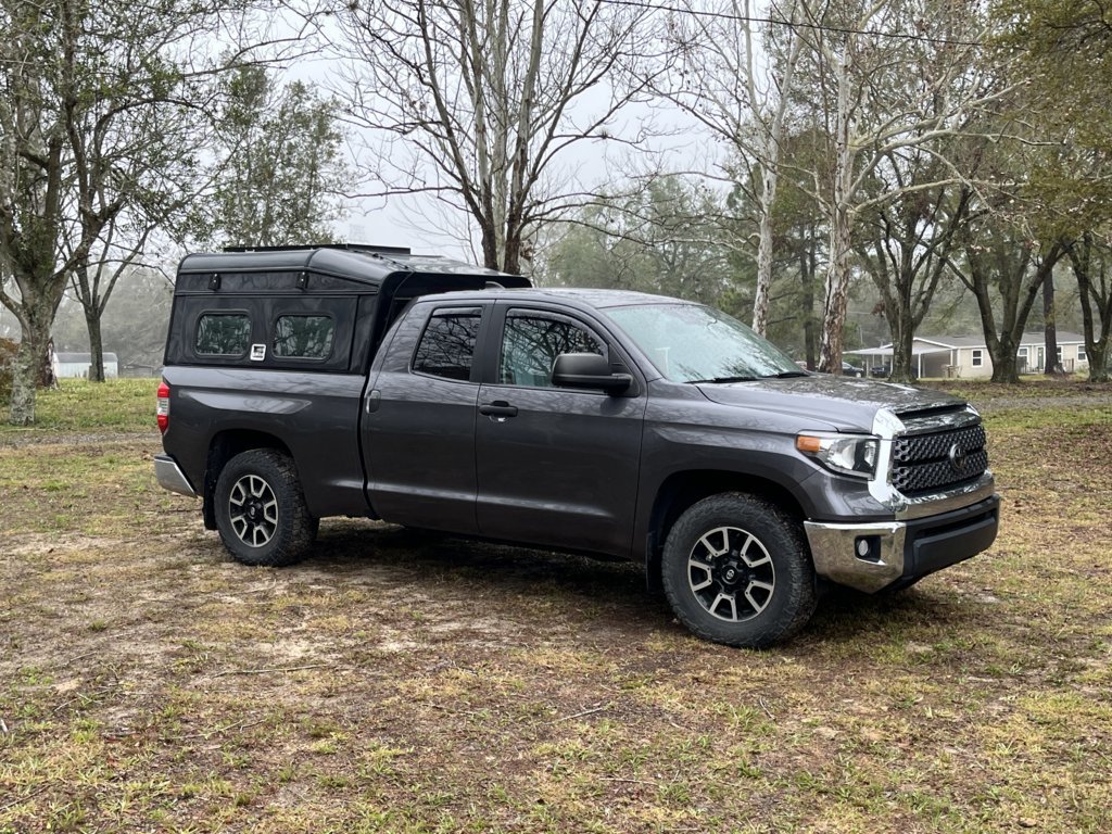

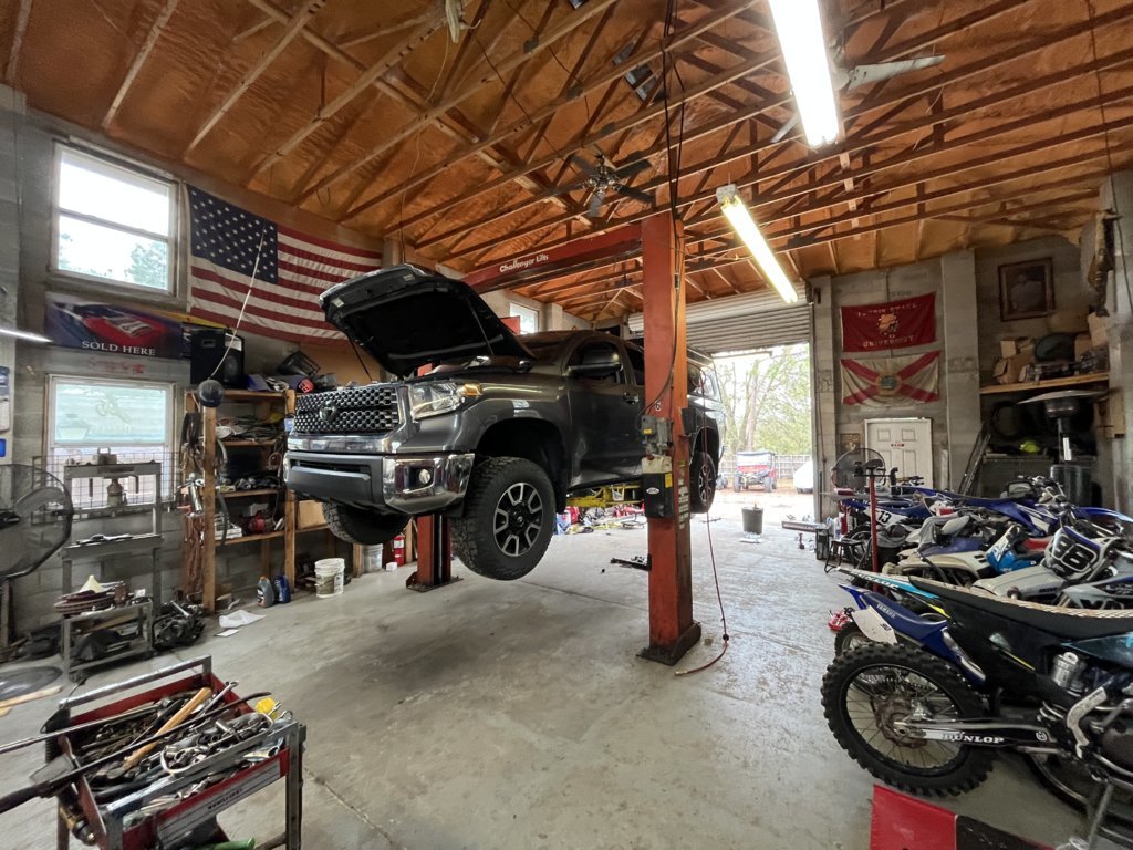

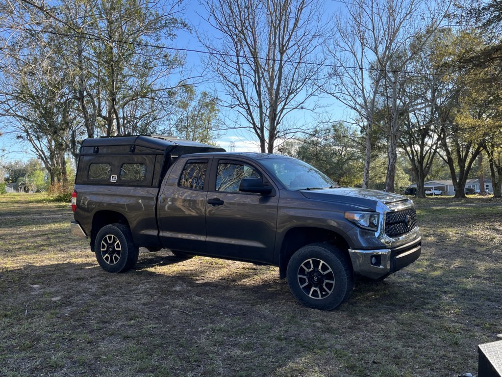

    Purchased an Ironman 4x4 PRO suspension kit probably well over two years ago at this point. During this time period Ironman 4x4 informed me that there was a recall on the upper control arm bushings. So I sent the set I had back to them and they sent me a new set with updated UCA's. This was back in January of '24. Two weeks ago I Packed up the kit and drove down to FLA to a friends house that has a lift. We get the back done in about two hours and start on the front. Get the drivers side UCA off, crack open the PRO UCA box and uh oh! The PRO UCA's are for a 4Runner! My fault for not checking!
    Instantly get on the phone with Ironman and informed Bubba about what happened. I informed him that I was out of state putting the lift on and asked about express shipping on the correct arms. I started to freak out a little when he informed me that they do not do express shipping and that he needed to ask about what to do about this since I received the UCA's back in January. Then he informed me that it is ok to install the suspension with the stock UCA's. Thank you!!
    Later that day I received an email from Bubba telling me that they are sending me a shipping label so I can send the wrong arms back to them when I get home. He also said, since I will likely have to pay to get the new arms on, they are willing to give me $450 towards that installation and of course another alignment. Pretty dam good customer service IMO!!
    So we get the fronts installed with the stock arms and get it to the alignment shop. They were very busy and had the truck for a day and a half. Went to get the truck and they said "we have a serious safety issue". The passenger side tie rod end was only into the tie rod about 5/8 to 3/4 of an inch. Not good. After lots of phone calls to Ironman and everywhere else, no one has ever heard of this being an issue on 3.5" lifts with stock UCA's. But never the less we have the issue. Ended up at a Toyota dealer and ordered another tie rod lock nut. Installed that and welded the nut to the control arm, instant fix LOL. It is what it is until I can get the right UCA's on. So here are before and after pics. I have the HD kit. It rides like a truck but is a massive improvement over the clapped out 5 year old stock suspension.

    Love your Tundra and i gretaly miss my 2018 Double Cab 4WD TRD with 8 foot bed

    Thanks! I wish I could of have found an 8' bed when I looking for mine. Really like the look of them lifted also.
