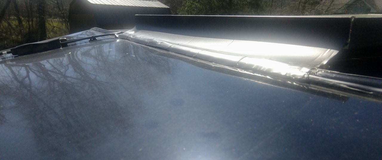

    Heres a not so good pic of the pseudo airdam I made using eternabond tape. Hasn't moved in 3000 miles.

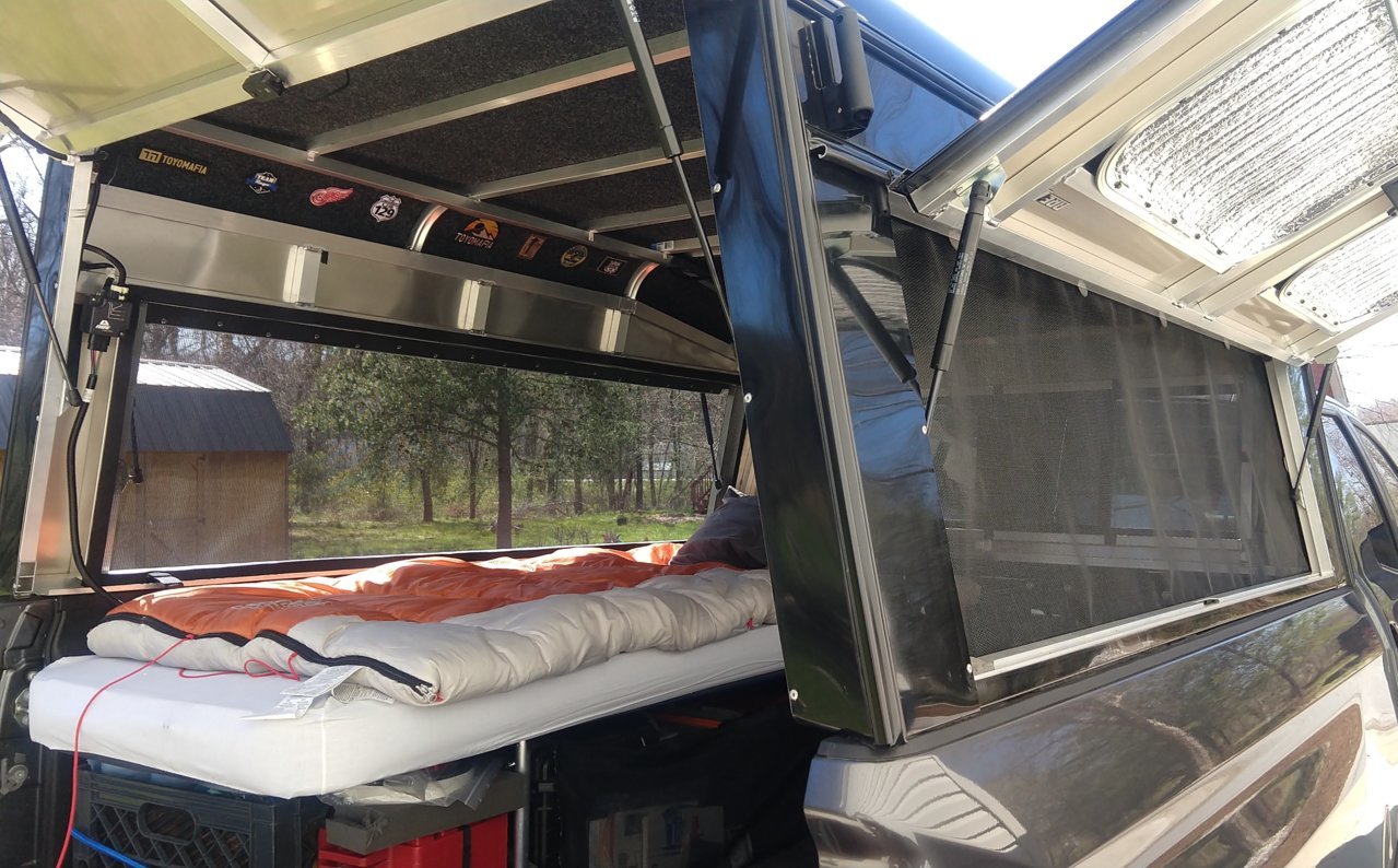

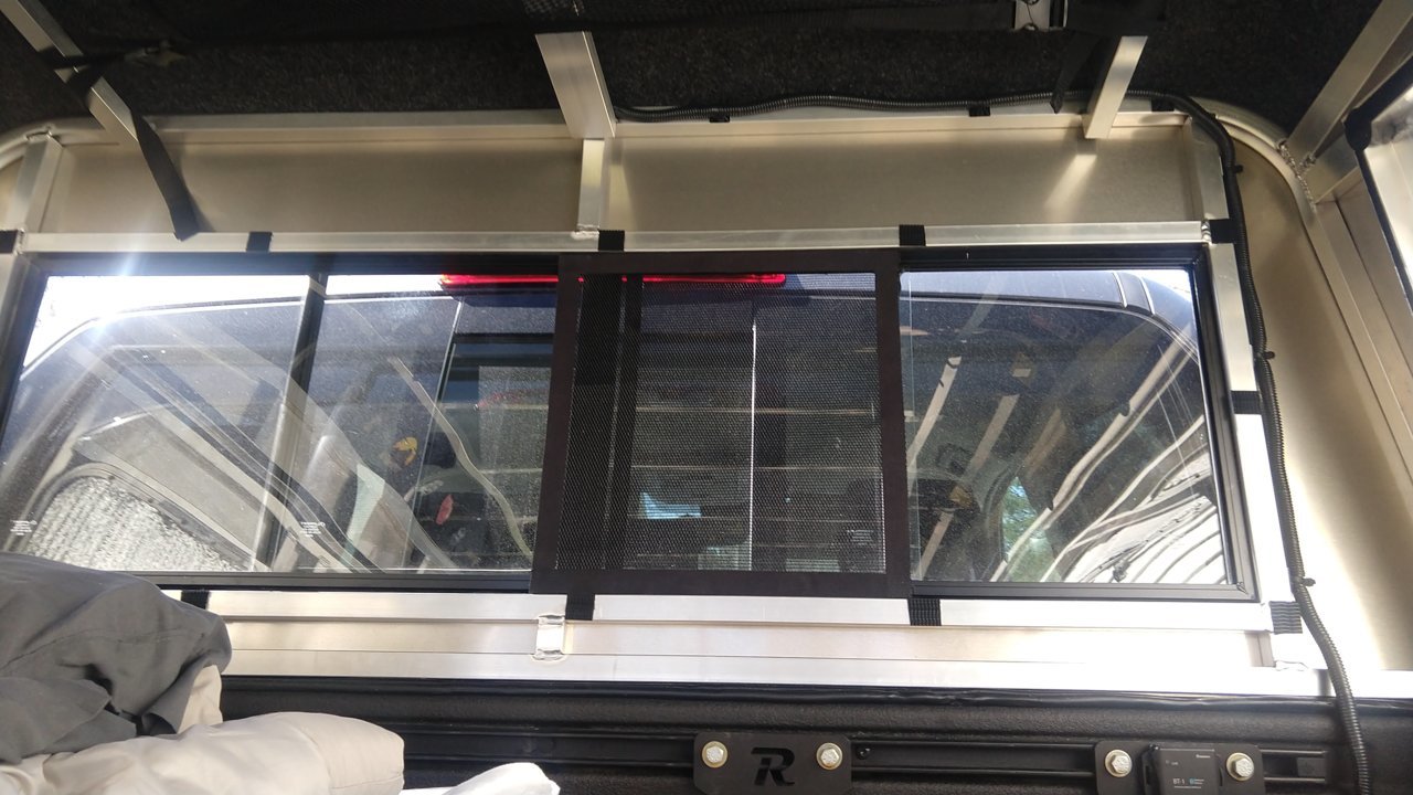

    Ok was finally able to get some work done this weekend. Got the screens sorted out. Used pet screen then used hockey tape on one side around the border of the screen. Then flipped it over and used gorilla glue to fasten the cloth side of the velcro to the screen. Worked out well and I hope it lasts cuz this was not fun.
    Front over one side of the sliding window. When that side is open completely, the velcro lines up.
    An the sides. Closed the back after putting these in and laid down, almost fell asleep, plenty of airflow.

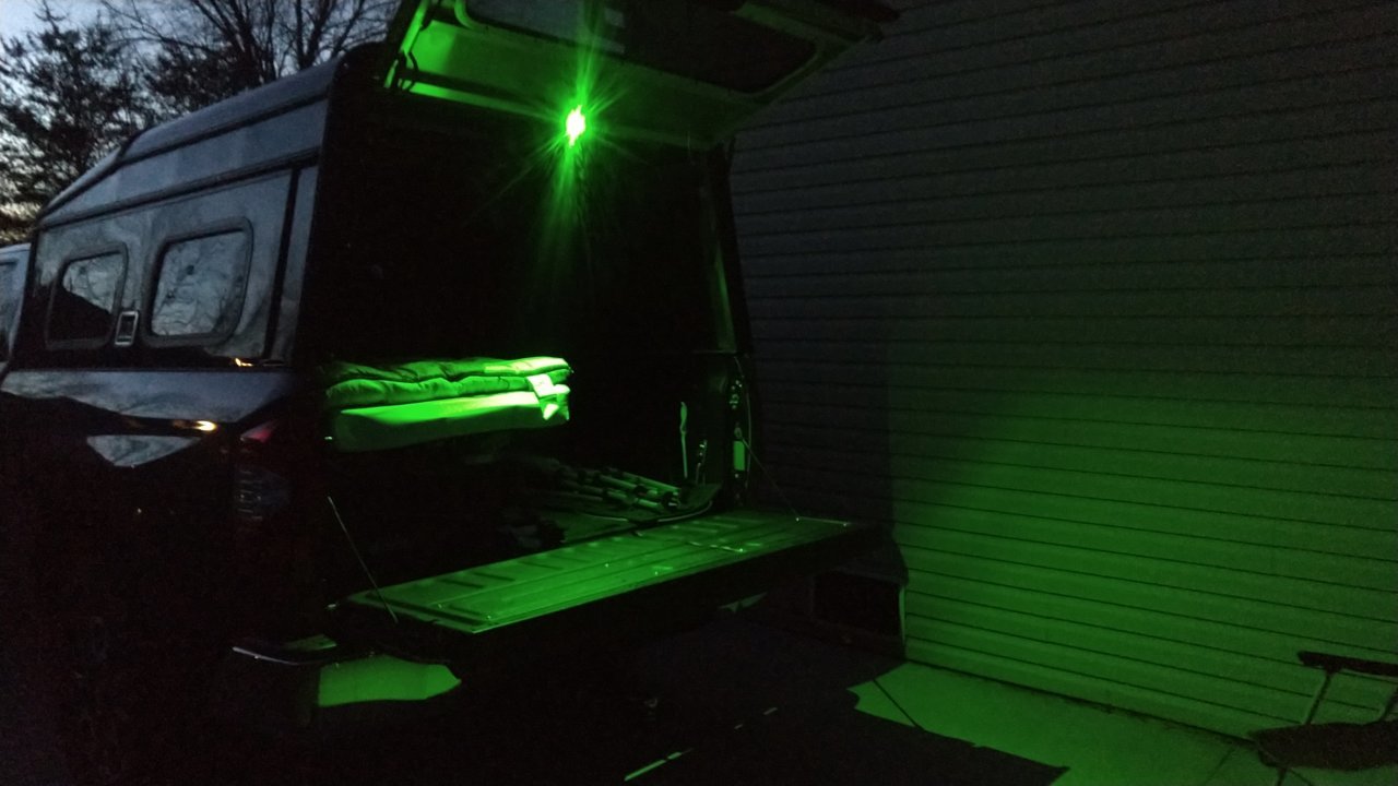

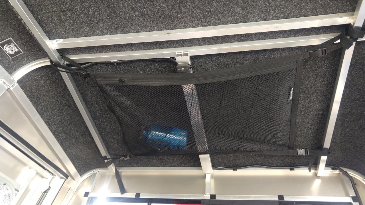

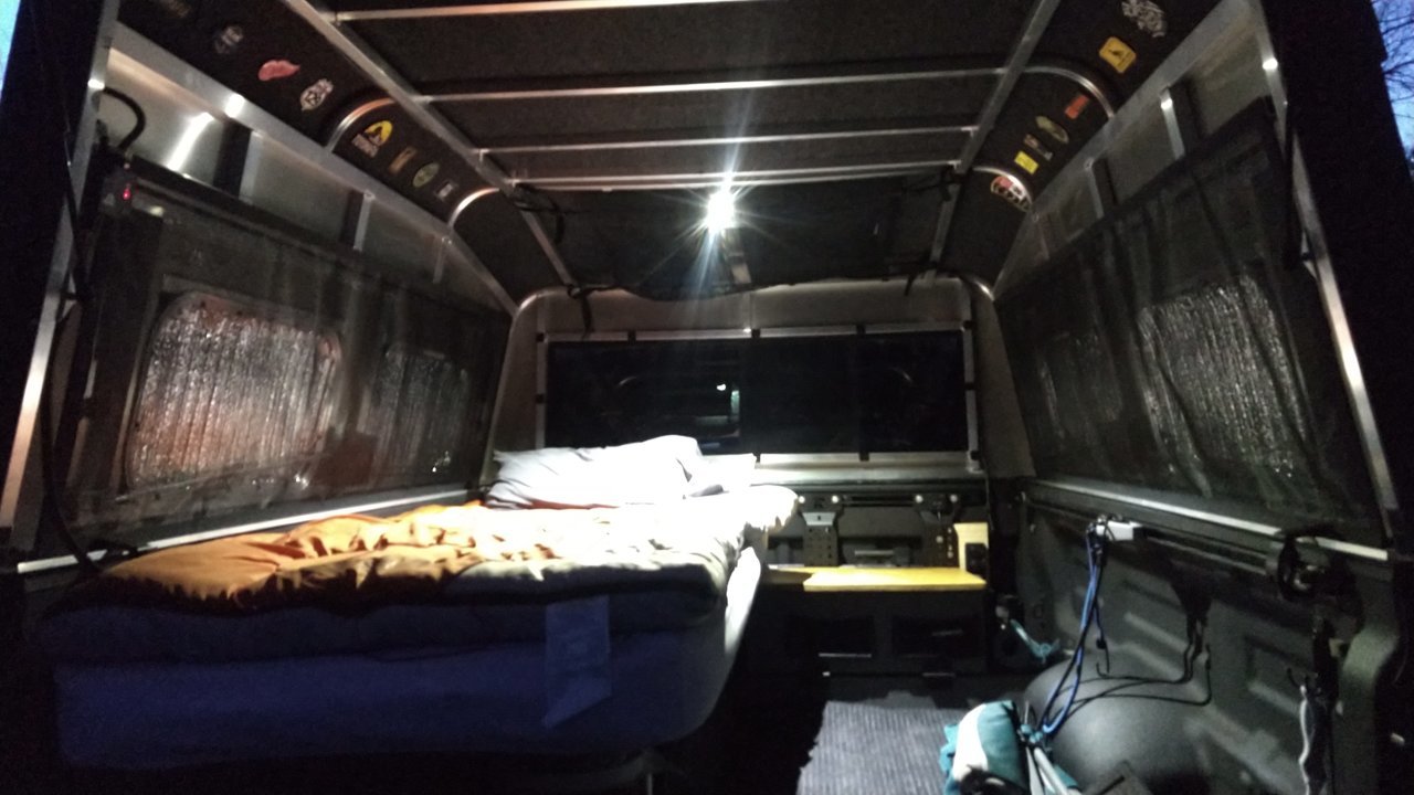

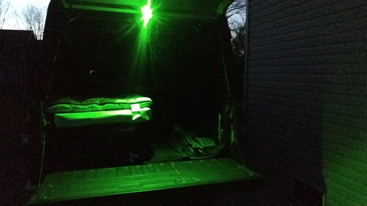

    After an almost nap, started on the lighting. Bought a white Baja Designs dome light and already had the green one from the previous setup. These little lights are nice and they should be for the price. They put out plenty of light for this application. Very happy.
    Used the white for the interior and the green for the back yard.
    In the pic above you can also see the overhang storage net I picked up off Amazon....never drink out of the blue nalgene!

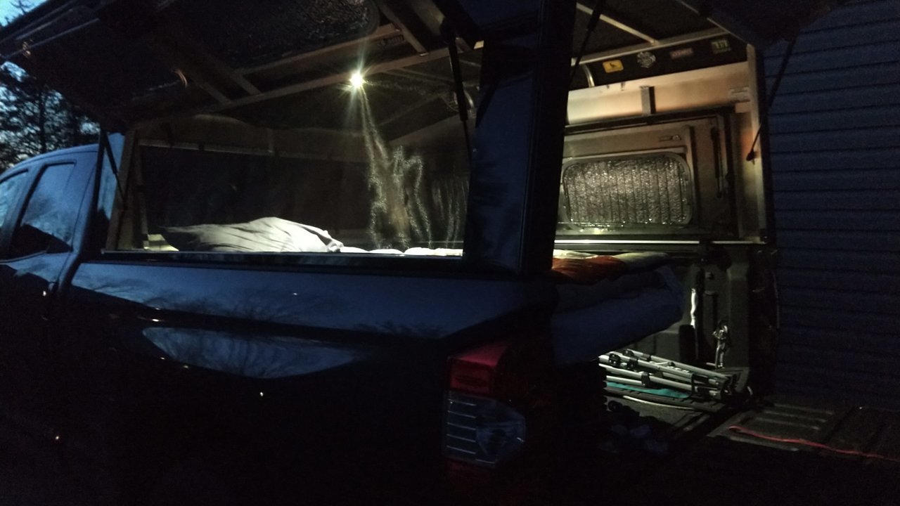

    Sort of night shots of the brightness of these great little lights.

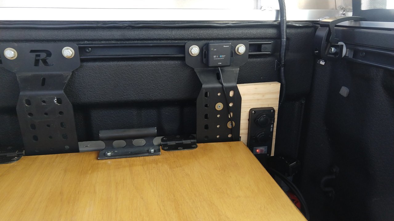

    Then decided I needed better access to the 12V plugs so whipped up this little bracket to mount it to. Previously this was on the side of the battery box. Didn't stain it or anything, I'm tired!

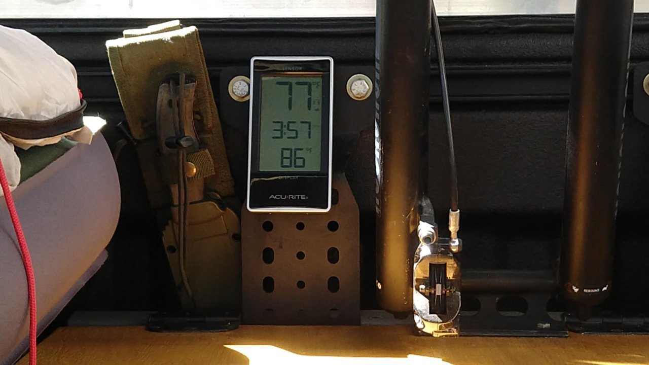

    Mounted an indoor/outdoor temp gauge by accurite in the topper.

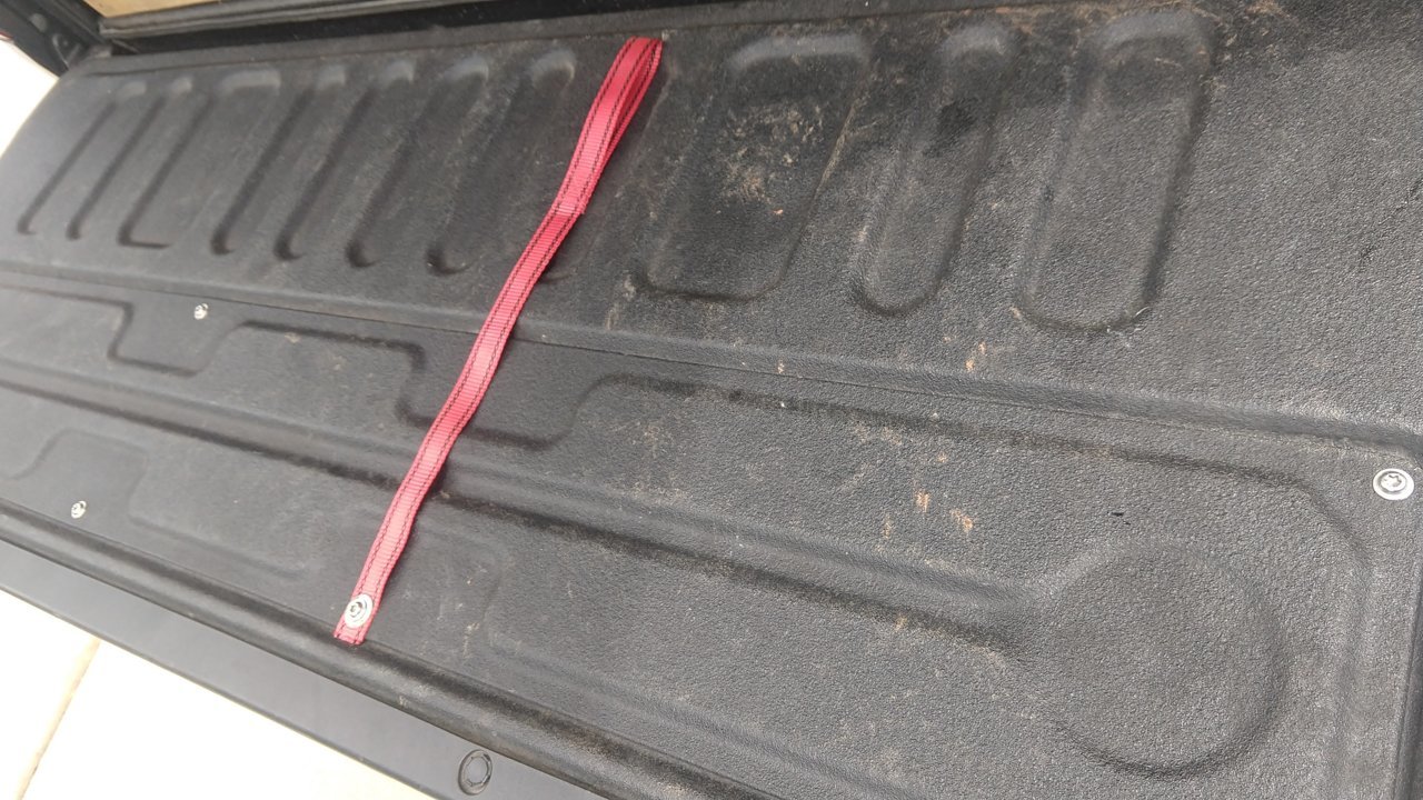

    I cut off the end of an old ratchet strap and used a couple washers with a bolt on the tailgate. Works great.

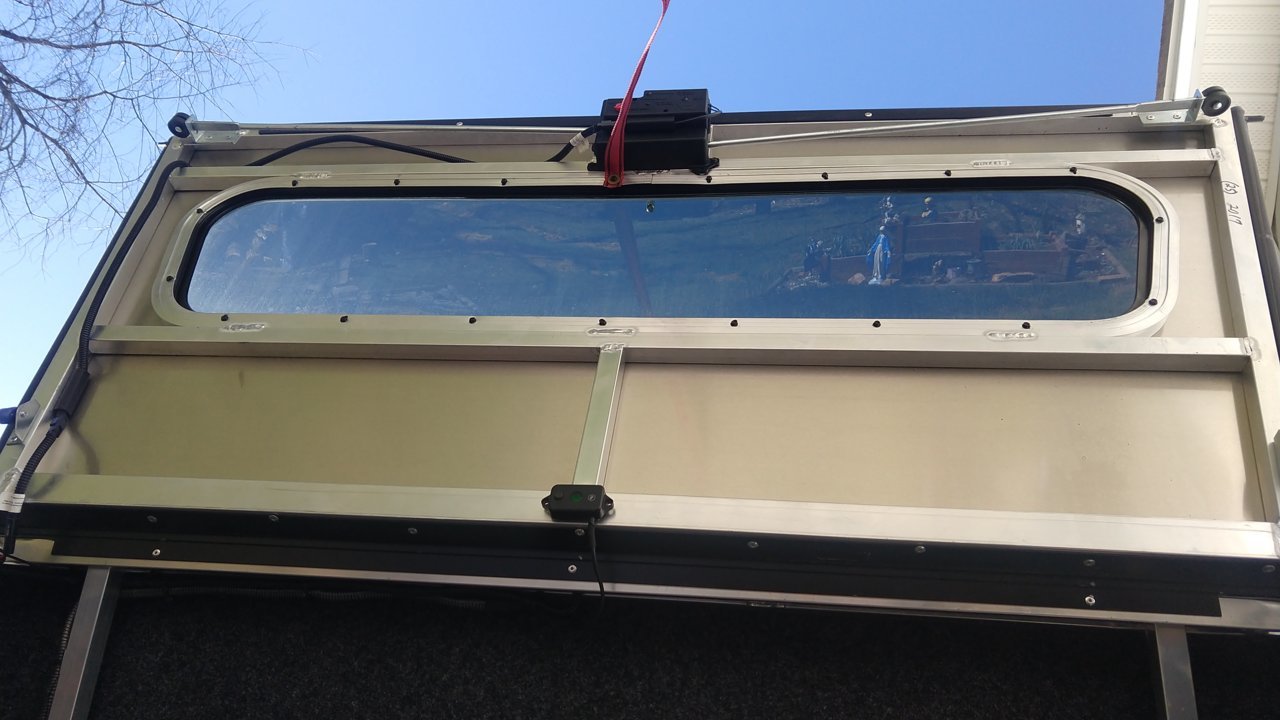

    An finally got the awning mounts bolted up. Should have never tried to 3M tape those mounts. The tape is not good for vertically mounting things that have weight to them. However, no regrets using it on the solar panel as it is solid up on the top. So happy to be able to use the awning again. :thumbsup:

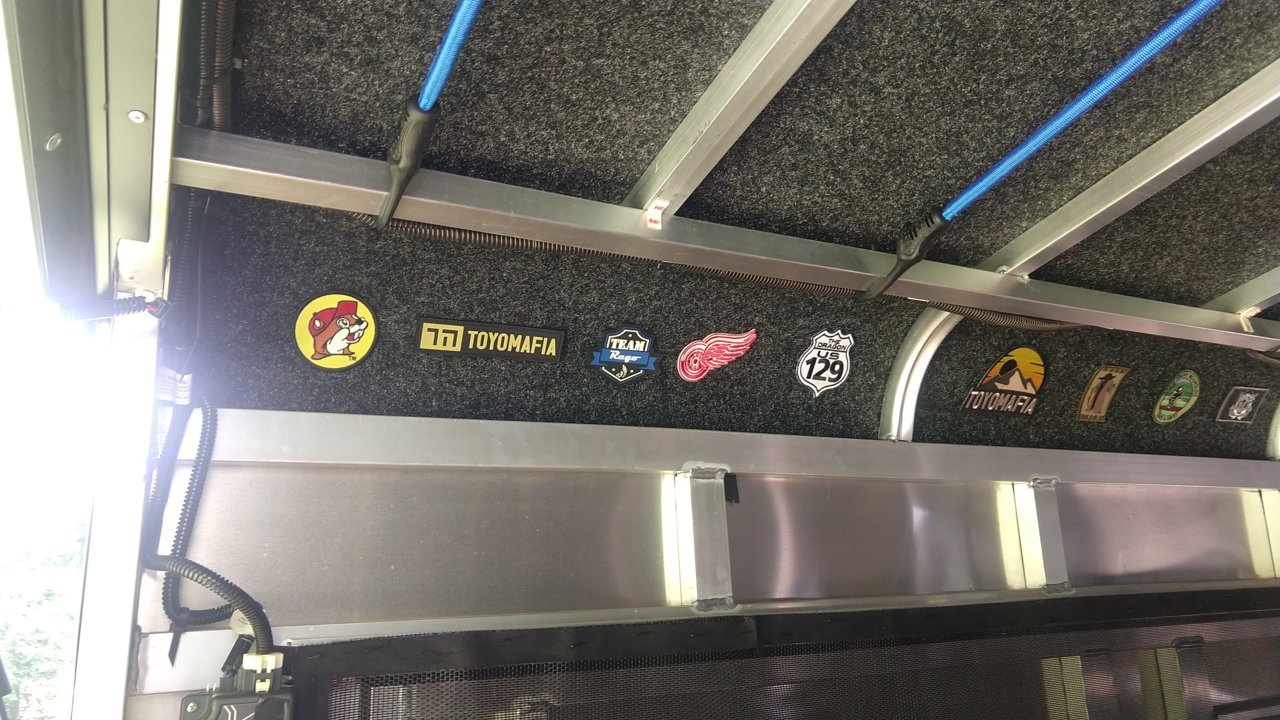

    Also added a Buc-ee's patch. If you have never been to a Buc-ee's, you are not American.:p. First time I have ever been. What a fiasco.:D
    124 gas pumps and a lot of people. If I didn't have the ZE/ZIR virus before Buc-ee's, I certainly did after. Pretty much a daily super spreader event. Had fun
