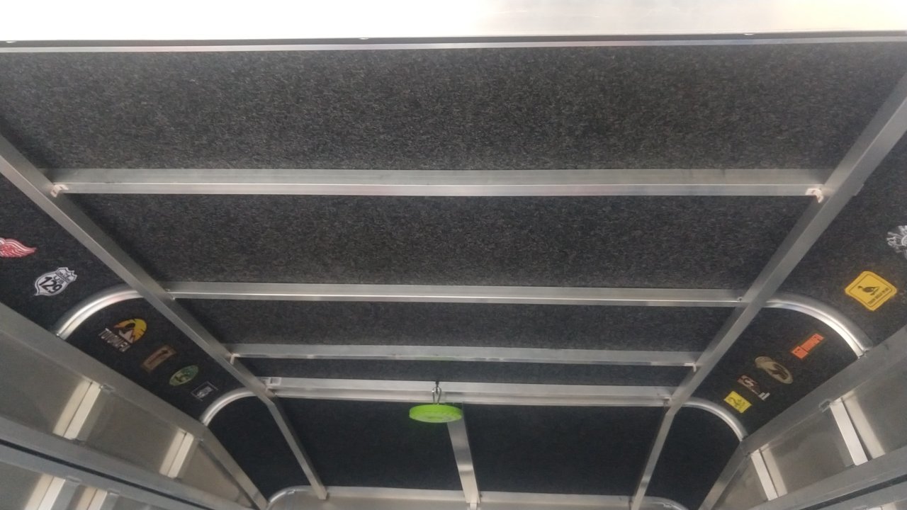

    Attached the Ironman 4x4 quick release awning mounts using 3M 4950 VHB and eternabond tape
    Mounted the solar panel the same way.
    Then ran the wires to the cab. Thank goodness they were long enough.
    Because this topper came without a rack I guess ARE saved some money on aluminum. The build quality of this very expensive top is sub par IMO. I added additional aluminum (3 bars) to stiffen things up for the solar panel. They are only taped in place at this time.
    Just got back from a 1700 mile trip and no issues, fingers crossed that continues.
