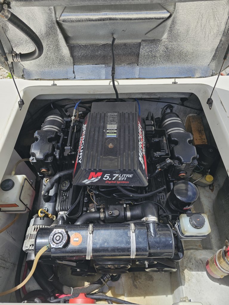

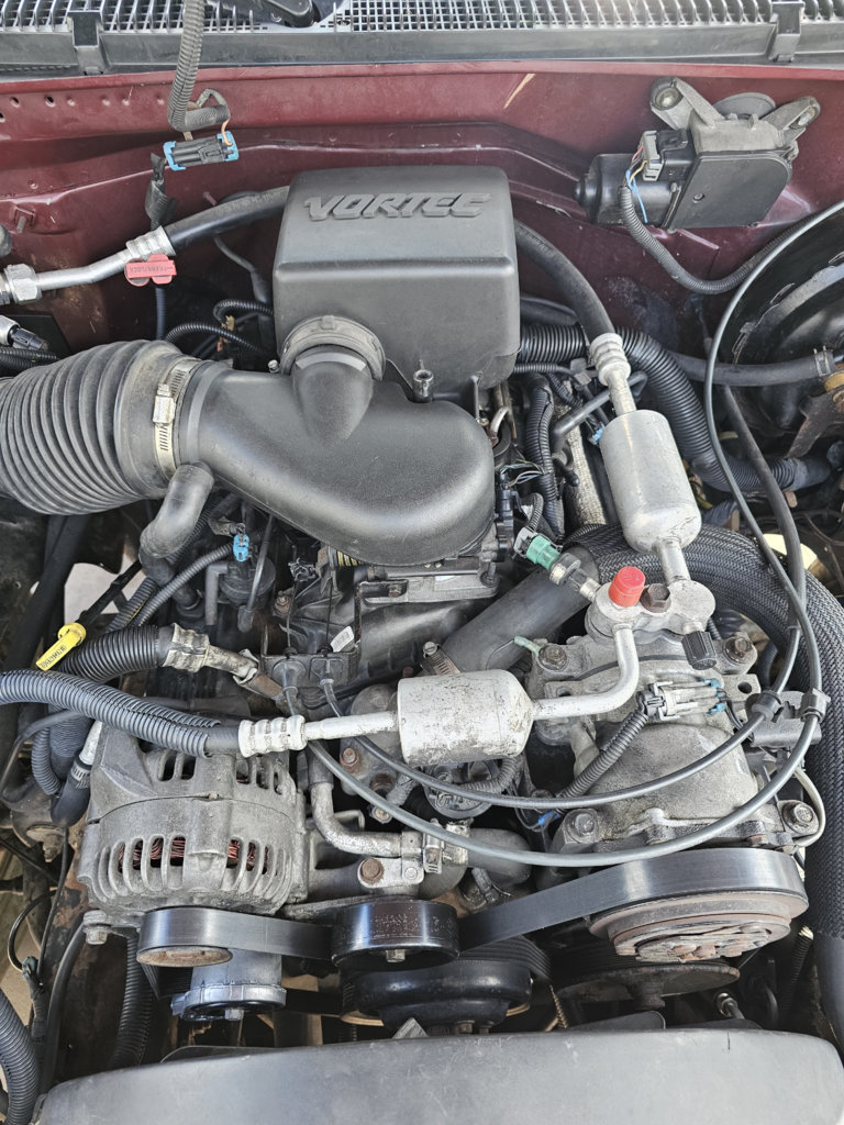

    Florida
    Not 75, but 30 years later, still running strong. And one in my boat thats 25 years old. That one is at 4+k rpm 80% of the time.
  23. Apr 5, 2025 at 9:42 AM
    #83
    BlackNBlu
    BlackNBlu Justa Member
    Dec 27, 2023
    #109152
    1,810
    Rich
    MN
    24 Limited CM 5.5 Blueprint TRD OR
    5100's, 285/75/18, Air Lift bags, bits and bobs
    Yep, good old SBC's. Hard to beat 'em.
    Sidebar: That is the wonkiest looking air intake/snorkle assembly ever.
    pursuit2550[QUOTED] likes this.
  24. Apr 5, 2025 at 10:03 AM
    #84
    pursuit2550
    pursuit2550 New Member
    Jul 29, 2020
    #50029
    2,282
    Florida
    This one has the Spider Injection system. Throttle body on top of intake manifold.
    Got reminded to turn on the boat engine. This one is regular TBI. 17438725663667259550168562787214.jpg

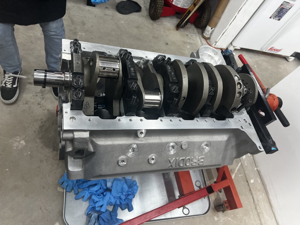

    AZBoatHauler
    Aug 13, 2019
    #34576
    9,382
    So.Arizona
    Still good for 1300hp and 1200lbs tq.
