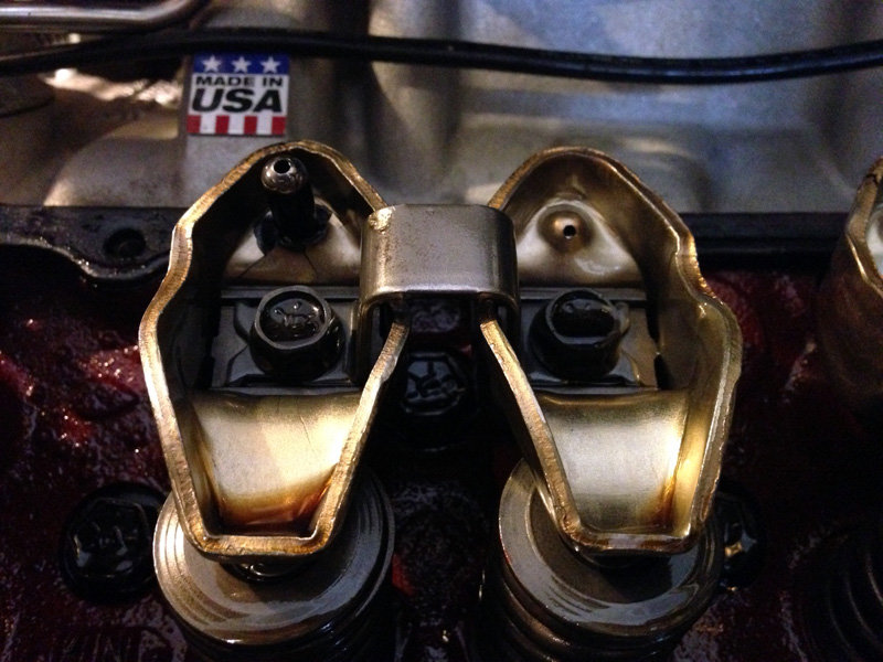

    Agree. There were some pics of Ryan’s motor and the parts you could see looked spotless.

    Which eliminated any fears of that new aluminum cradle/girdle design for me. It’s only there to speed up assembly. After those 4 bolt mains are cranked down that tight that aluminum cradle/girdle is doing nothing as far as supporting the mains.

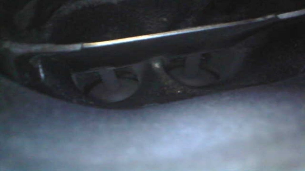

    Odd nobody is concerned with all the carbon around the valves? Even if the motor had 100k miles on it, those valves for a modern motor are pretty crusty.
  27. Mar 31, 2025 at 11:47 AM
    #57
    lapoolboy
    lapoolboy New Member
    Jan 15, 2024
    #110274
    856
    Crappy fuel quality? Short heat cycles on engine on daily commute? Not making excuses, just plausible causes?

    I would be interested to see the service records on that engine, it has always bothered me that Toyota insists on 10,000 mile oil changes. I posted that in the comments on the video.
    I thought it was a fascinating video but to many gaps in what happened to the engine and its history to draw many meaningful conclusions from it.
