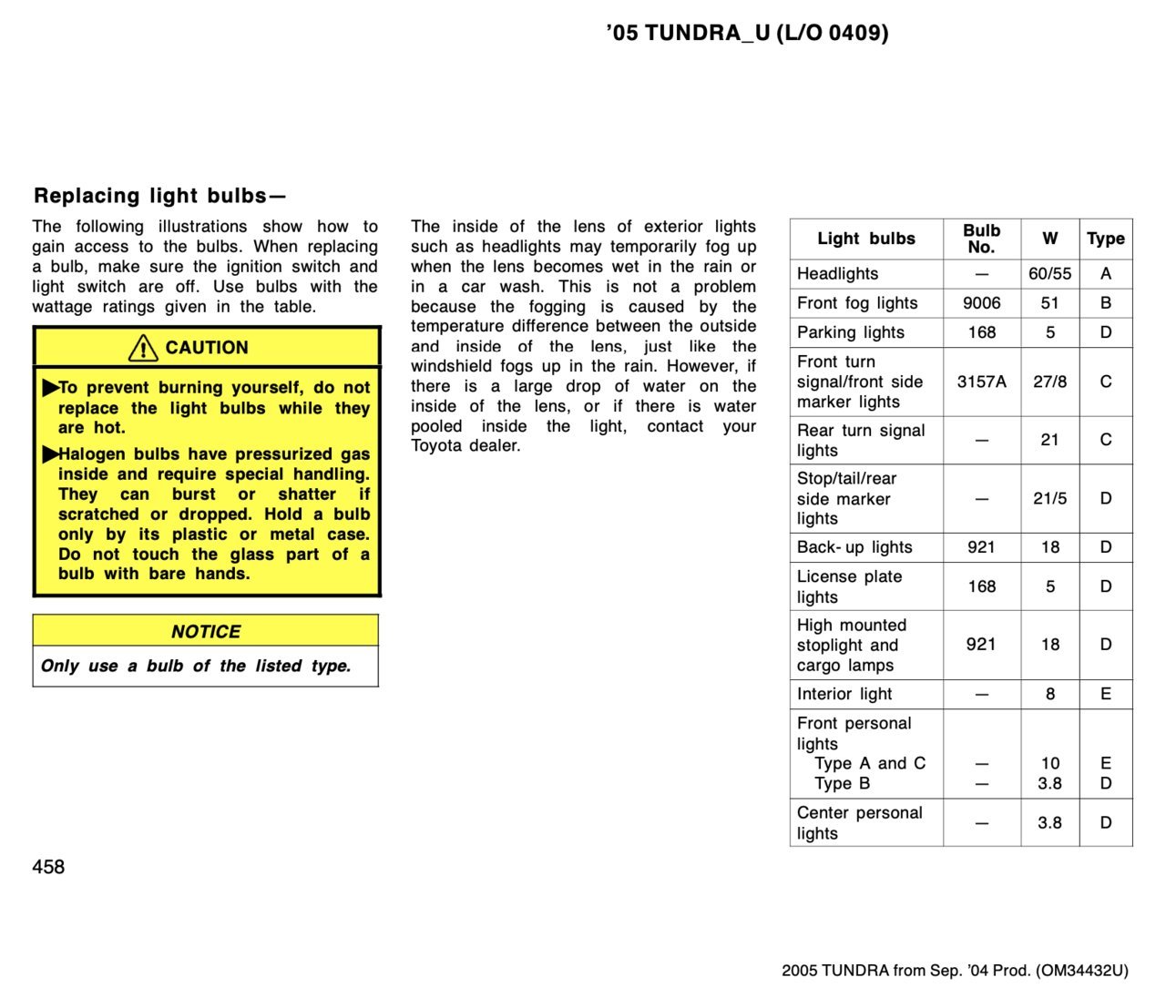

    Well if the owner's manual is to be believed the reverse lights and the cargo lamp lights are the same 921 size. Frustrating that it doesn't list a size for any of the interior lights :mad:
    If advanced auto is to be believed the 194 bulbs should fit the door lights, map lights above front seats, and room lights in the back.
