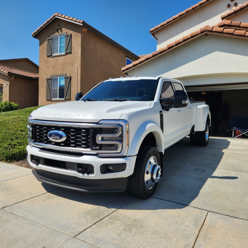

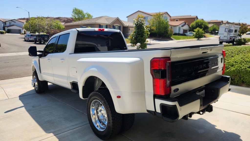

    Checking in! Still using The Truck! No changes lately, just been using it and fixing it LOL I have been concentrating on keeping it running.
    We are starting a new chapter though:
    We are keeping The Truck. Say hello to The Diesel! The plan is to put The Camper on it haha Picking up a Lance 1172 soon. First project will be batteries and solar for full off grid camping. Then Carli Dominator kit and 37s. I'll add some lights and a radio but that's probably all I am going to do to The Diesel. We have The Truck for when we want to get extreme.
    SGU Death Valley Turkey Run in Nov! Let me know if you want to tag along!
    See ya on the trail!

    That thing is gonna be sweet. Which trim level is that and which Carli you goin with?

    Its a Platinum with the high output power stroke! Such a beautiful monster LOL Gonna put the Dominator kit on with the King 3.0s. I am not overthinking this one too much. Its gonna have a 5000 lbs camper on it so I wont be doing anything crazy. I just need to lift it and put some soft shocks on that will actually control 14k combined weight.
    If I drop the camper I could potentially run The Diesel hard, but the leafs will be the limiting factor. Have to run the stock leafs because there arent any better options out there unless I want The Camper to be mounted full-time

    I almost thought you got the F-450 with that wheel/tire package. When you mentioned the HO motor I realized it was a 350.
    Do some research on a CP4 bypass system....400.00 can save 14000.00.

    Hahaha it's a F450 Platinum with HO diesel. Those are the wheels that come with it

    Oh damn! Ford finally didn't derate the 450. That is great to hear.

    I dont have a flatbed yet, but thats the reason I went with the F450. Bumper tow for my configuration is 30k lbs. F350 has taller gears but is close with 28k. F350 actually beats the 450 on payload, 5850 vs 5303 for mine. But that is because the F450 weighs more. GVWR is the same for both trucks at 14k lbs.
    The REAL story is that the F450 is derated to avoid commercial stickers in some states. There is a reason it weighs more than the 350. It has bigger axles, shorter gears, HUGE brakes, and commercial wheels / tires. The turning radius is wild, way tighter than the other super duties.
    but yeah, I am going to live in the camper part time during the week while I work since I dont want to buy a home in SD haha
