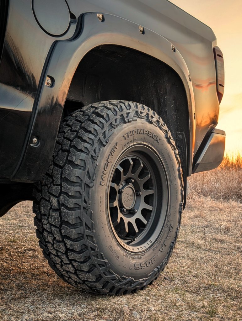

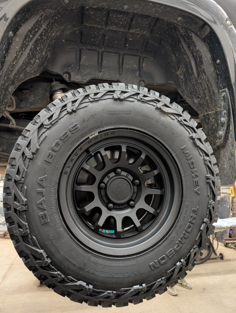

    New wheel day.
    255/85r17 Mickey Thompson Baja Boss a/t (35x10)
    Black rhino rapid 17x8.5, +10

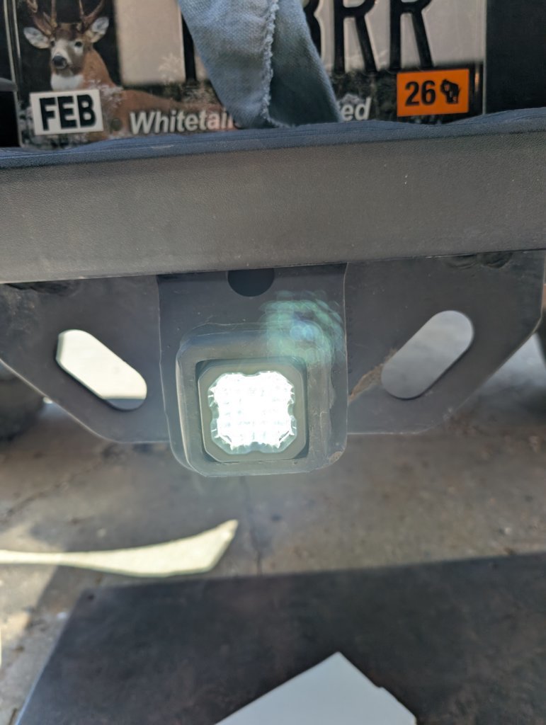

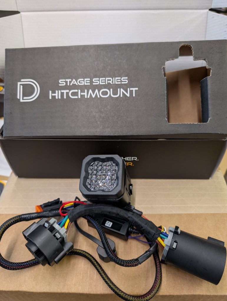

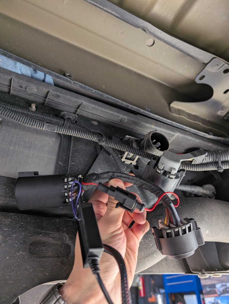

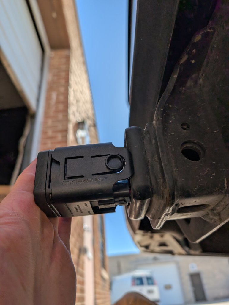

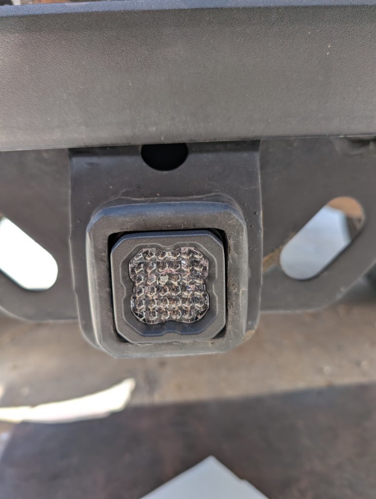

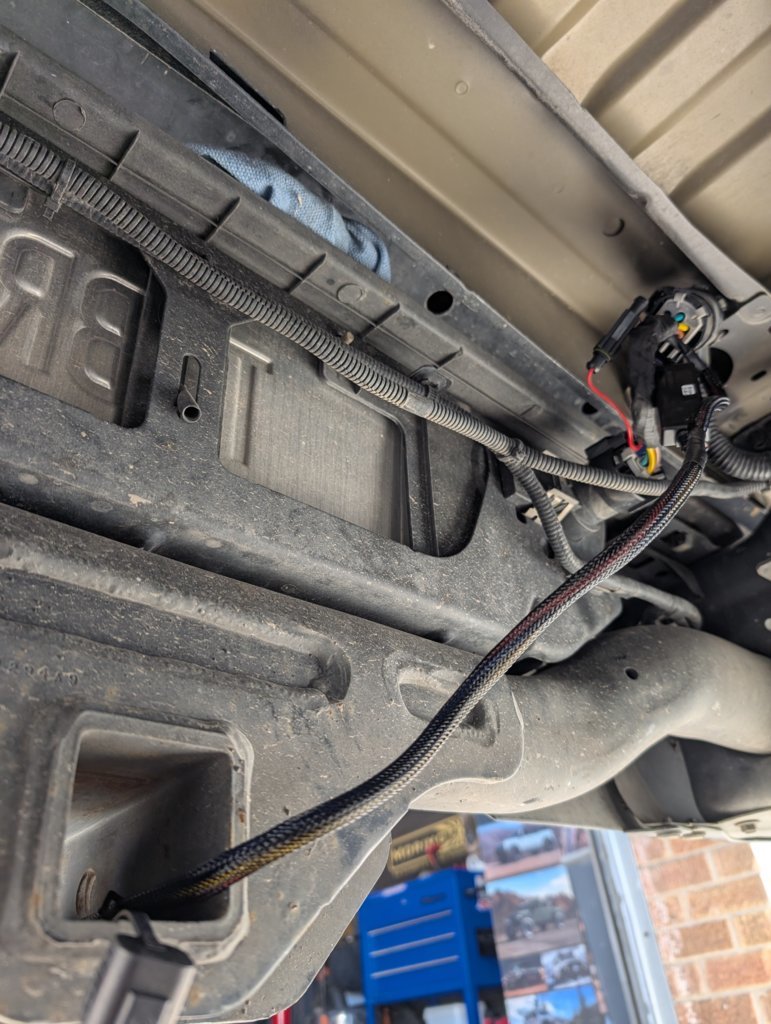

    Installed the lovely little Diode Dynamics Hitchmount Pod (C1R). Cool little unit that takes all of about 5 minutes to install, Inline with the 7 pin trailer wiring. Red running light, hot red brake, and bright white reverse assist light. Easily removed when needing access to the hitch receiver. Pretty awesome!

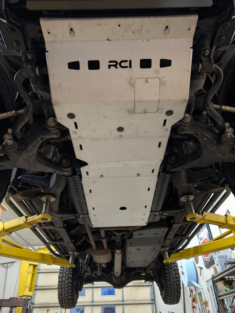

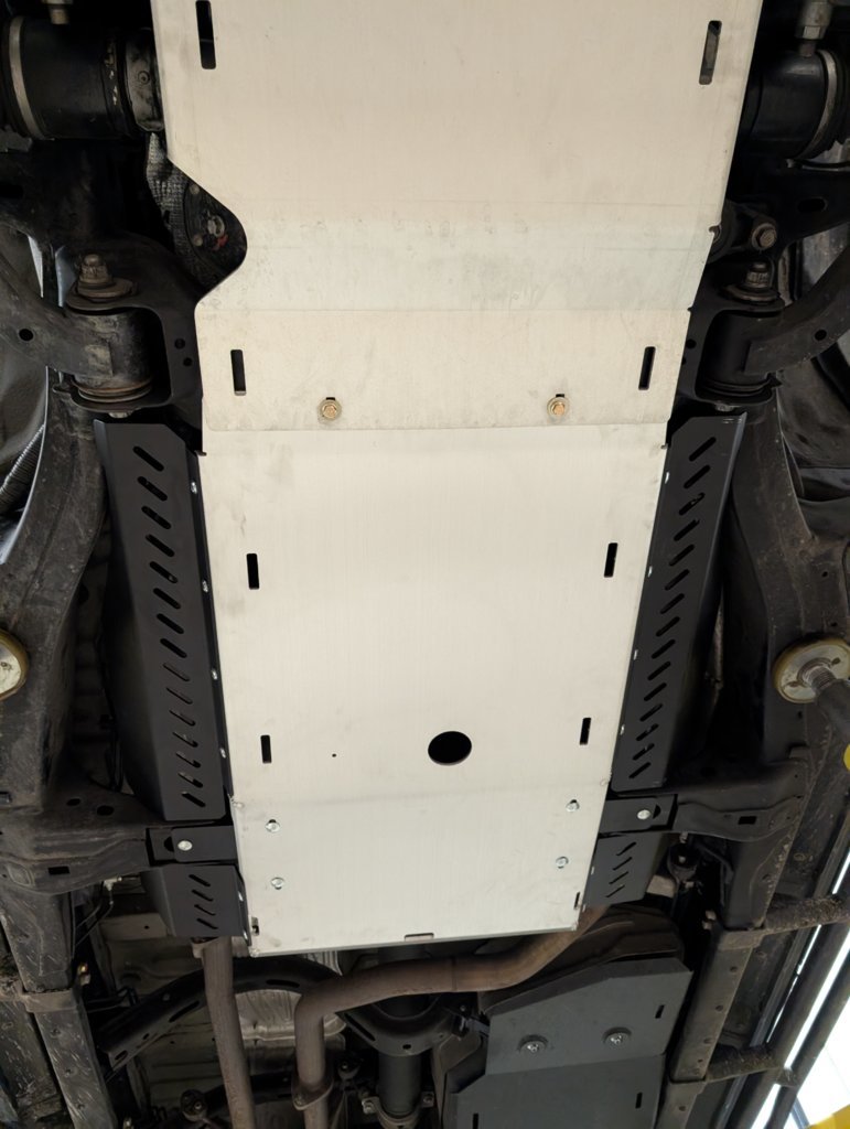

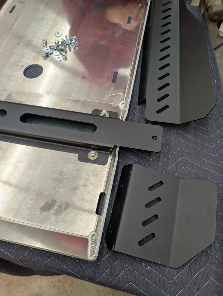

    Installed the RCI Transmission skid and Cat shield today. Fitment was spot on and installation went smoothly... Loving it.

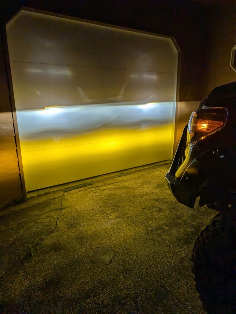

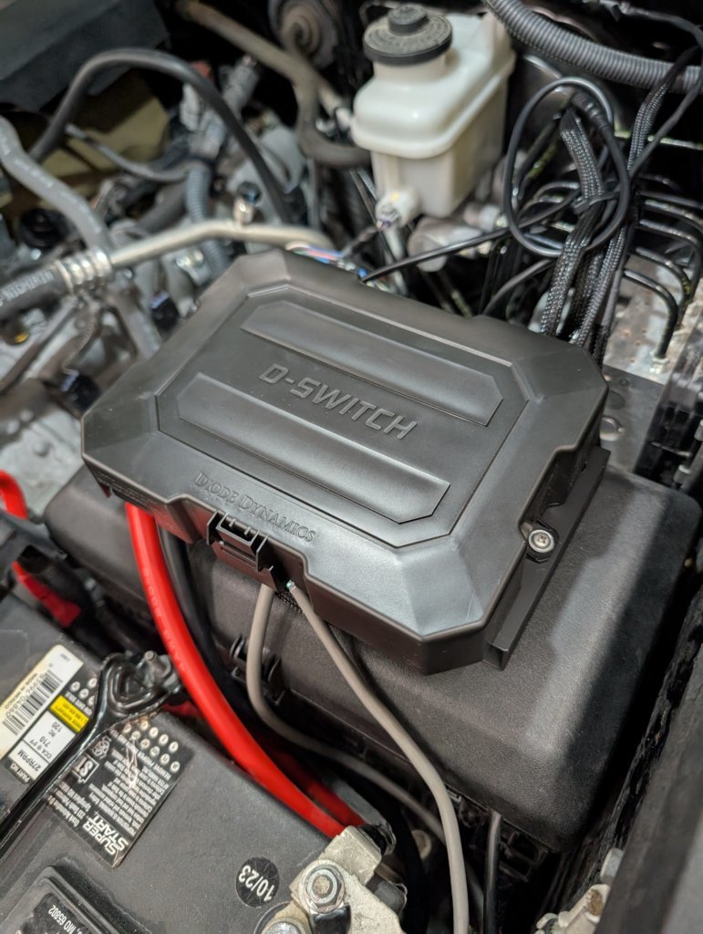

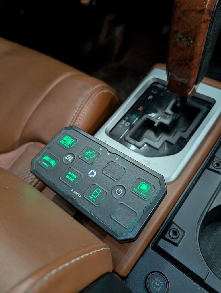

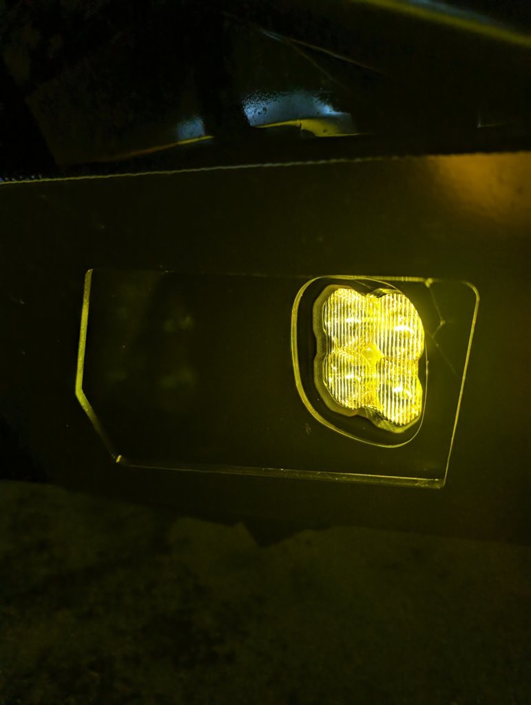

    Wrapping up phase 1 of the install of the Diode Dynamics D-Switch (and just hit 100k).
    Super impressed with this thing.
    Hooked up my new set of Diode SS3 Pro SAE Fogs, and the Morimoto 2 Banger ditch lights. I have the input sensor wires to ignition and side markers (for night mode). That way I can run backlight on the fogs as a secondary drl, and have anytime fogs at night through lo and hi beam. So many integration options!
    Mounted the controller behind the shift knob through the 1794 leather panel. That way, with the hand on the console rest, it's easy to control buttons and it's using dead space. Would highly recommend!

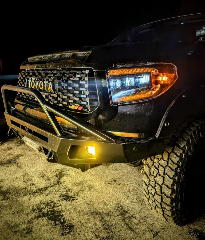

    Front end

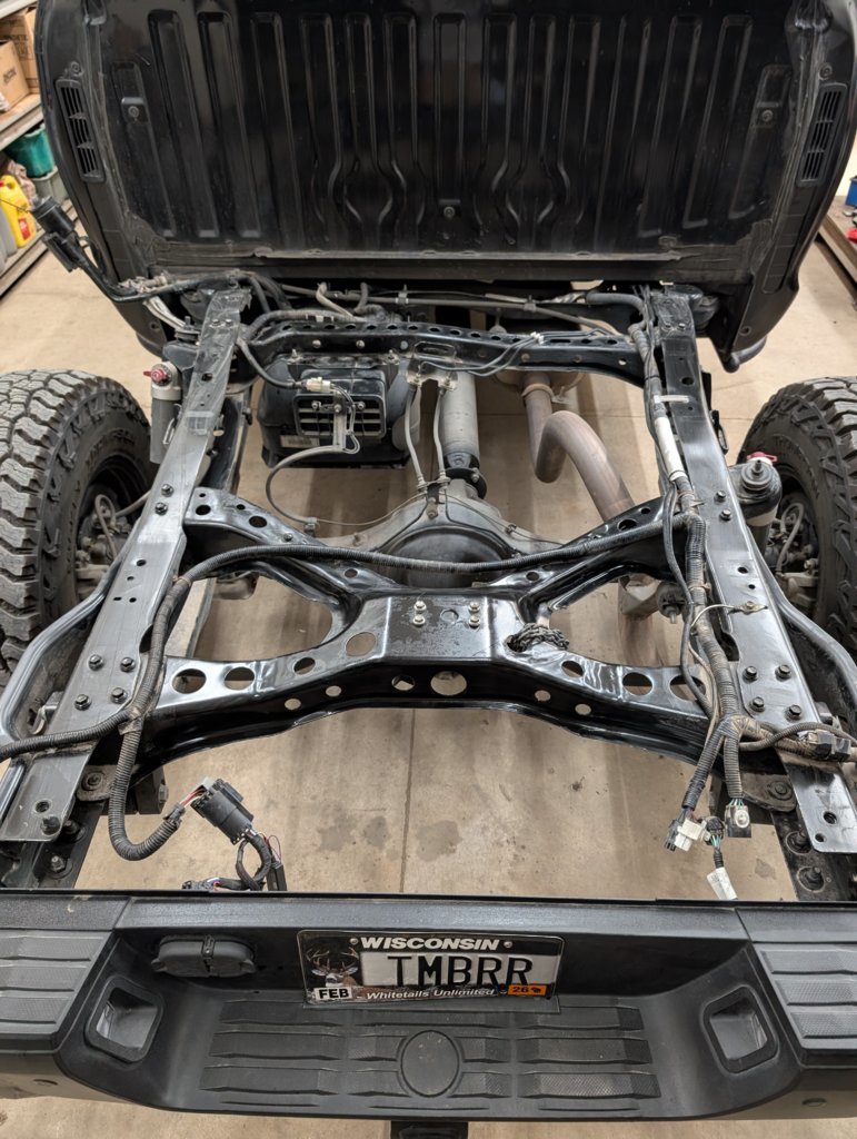

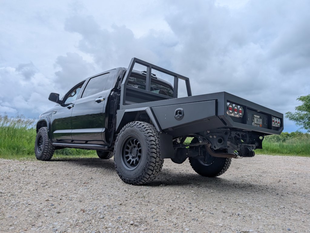

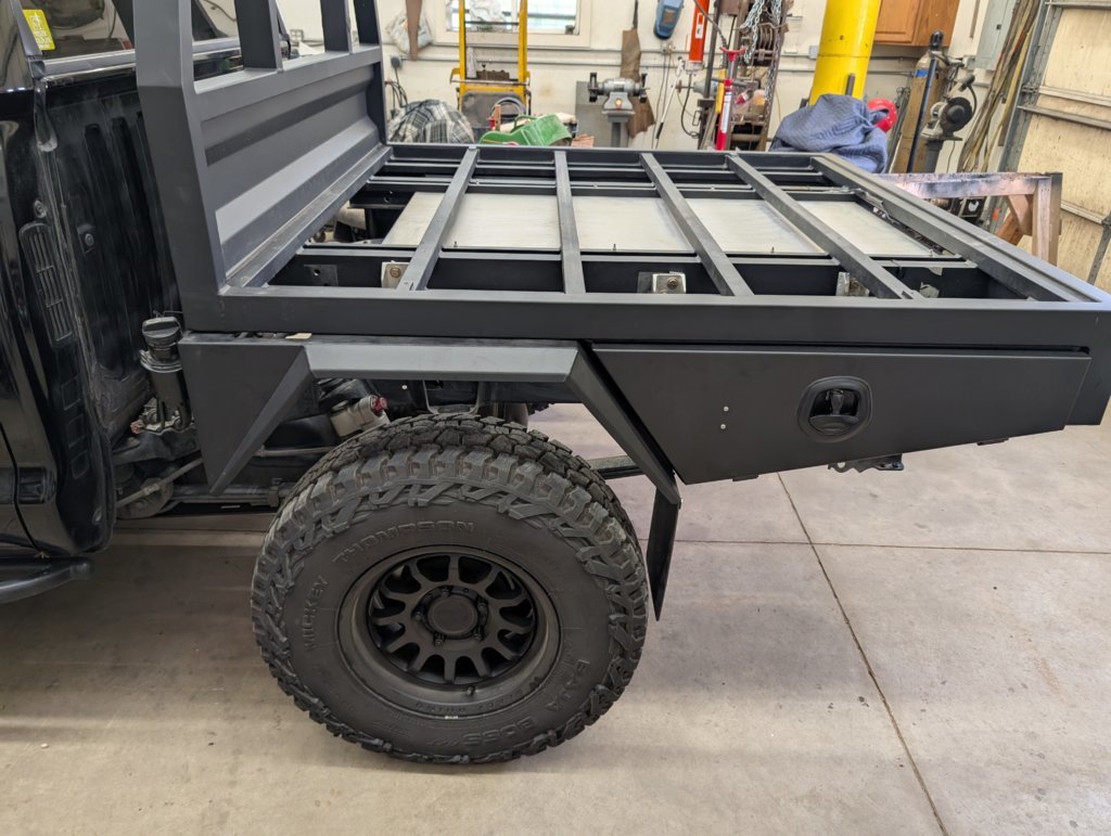

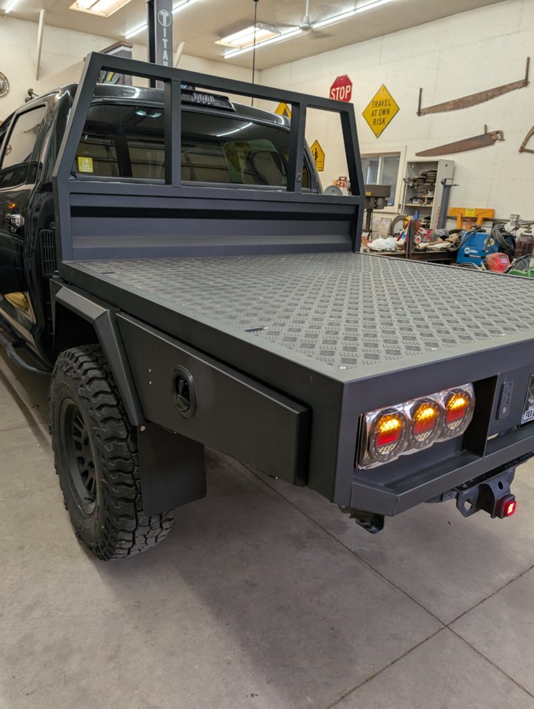

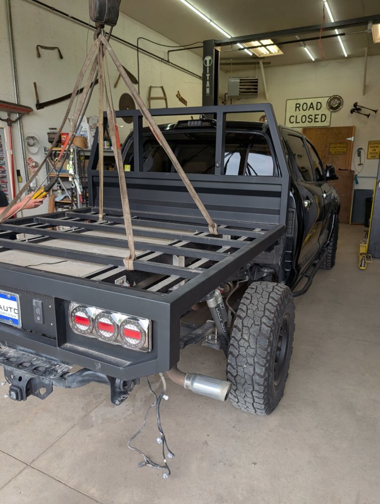

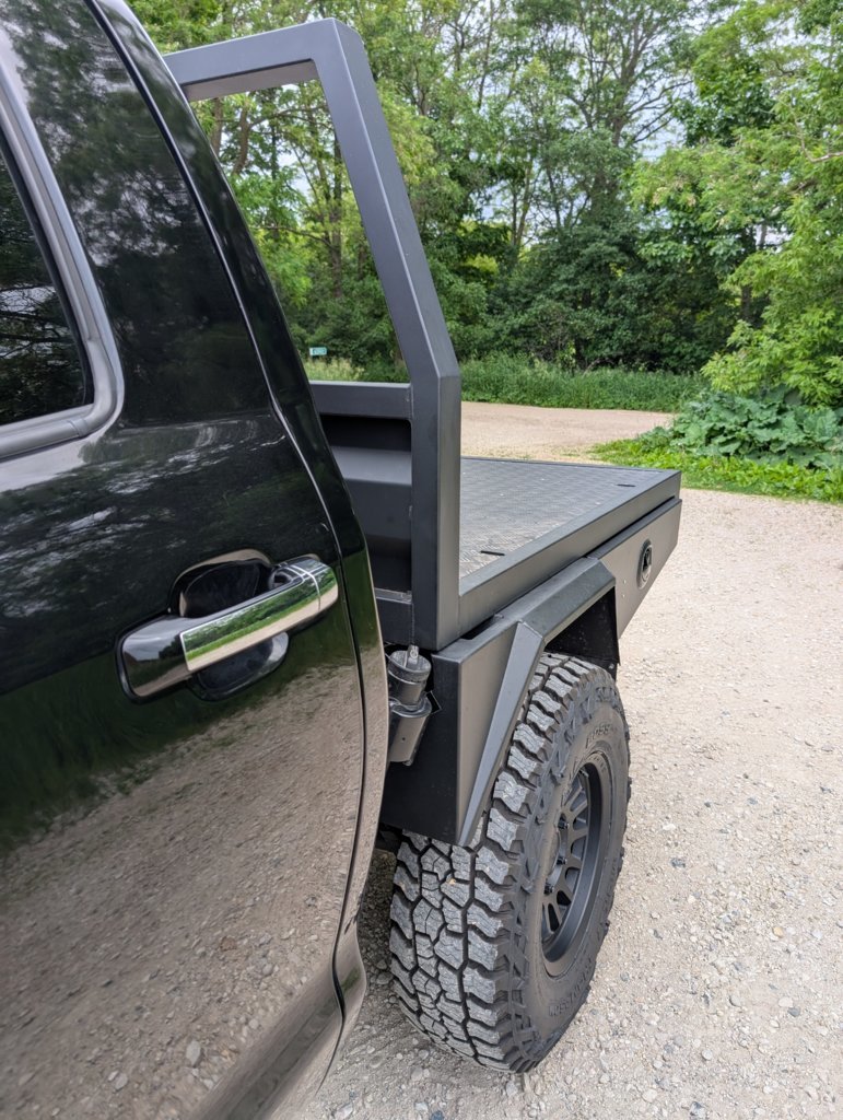

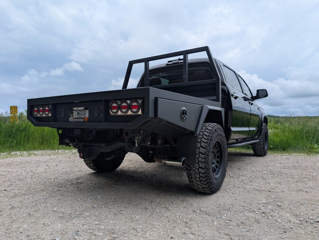

    It's been a productive last few weeks. Flatbed is on!
    Picked up a Altra Fabrications aluminum tray, originally designed for a Tacoma. Modified the mounting feet to fit to the Tundra frame, to accommodate the extra width and frame curvature. Due to the difference in wheelbase, I am left with a 8" gap between the headache rack and cab - perfect for more storage down the road. I'll be building something to fill that gap next!

    All aluminum construction with stainless hardware. Wisconsin winters - bring it on.

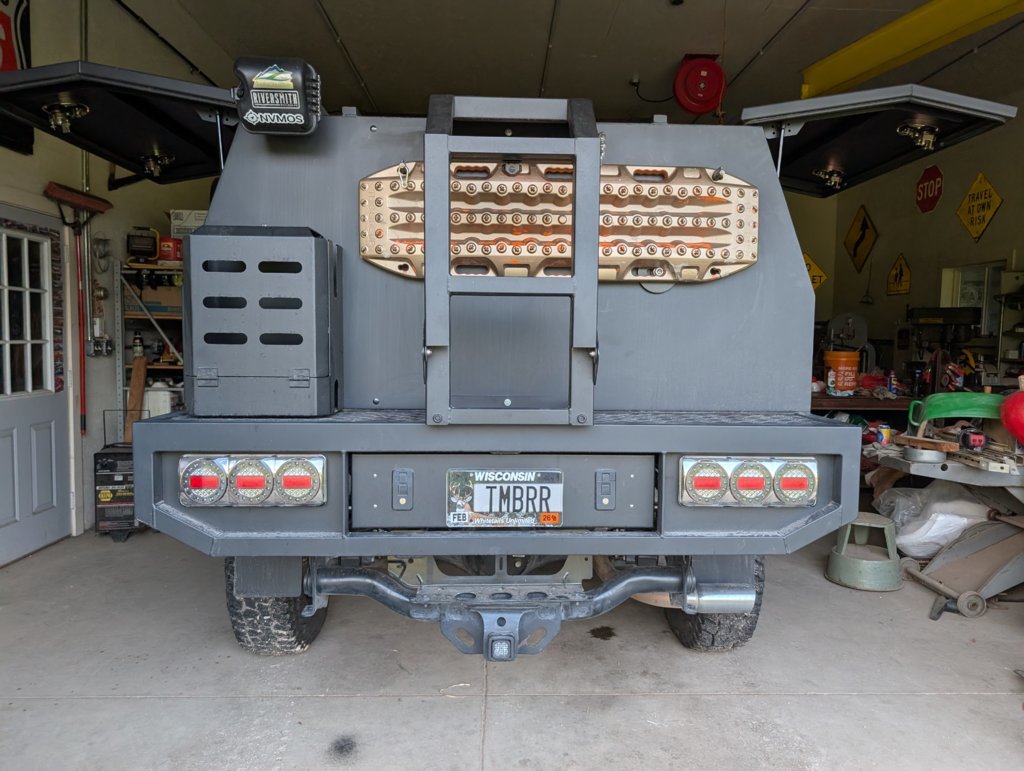

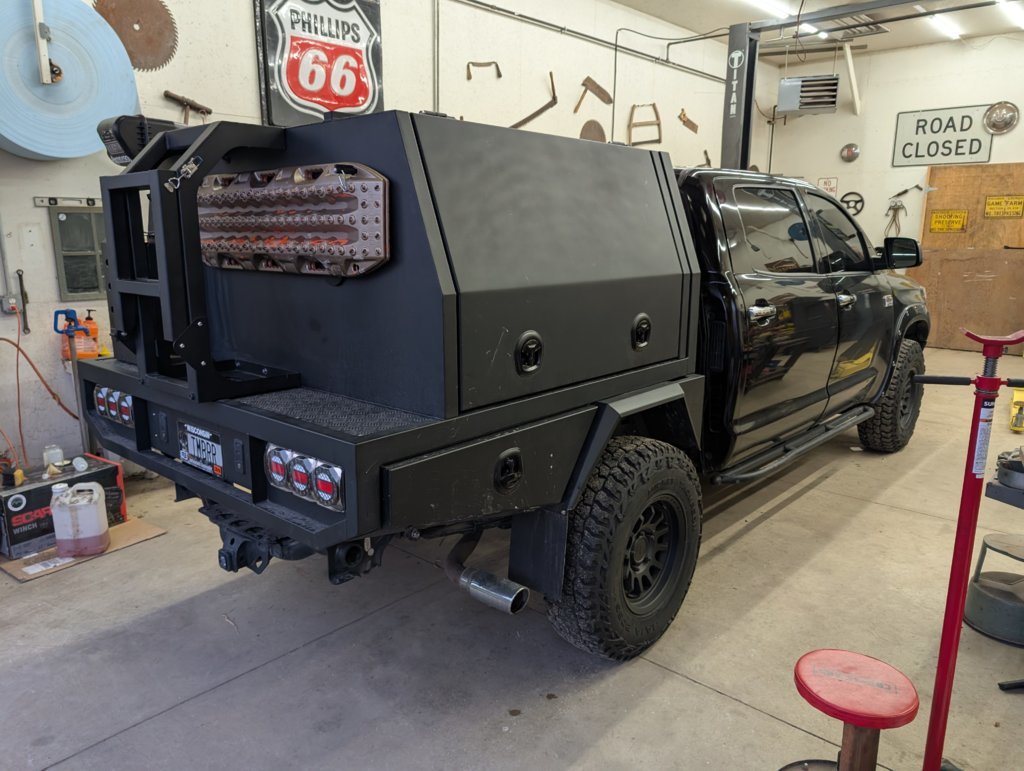

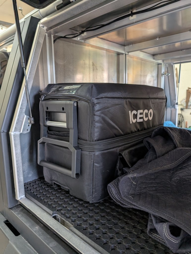

    3/4 all-aluminum canopy is on and modified to suit!
    -folding ladder
    -Jerry can cage
    -gull Wing doors
    -Wolfbox G900 Pro digital rearview
    -unistrut rack and internal mounting system
    -Iceco. JP40 Pro fridge controlled by diode dynamics D-Switch
    -Maxtrax studs on the rear
    -Riversmith fly rod Carrier
    PXL_20250707_013858921.jpg PXL_20250707_003824914.jpg PXL_20250706_224803648.jpg
    BreyTundy likes this.

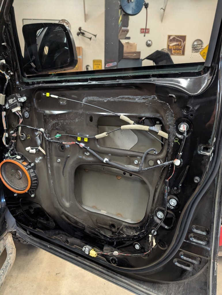

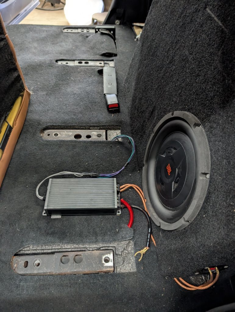

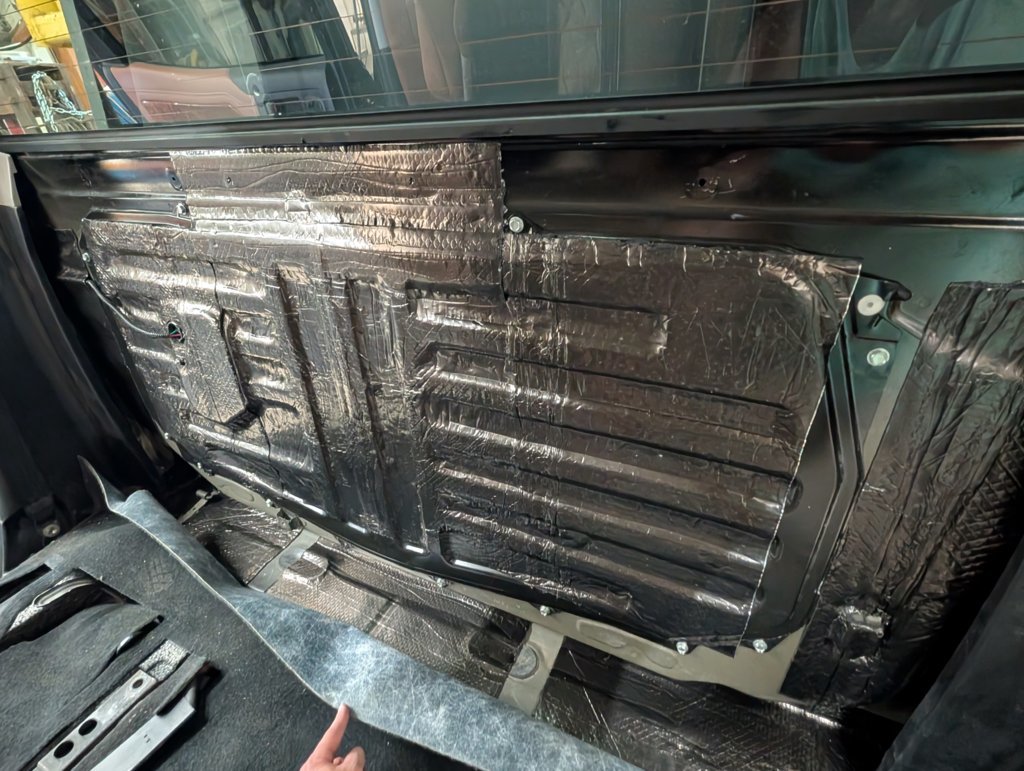

    Audio day!

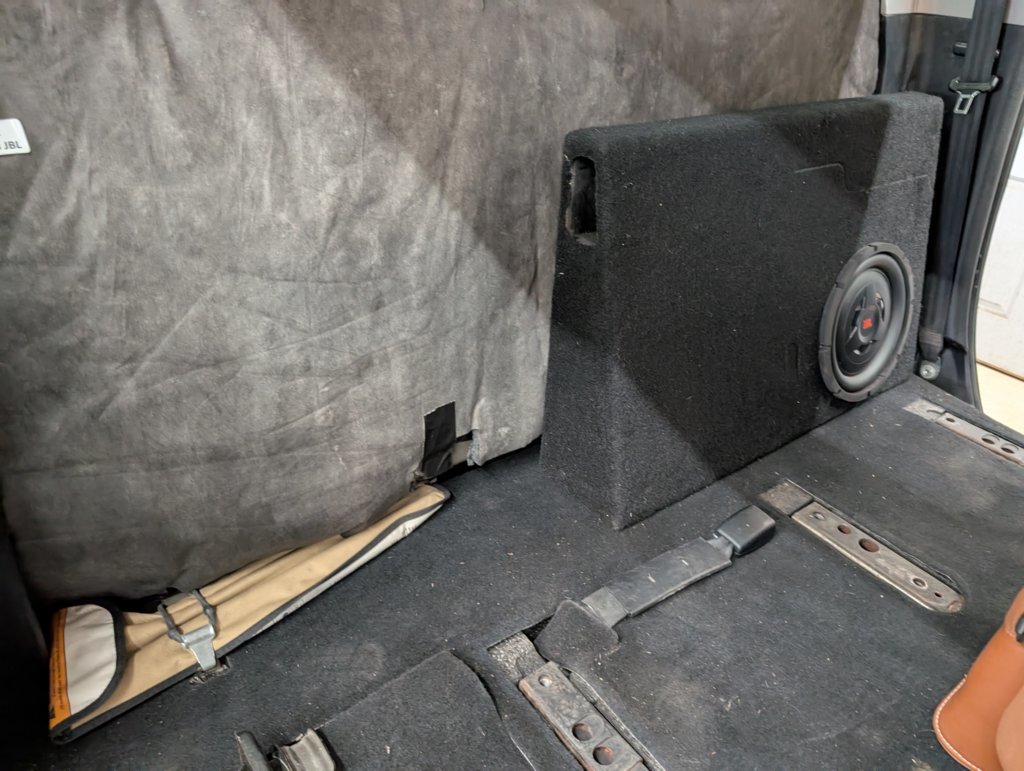

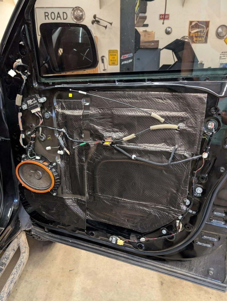

    Removed the factory JBL sub enclosure to install the Tech12Volts ported 10" Sub box. Also wired in the Kicker Key500 JBL amp. Used 90mil Smartmat sound deadener material on the back cab wall and two front doors. 30 sq ft just covered about 75% of the surfaces.
    MASSIVE DIFFERENCE in audio performance, bass quality, range, etc.
    May buy another pack of deadener for rear doors. But wow, what an upgrade.

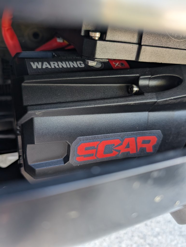

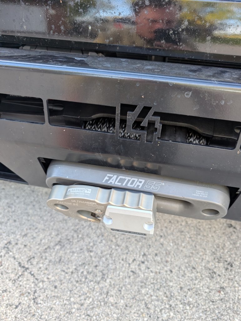

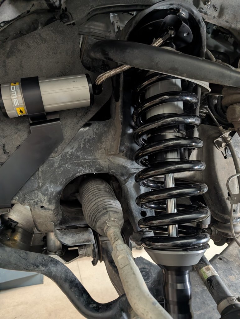

    AJ
    New suspension day at 104k! Threw in a set of ARB BP-51s to combat that extra weight of the winch and bumper up front. So far I'm very pleased with the ride and support. Set to 5 comp and 7 rebound setting to start. SCAR 12k synthetic winch is in, looks pretty nice finished off with a Factory Ultrahook.
