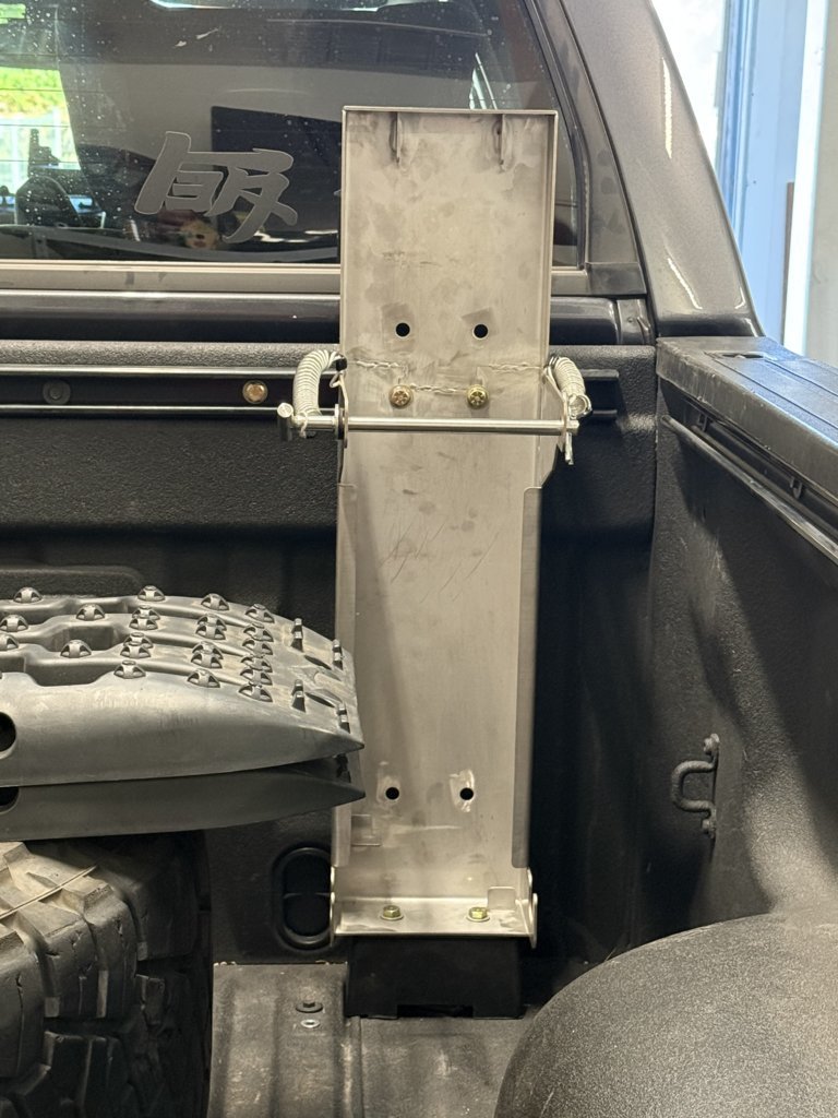

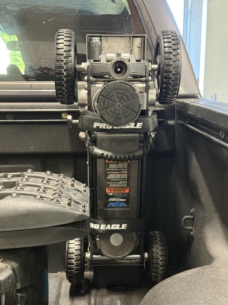

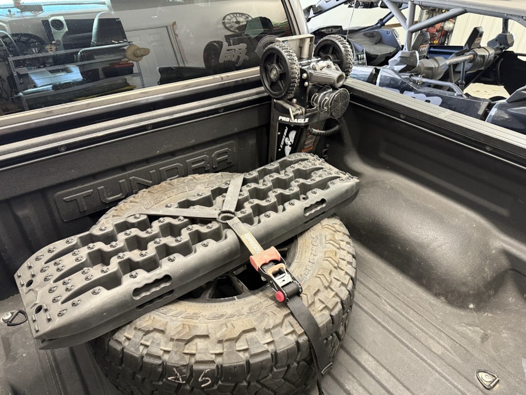

    Had a little down time yesterday and today to install some shelfware - Pro Eagle mount is mounted and the Beast has a home on the truck.
    The lower end of the mount is supported by a rubber block (a loading dock bumper) that is thru-bolted into the bed. The back is on the bed rail, with 2 extra 3/8” grade 8 bolts holding the rail to the bed wall.
    Should be ready to see if it stays put or gets launched into low orbit this weekend, if schedules allow.

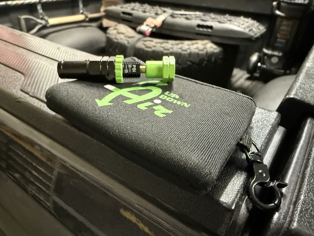

    These little guys showed up with a pile of things from UPS today. I had forgotten that @memario1214 told me about them when he was in town a while back and ordered them with my winch. I’m hoping they work well, since they have pressure settings on the side of the stem and would make it way easier to dial the pressure based on the terrain.

    Ah! I randomly saw a product like that on Amazon but didn't click in to it so I didn't realize what it was.
    Those look nicer than what I saw. Thanks for sharing

    They’re a nice product. OVS makes them and Colton carries them, but he’s a slacker and they’re not on his website

    I'm hoping they do well. I have some off-brand coyote-style clip on auto deflators already, but changing the pressure on the fly would be nice.

    If the adjuster is accurate they should be nice, my staun ones hold pretty true but aren’t easily adjustable

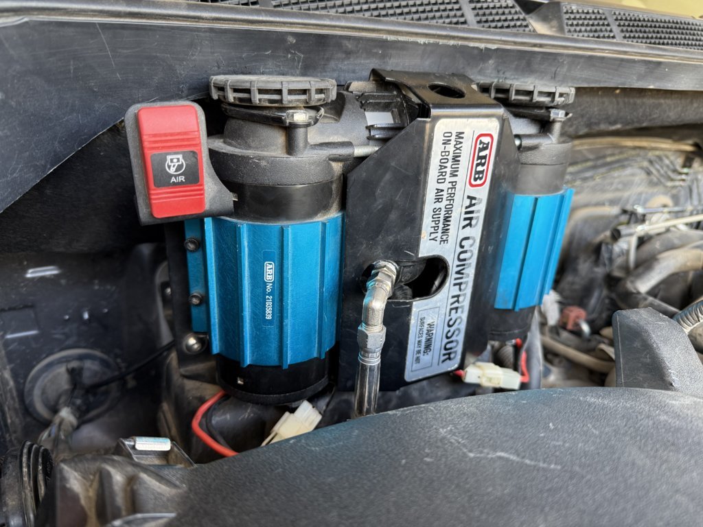

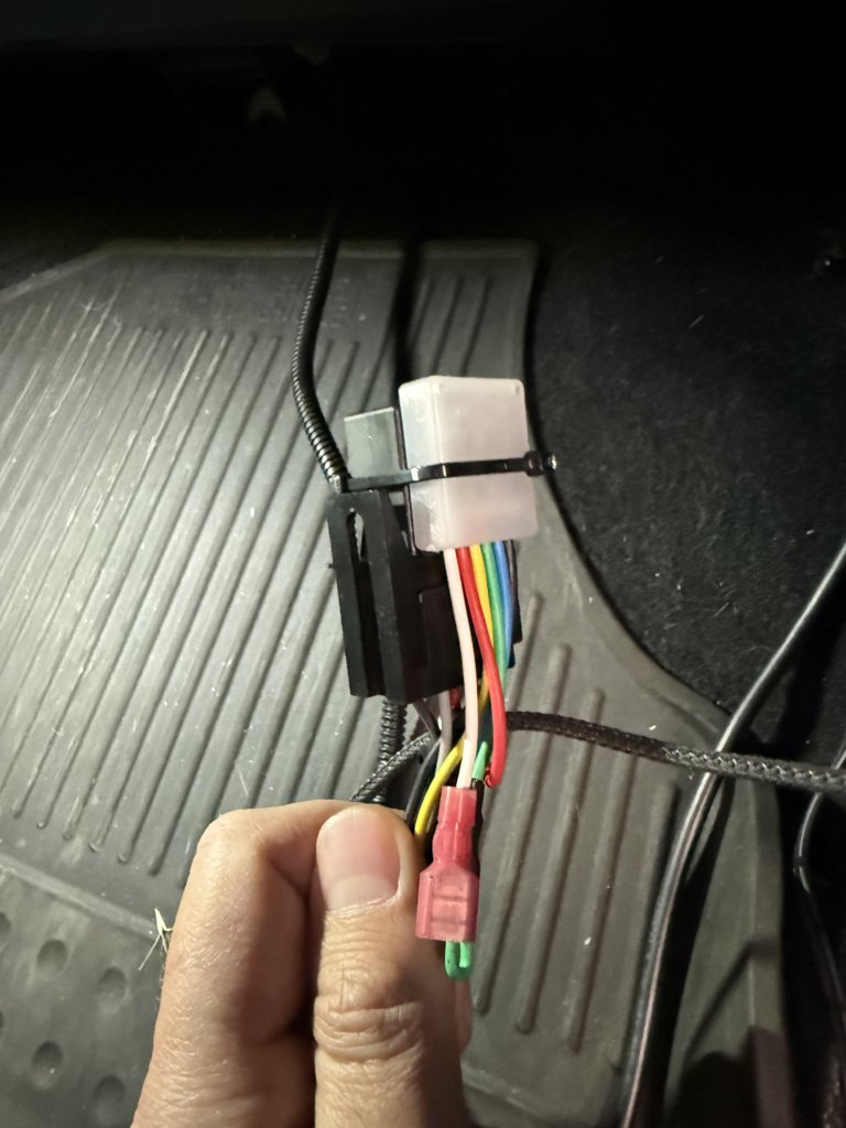

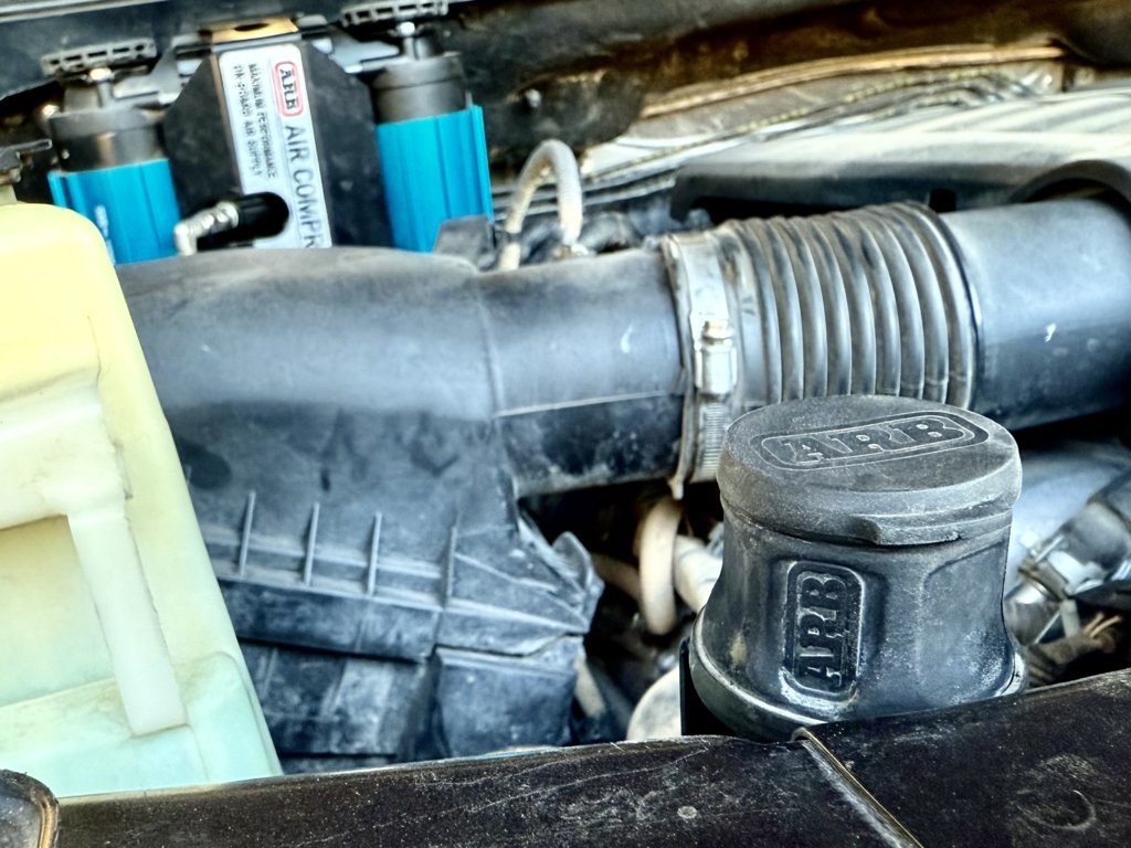

    Staying true to my method of redoing everything on my truck multiple times, I scored an ARB Dual setup from @BiggHertz and got that install wrapped up today.
    The setup includes a momentary press switch that activates a timer and self-latching relay circuit that lets the compressor run for 20 minutes or until accessory power is turned off. More details in Jason’s build thread here
    This new setup will definitely cut into my trail beer nightcap time, but that’s okay.

    Updated the jack mount support to use a 3x3x6 square steel tube instead of the rubber block. It was notched for the bed rib and bed bolt, and now allows for the removal of the mount itself, leaving just the support bracket in the bed.
    Maybe someday I'll repair the failed rivnut holes I tried using for the unijack mount...
