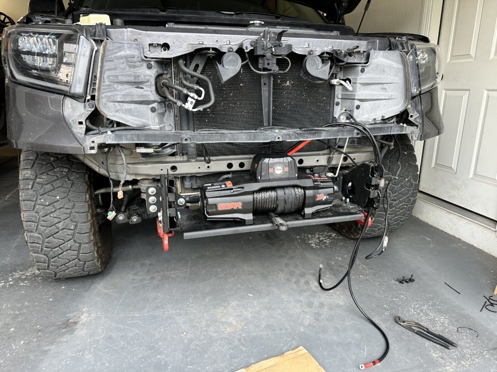

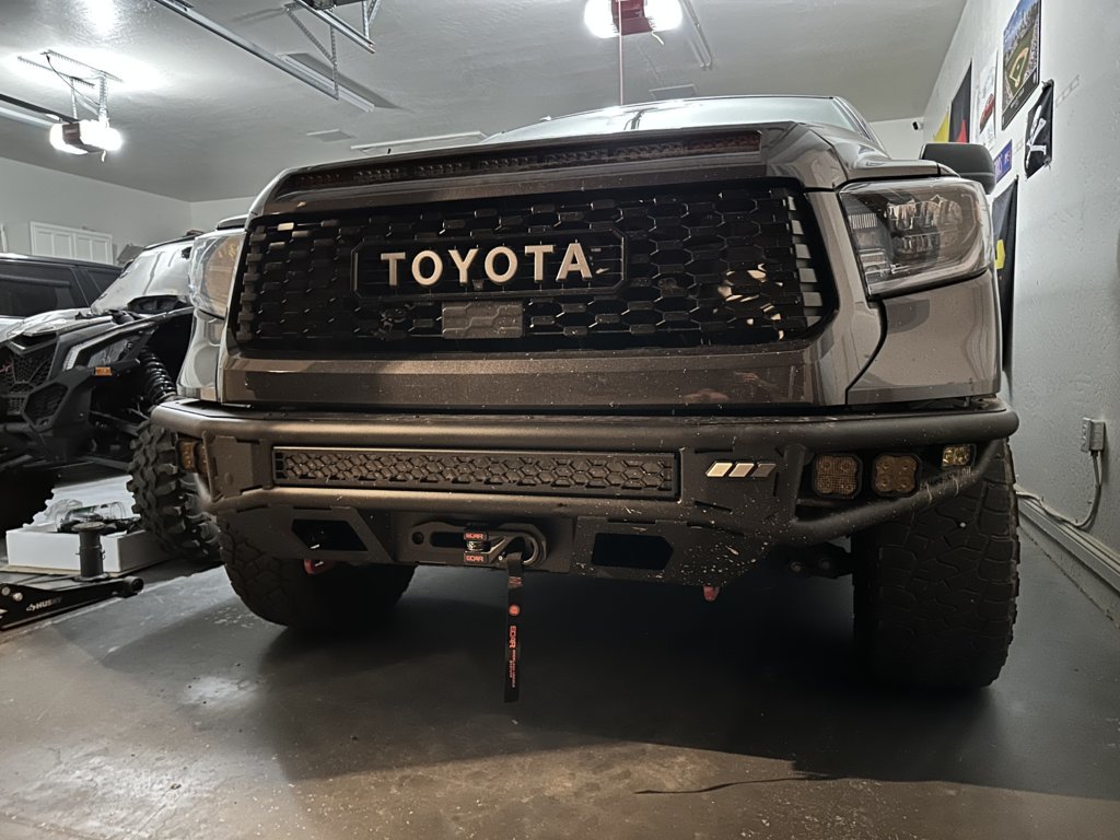

    Installed an OVS Scar 12s winch from Hotshot Offroad yesterday/last night. Seems like a good quality product, especially at the price point of sub $600. It’s definitely a tight fit with the OEM transmission cooler, but a little shimming and shoving got me the clearance I needed.

    What change did you get in the front end after install? Not sure what you have for the front end shocks but curious

    It was already sitting a little low and is on the docket for a fix shortly, so I didn’t bother to take measurements before and after. Once I added the front bumper, the Icon 2.5s were holding the front a little lower than I wanted. Heavier coils are en route from @memario1214 and should get me squared away.

    Heavier coils fr an Icon lift?? I have been on Icon for a while now trying to get a stiffer spring up front but they said that is not an option they provide. Talking to others I was told that springs have broken after replaced on the Icons’. I asked what the cause was and never got a good answer.
    Very interested in this and disappointed I could not find the info I have been looking for

    Apparently they don’t offer a heavier spring, but Eibachs work just fine. Colton did the napkin math and the 650# 3” lift springs should do the job for me.
