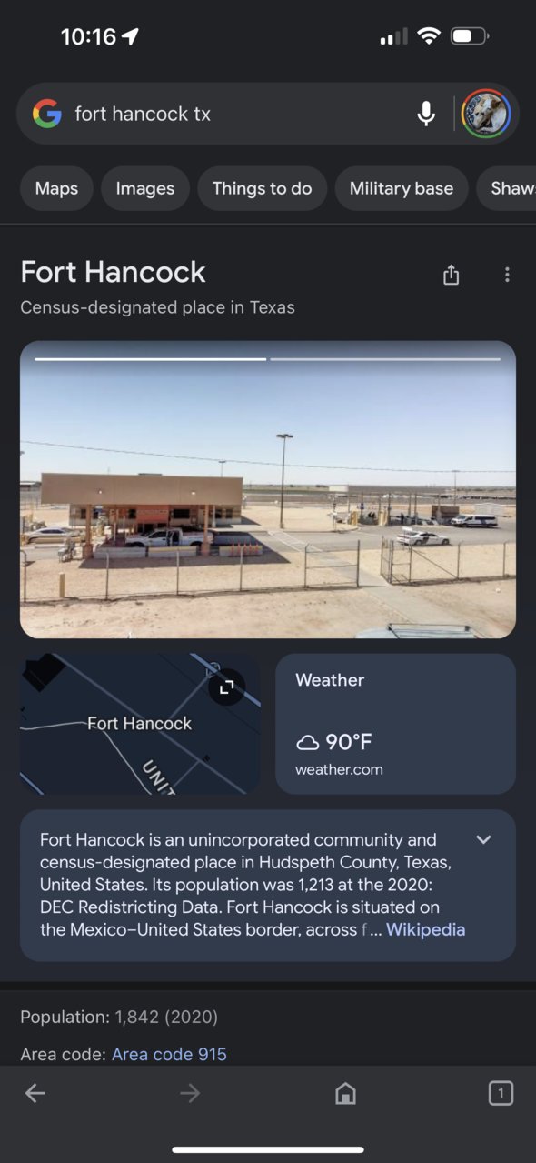

    Google makes it seem like a sprawling metropolis, where the women instinctively flock like the salmon of Capistrano

    Population 1,213! That's a bustling town for sure! Just one of the five high schools in Mesa has 3 times the population in students!

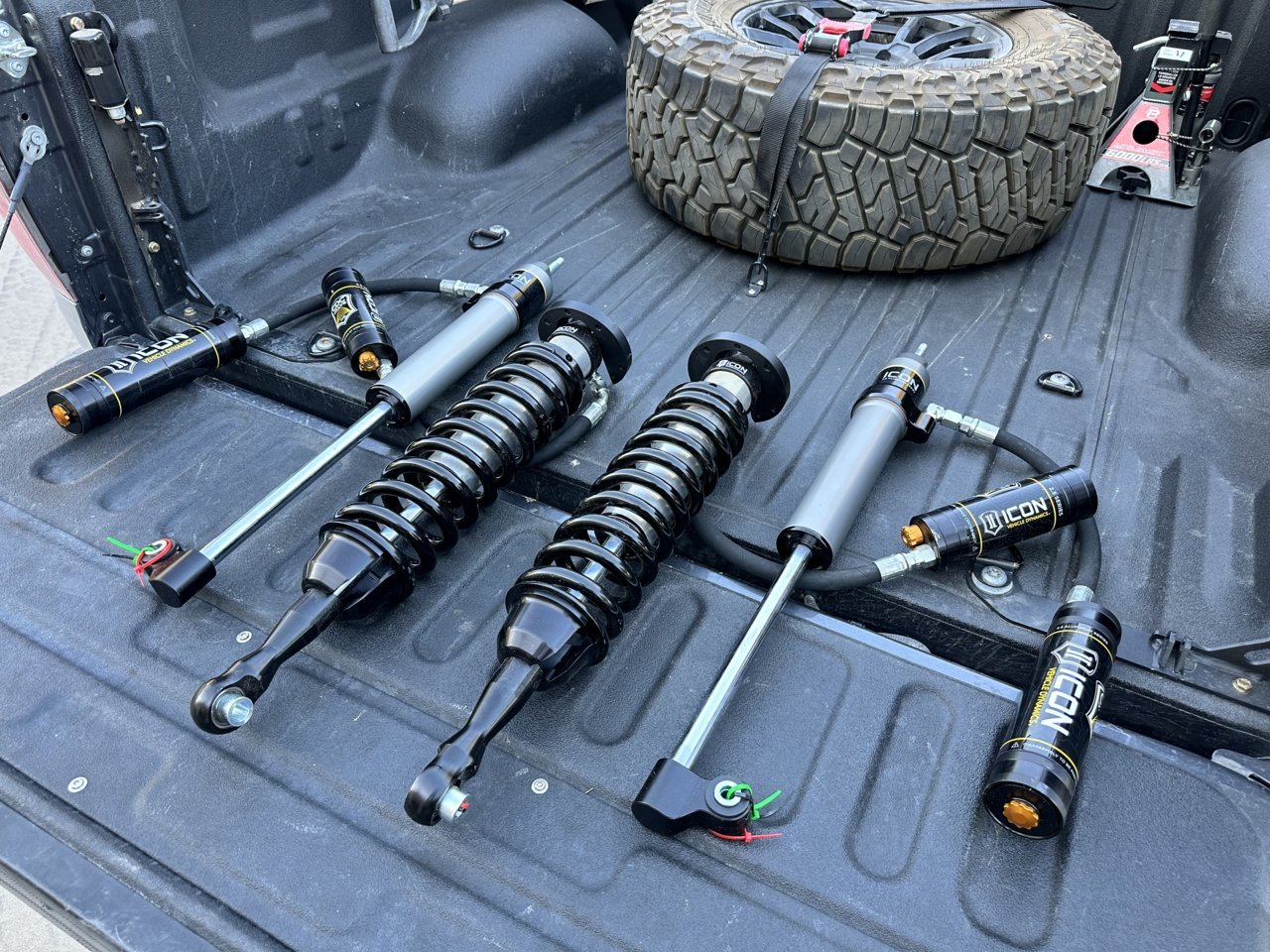

    Soon…

    Hopefully starting on it tomorrow morning, but we'll see. I don't know what plans the wife has.

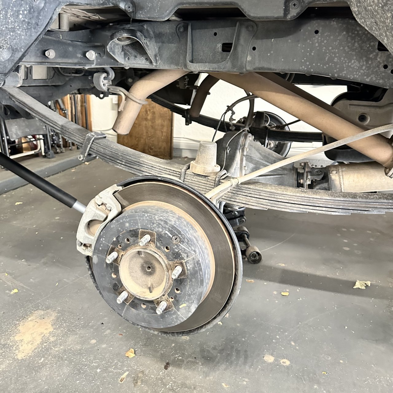

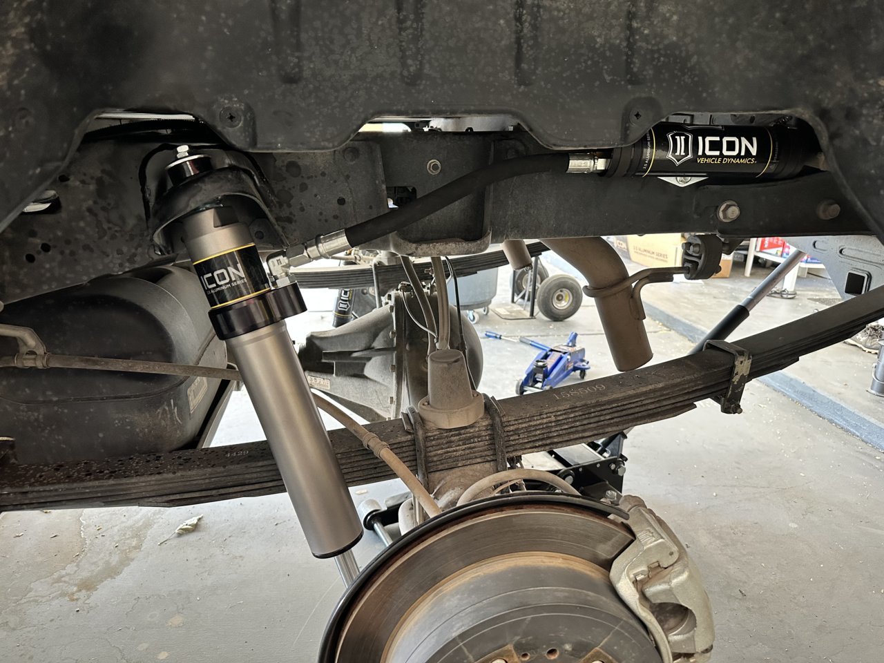

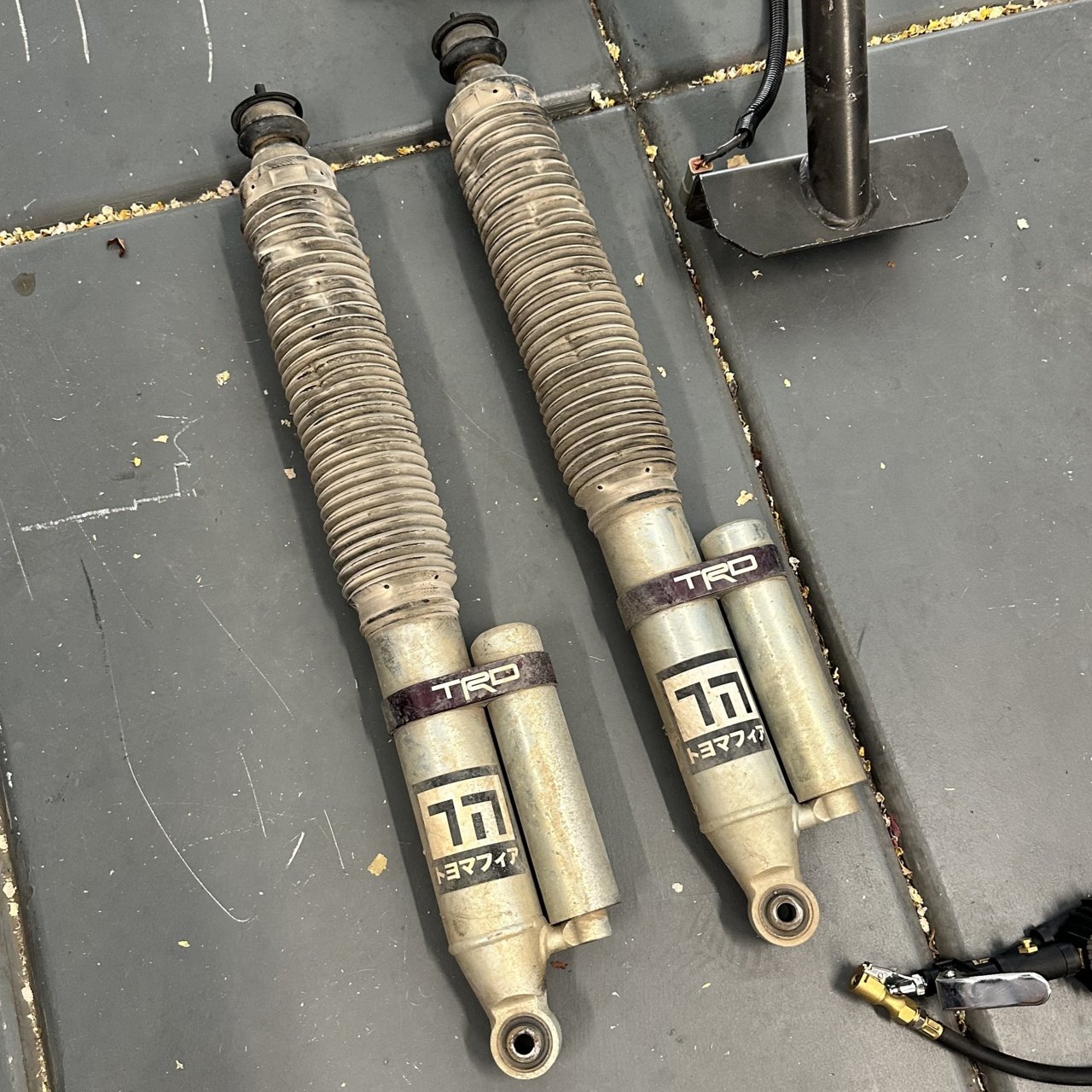

  23. Jul 4, 2023 at 8:40 AM
    #1253
    TRDFerguson
    TRDFerguson [OP] SSEM #99/RGBA #8-ish?/It’s a funny name.
    Oct 18, 2018
    #20730
    10,925
    Jake
    Southeast Greater Basin, AZ
    2018 MGM CrüeMax

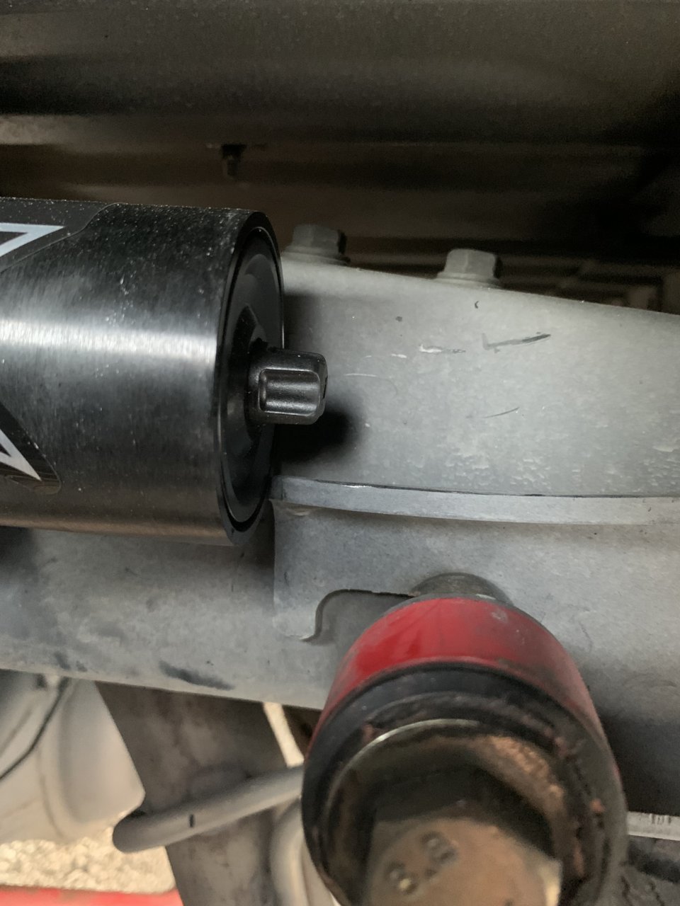

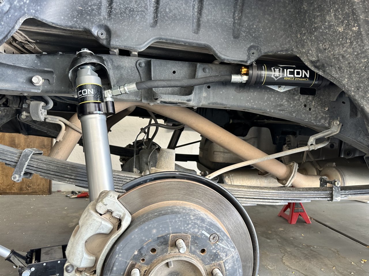

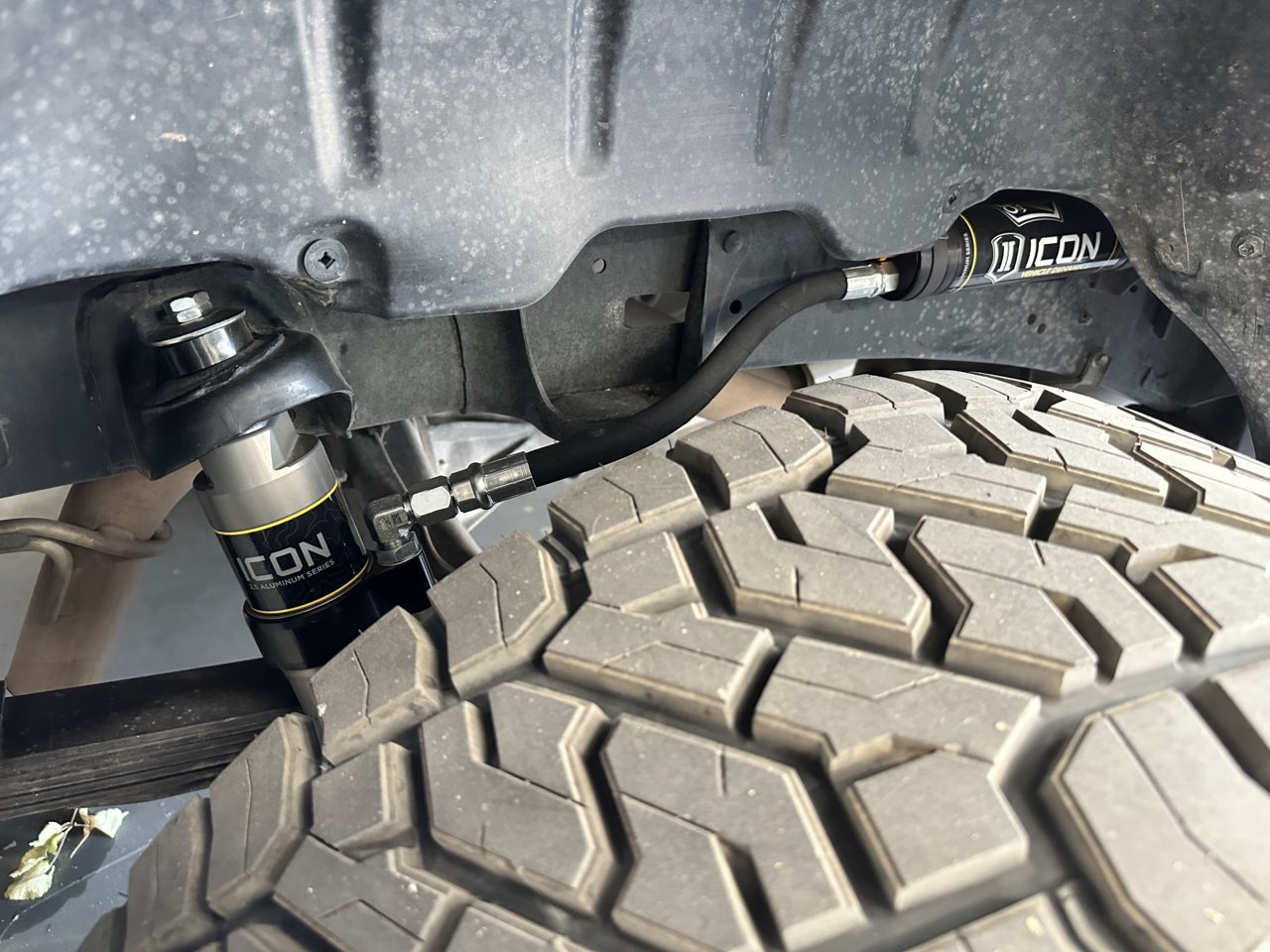

    I started about an hour ago. I’m just going to knock out the rears today, still waiting on a replacement misalignment spacer for one of the fronts that fell out during shipping. It’s toasty.

  25. Jul 4, 2023 at 12:33 PM
    #1255
    TRDFerguson
    Oct 18, 2018
    #20730
    10,925
    Jake
    2018 MGM CrüeMax
    How’d your project go? Rears are in and riding nice. Not sure when the fronts will happen.

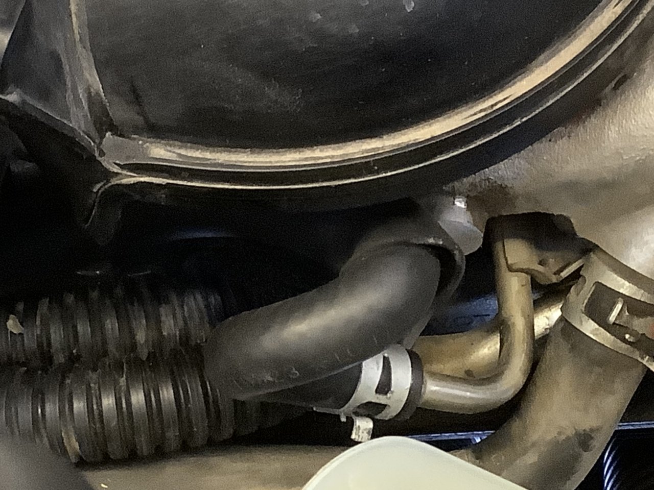

  26. Jul 4, 2023 at 12:53 PM
    #1256
    coTony
    coTony member since sept, 2017 and a BUNCH of messages
    Sep 16, 2017
    #9693
    3,100
    Tony
    Montrose, CO
    *** OV Tune Order #4481 *** ECU 0CN21 ***
    2018 Tundra Platinum with Icon Stage 9 w/3.0 and billet UCA, Harrop Elockers, 5.29 on 37’s

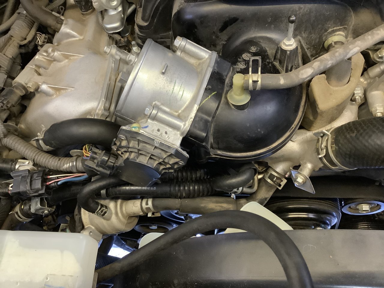

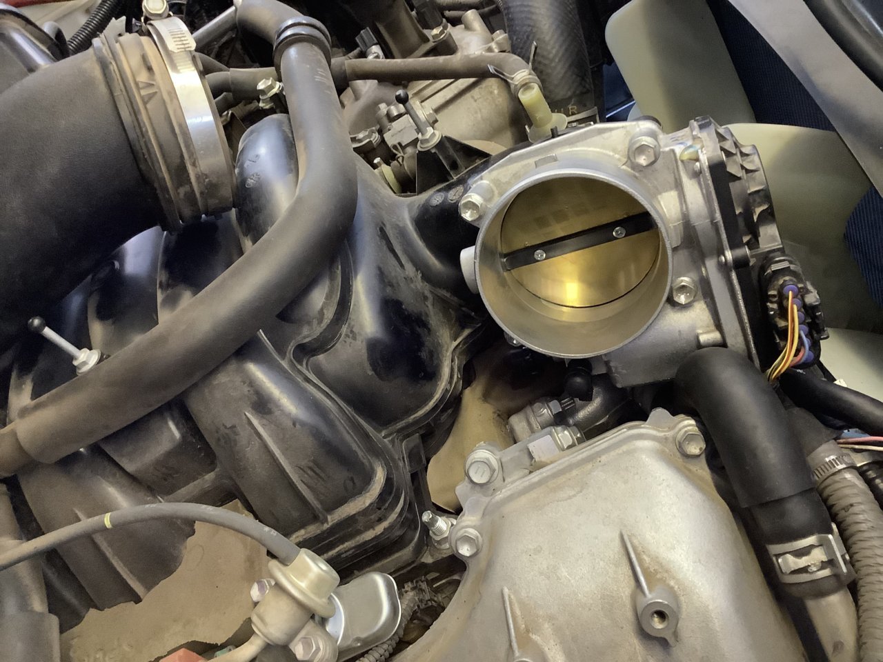

    Well I am wrapping up the Coolant Bypass and TB clean but man was that a chore. I used a whole brand new can of CRC TB a cleaner and still did not remove all the carbon. There is a ring (casting ring) inside that it built up on. I had a plastic piece I used to try to break loose but it was fighting back. After all that fighting I got a polish wheel out and got it done. I will go back in when I get something to port and polish it to a baby’s butt later but moving on to the skid plate cuttingIMG_0688.jpg
    This is how I connected my bypass hose, it was curled like this on the end but I did not want to cut it so I reused the curve. It should be fine
    I will be back you little b*@ch!

    BTW
    Does anyone have the torque for the 4 bolts holding the TB? I am going to start digging but thought maybe someone had it handy
    It is 95 in my garage
    e30cabrio and TRDFerguson[OP] like this.

    Just got the TB torque
    156 in lbs = 13 ft lbs

    I’m so confused. Where’s the little shelf on the drivers side that makes installing the reservoir a PITA? :confused:
    nevermind. That’s two photos of the passenger. :rolleyes:

    Lol, I just went above it and had no problems on the driver side
