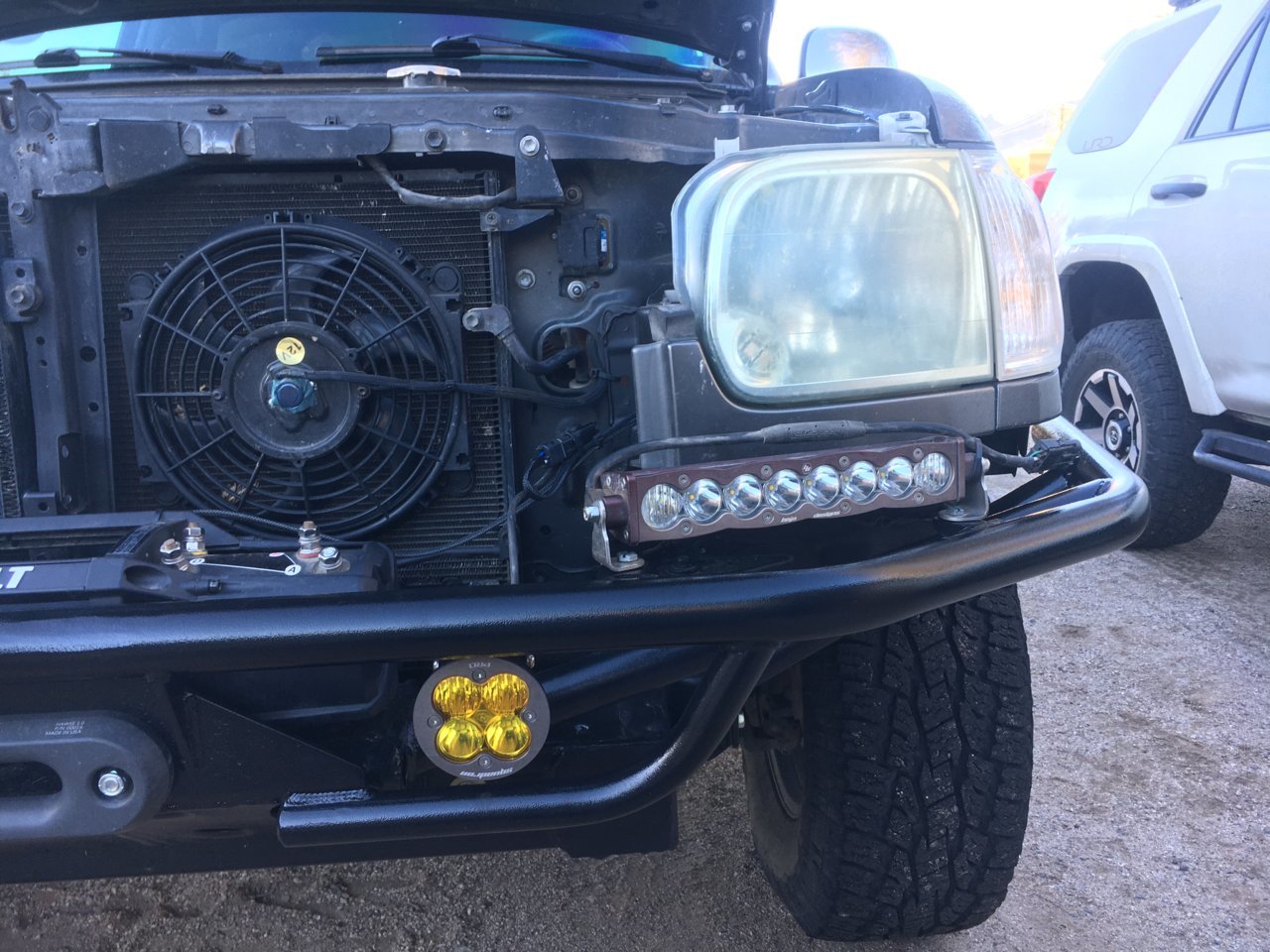

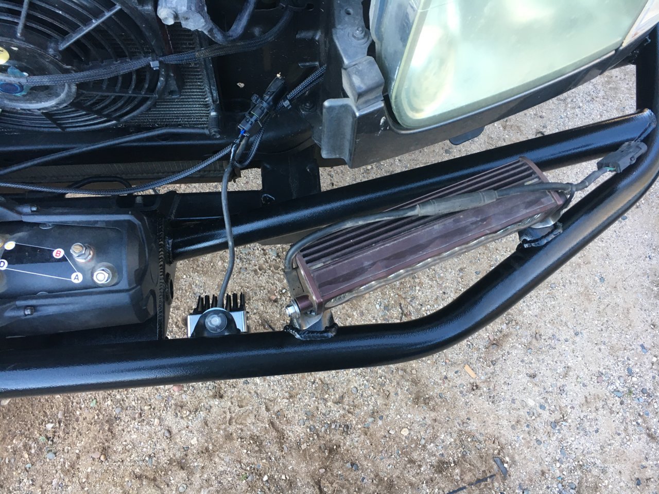

    Where is that going?!
  5. Mar 10, 2023 at 5:35 PM
    #1025
    FrenchToasty
    Sep 15, 2019
    #36156
    18,622
    Mo
    The SoAz….. big surprise
    Bone stock
    It will mirror the driver side.
    I’m excited to test it out because it looks goofy AF, but I think it will do well.

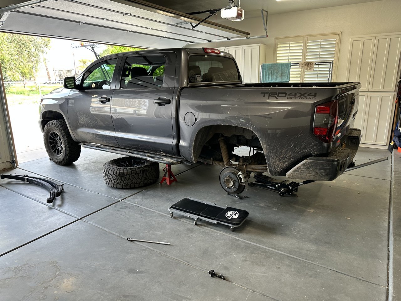

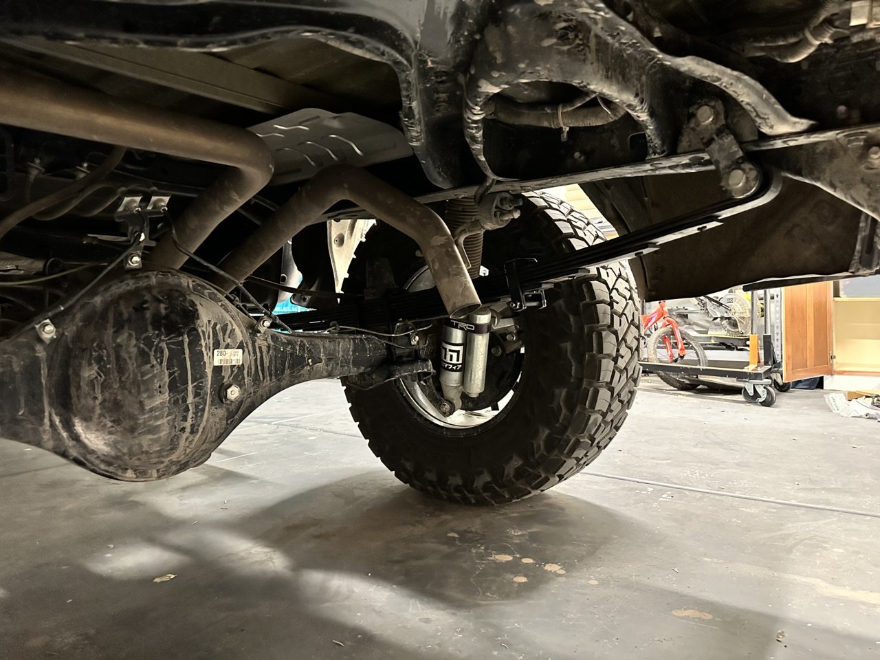

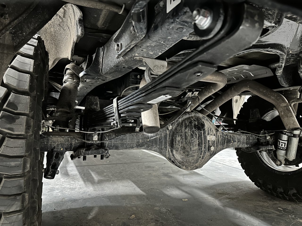

    Tackled the RXT leaf packs install today. The driver side that I started on was a bitch and a half, didn’t realize the axle shifted rearward slightly so I couldn’t get the eye holes aligned. Finally wrapped a ratchet strap around the axle and slider and got er in. The passenger side was a breeze compared to the driver, but still sucked. I’d recommend 2 people for the job.
