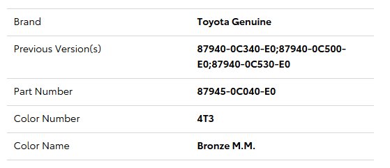

    @pyrite808 Sparkparts website lists these mirror caps as "bronze" color. Is that the same thing it said when you ordered them? Are they a direct match to your pyrite mica? I want to order but scared these will be a different color than pyrite mica. I asked customer service at Sparks and he was just reading off the screen like I was.

    That's what I ordered, pyrite mica is 'bronze'. If you were to search the part number across other sites you will notice they have color name: Bronze M.M. and color number: 4T3. 4T3 is the paint code for pyrite mica.
    from: https://autoparts.toyota.com/products/product/cover-outer-mirror-lh-879450c040e0
