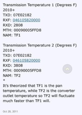

    The torque converter temp is actually the same as the pan temp until you start driving, the torque converter only gets hotter than the pan when its being used while unlocked, when the torque converter is locked up the temp will basically mirror the pan temp as well. I watch my temps almost every drive with my OBDlink MX+.

    It'll read both pan and converter temps. I usually have both displayed.
    These are the codes I pulled off the Tacoma forum some years ago for a 2nd gen Tacoma. Same codes worked for Tundra (2.5 gen) & 4Runner (5th gen) that I've used same scan gauge in.
    Dirtytruck[QUOTED] likes this.
