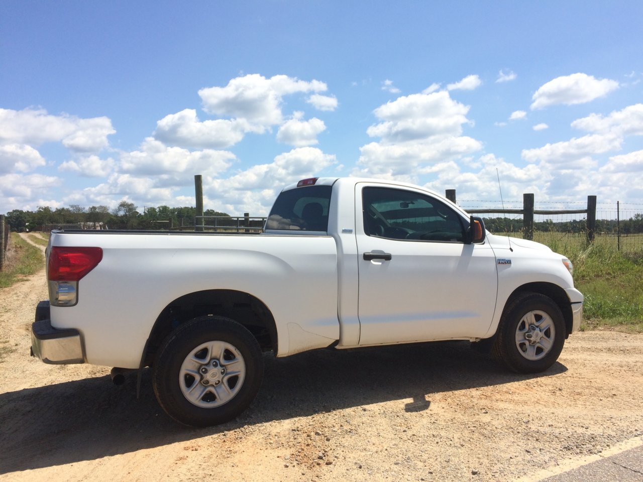

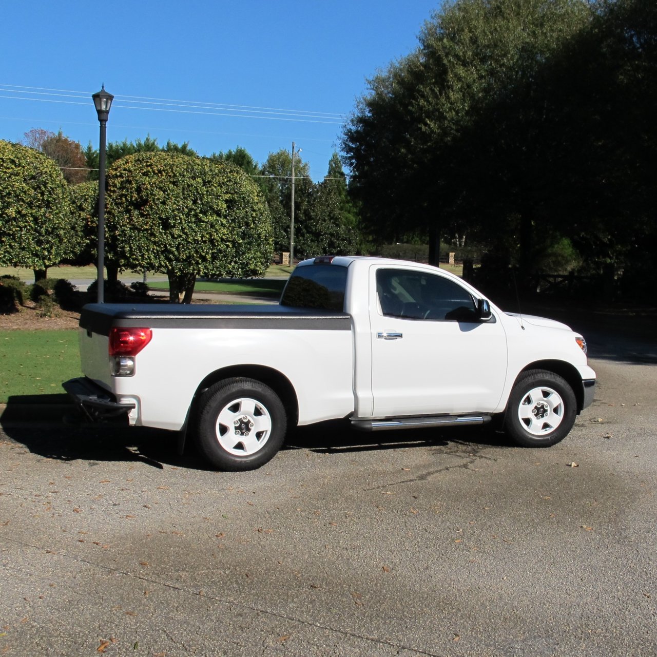

    The well used seats in my 2007 were not the most comfortable, and the jacked up rear on it's short wheel base resulted in a seating position that pushed your head & shoulders toward the windshield. I lowered the rear 3.25" and installed Wet Okole seat covers, this gave me extra padding and a normal seating position. The truck is very comfortable now.
    I lowered the bed of the truck by hanging the leaf springs under the axle. This leveled the truck as well as the seating position.
    before:
    after:
    ezdog likes this.

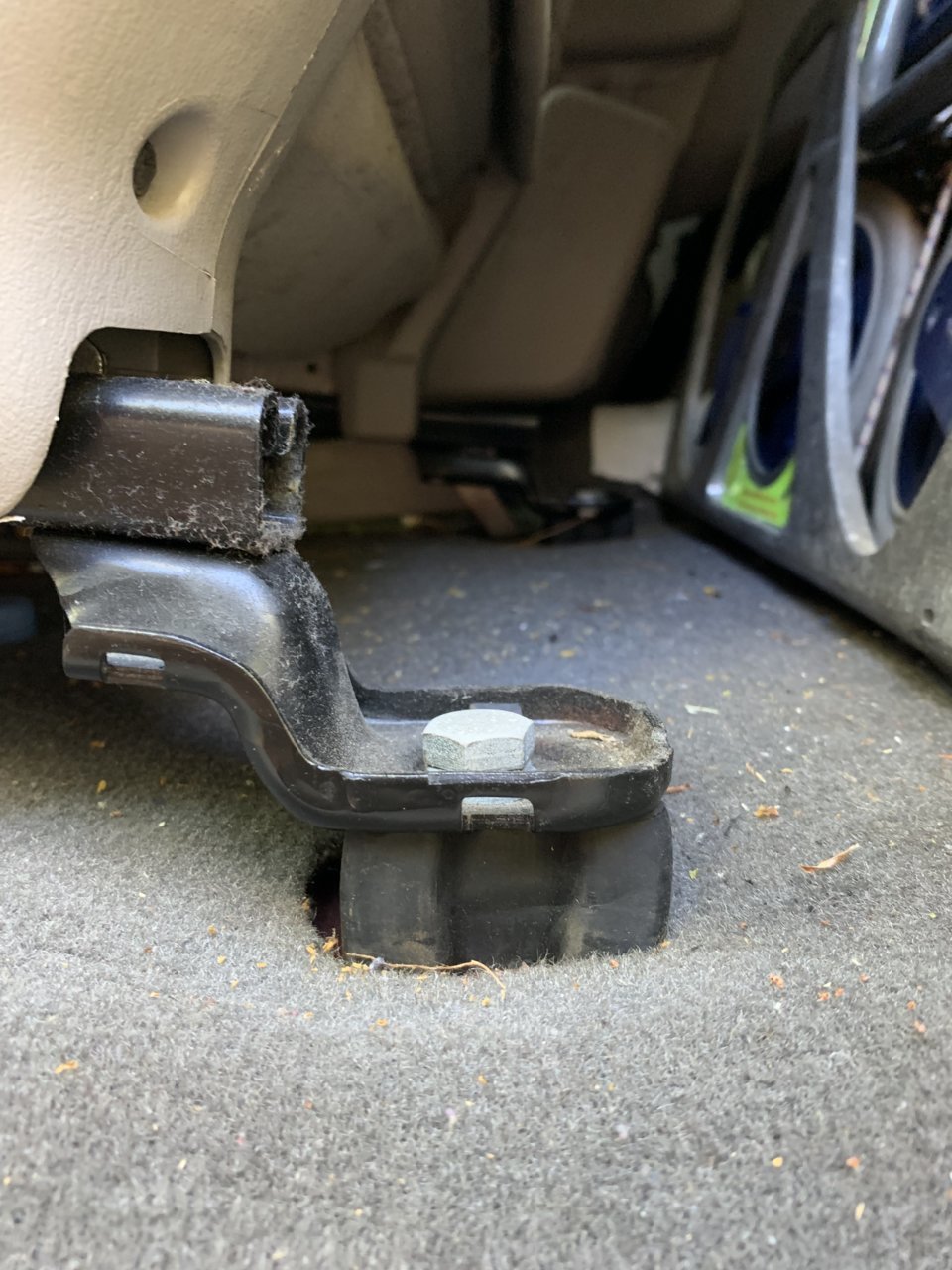

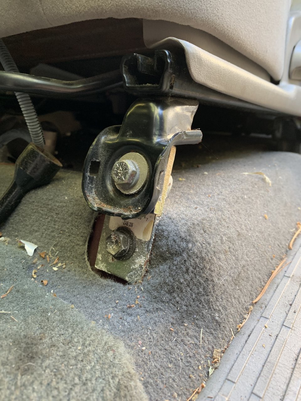

    On my 2001 there are manual bench seats that are split so that the drivers side is its own seat but there is no adjustment other than front/back and tilt the back.
    So I used metal and rubber to both raise the entire seat and tilt the bottom to the rear floor a little,problem solved mostly and have put 100k on the truck mostly really comfy as the seat feels like sitting on a couch really and there is decent legroom though nothing like the newer models there either.
    I had a 2007 briefly that had the fully adjustable electric seat and I loved it really,no complaints at all.
    Now the 2015 and I am back to no adjustment at all and the bench seat though they are really buckets when you remove the center section afterall and the angle seems much better than the 2001 bench was so I have not done the same thing to that one but it looks like it will be a really simple mod if I want to try it too.
    I looked at those Desert Design? blocks too and they would be so easy to make myself that I decided not to buy them for the crazy price they sell for.
    I could easily just do what I did with the 2001 seat.
