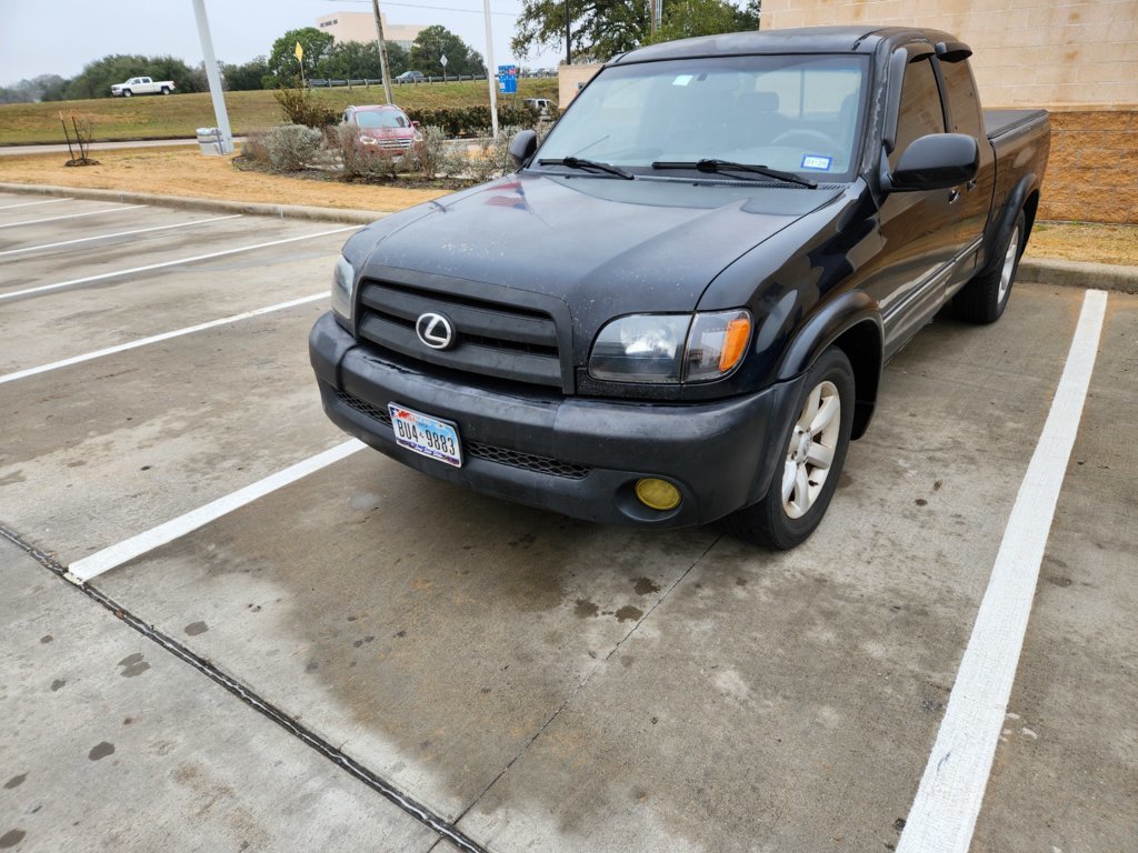

    You can totally fit wider tires, but your wheels are sucked in due to the GX offset being what it is. How’s your bumper and inner fender clearance?
  18. Jan 29, 2025 at 7:08 AM
    #48
    455h0le_dachshund
    455h0le_dachshund [OP] Death machine & man in love gogogogo
    Nov 21, 2023
    #107257
    8,346
    Rev. Hotdog
    TX...big surprise

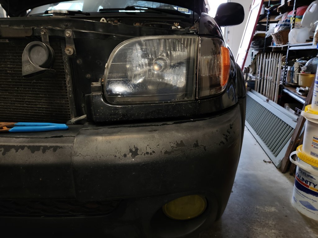

    Little gap. I wonder if I can adjust that?

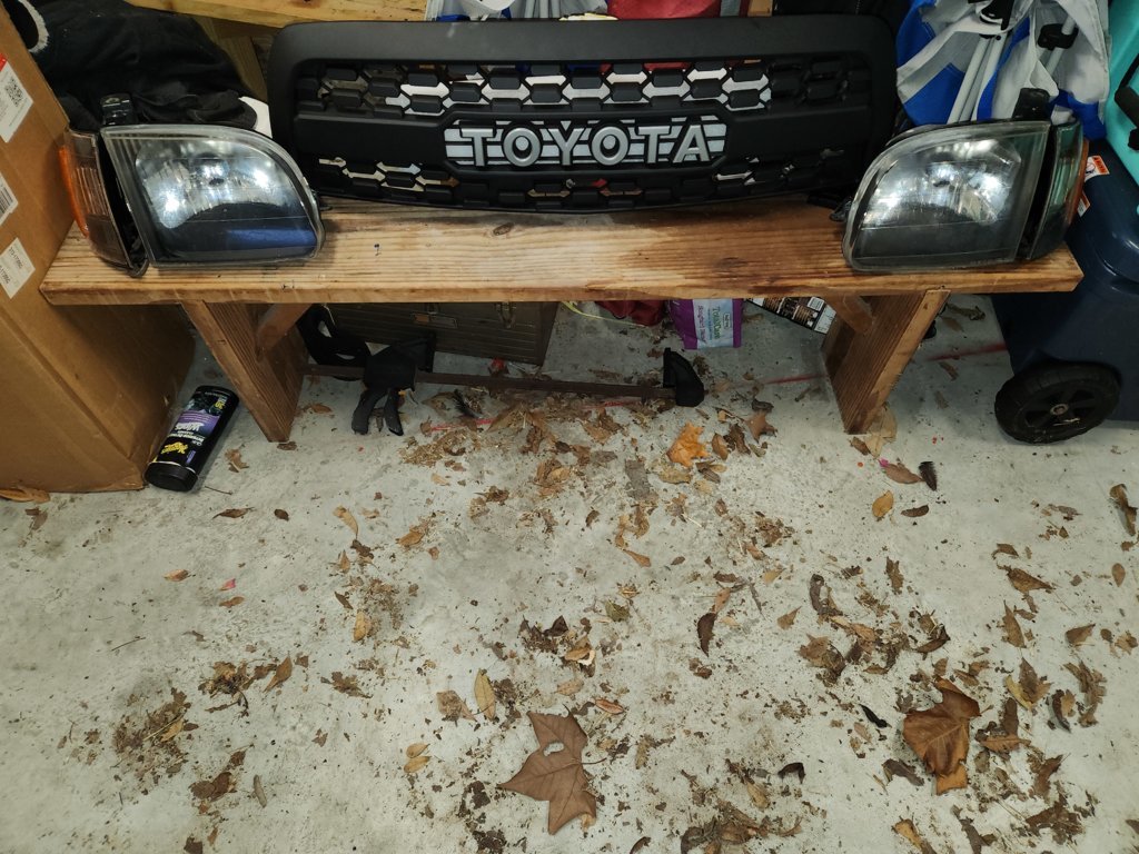

    I don't see any adjustment bolts on these aftermarket headlights. Oh well I guess I'll wing it and see how they look on the road omw to work tonight

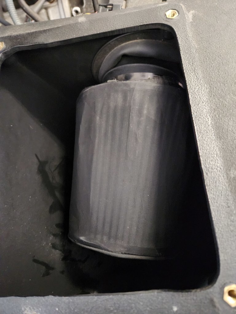

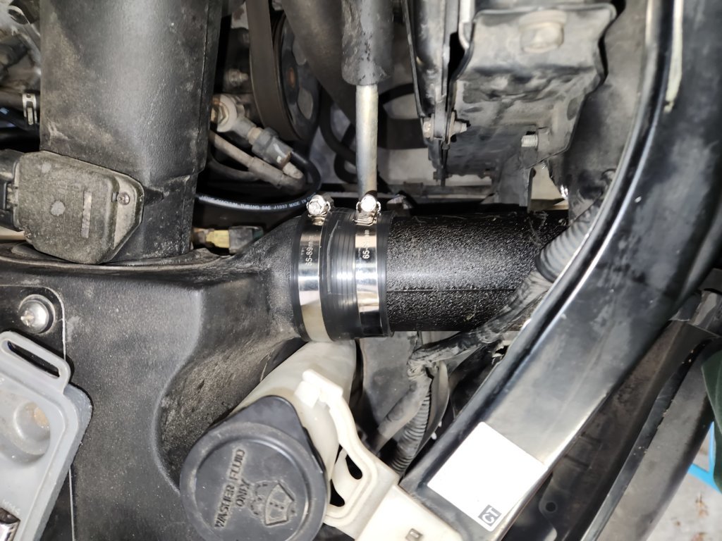

    Cold air intake.

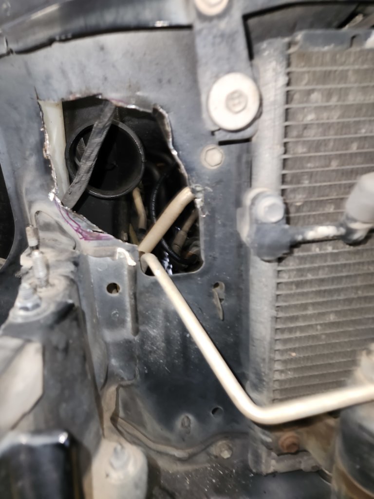

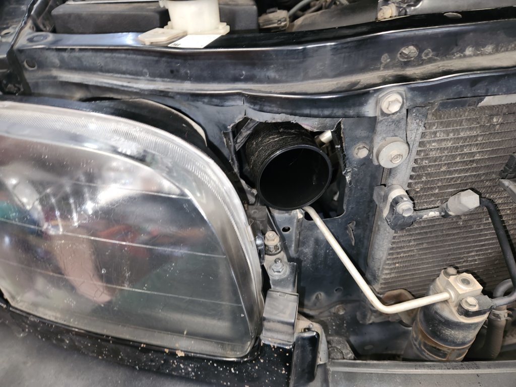

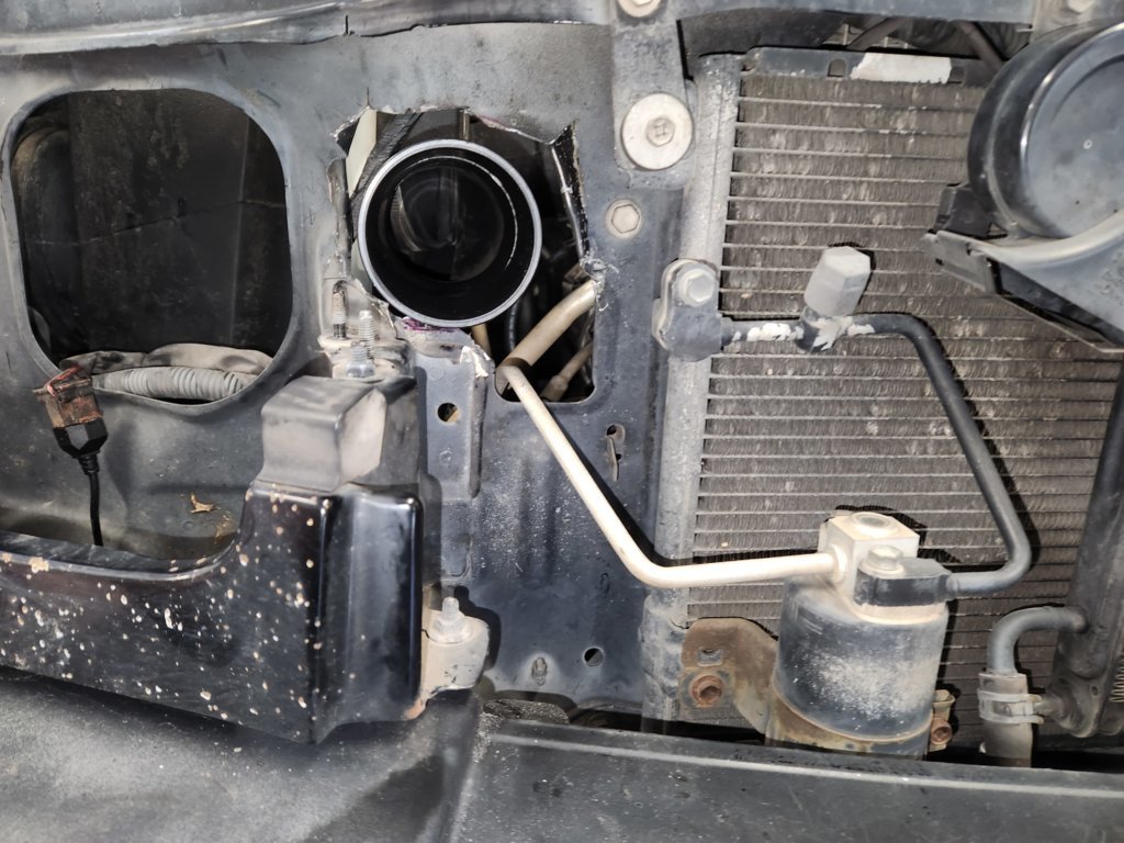

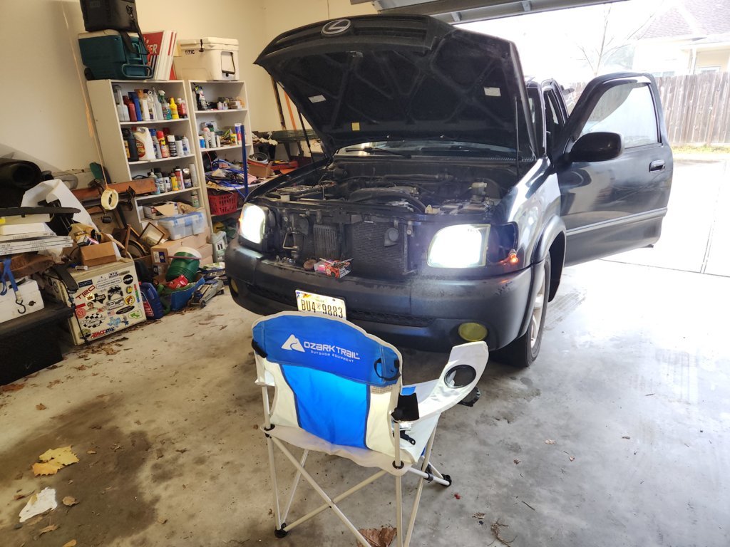

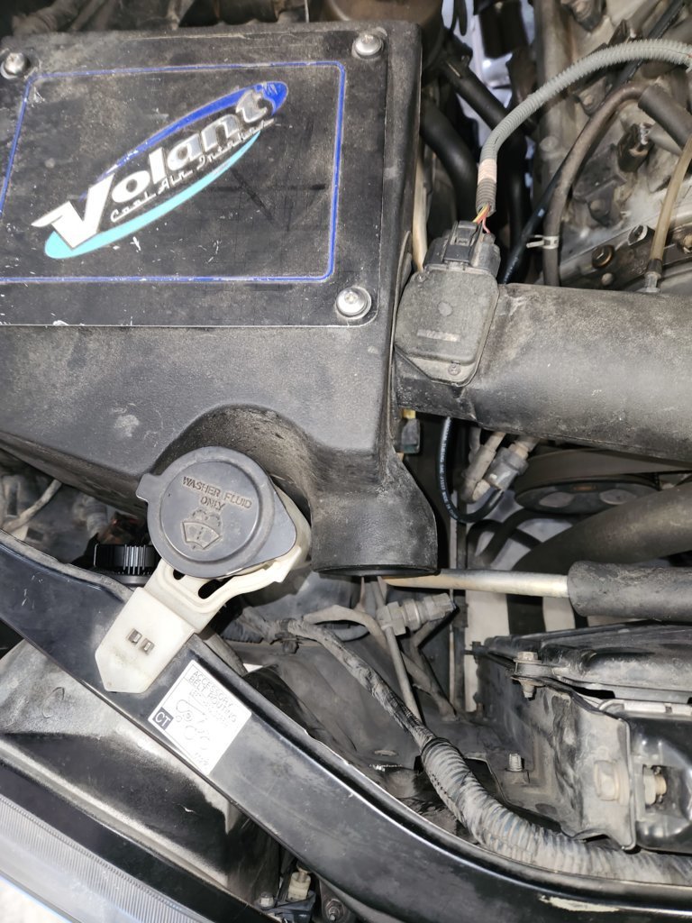

    Did an Italian tune up. I was going to wash it, but DT called and said my tires showed up. Just finished up fucking with headlights and intake. It took away longer than it should, but that always how it goes. The driver headlight needed some massaging with a drill bit on the inner mount. The holes were way off for the studs, causing the headlight to have an ugly gap on the outside. The passenger headlight mount on the putter side kept popping out, so I gorilla glued it. Lol
    I did fogure out there a hole for a Philips head to crank on the outside adjuster. The inside adjuster requires you to remove the inner mount from the headlights, if already mounted them to truck, then you can twist them.

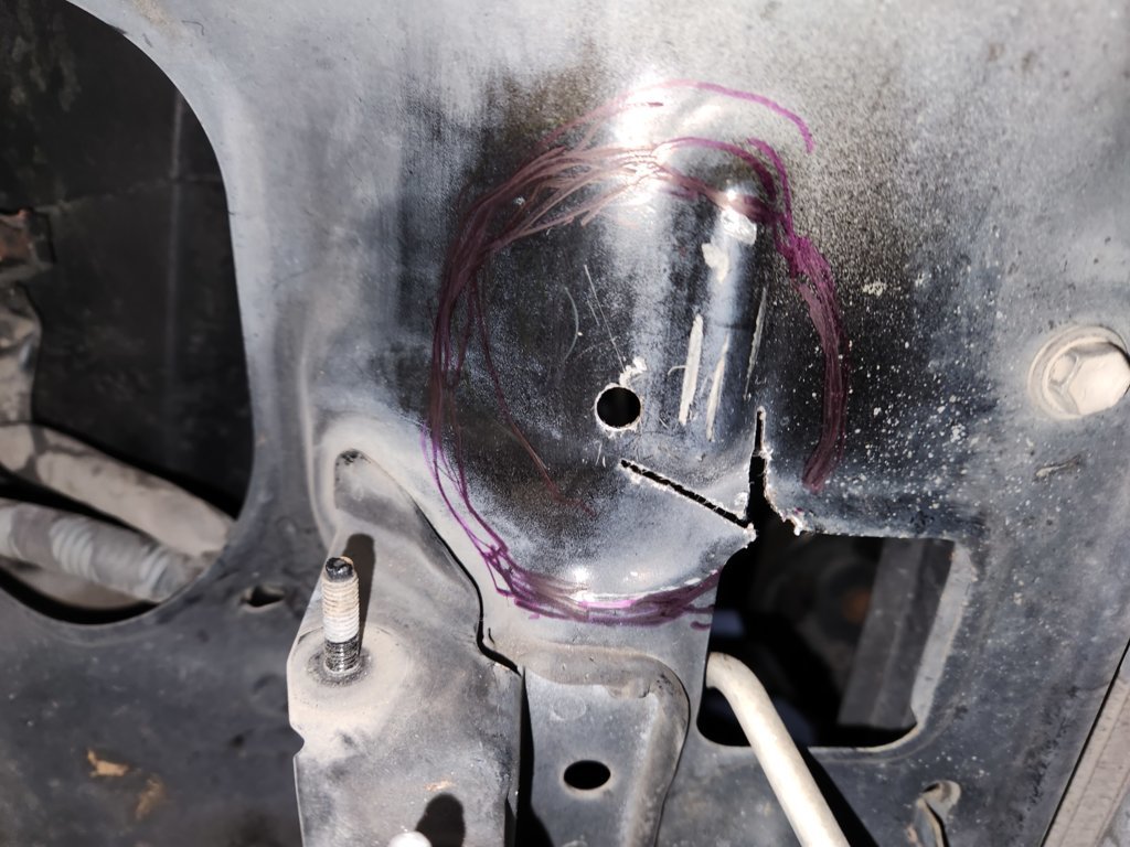

    I had to improvise to cut that hole for the intake. My hole saw wasn't meant for metal nor my hammer drill. So I tried my normal drill and it was too weak. So out came dad's big angle grinder. It was not precise due to its size and the area I was working on was a little cramped. But I made it work with the help of some tin-sheers/snips what ever the fuck you wanna call em... and channel locks. I only got a few small cuts on my hands and fingers. So I'd say it was a victory overall.
    Just dropped off the truck at DT.

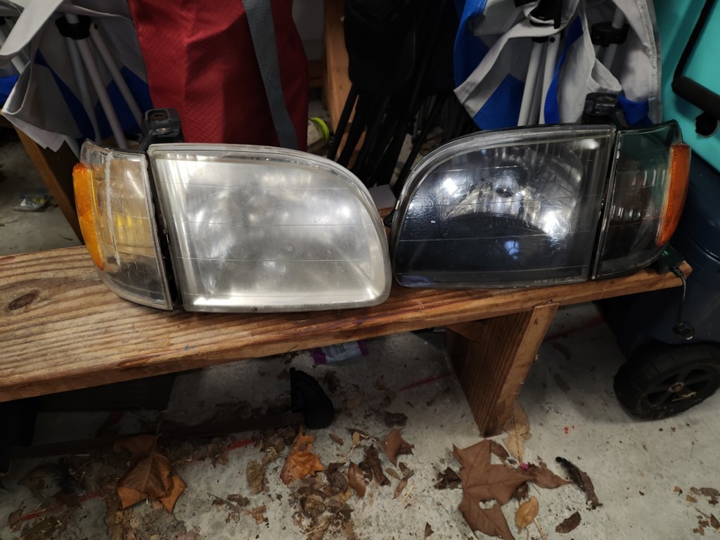

    I like the black housings. Looks good. I just need to decide if I'm going to try to trim the DC TRD Pro grill or sell it. I really want to see the CoLights at night.

    Imma keep it stock
    That's interesting that you found the headlamps to not fit well. They should be the same part number across both our years.
  28. Jan 29, 2025 at 11:53 AM
    #58
    455h0le_dachshund
    Nov 21, 2023
    #107257
    8,346
    Rev. Hotdog
    TX...big surprise
    Yeah they are.
    I think it's just old trucks and cheap parts. Maybe my head panel is slowly bowed. Who knows?
    Someone made a thread about a week or two ago about aftermarket headlights not fitting right. I don't remember how he solved it, but I imagine he did the same thing I did. The passenger side marker light and headlight part that share holes for the plastic push tab thingy, was a bitch to get loned up too. But meh, I ain't worried about it. They look pretty good. I'll give em a nice restoration treatment sometime soon. I've always got an identical set of headlights and corners that Beau gave me at Merus. Still have the plastic film on the lenses. I decided to try yours first since they were used and I was going to have to mangle the reflector for the CoLights to fit.
    I've still got my OEM 2006 headlights somewhere, and now the aftermarket chromes o just took off the T3. So three spare sets. I think I might experiment with the OEM ones, since they have the spot for the marker light inside the lense. A red LED on each, with the chrome painted black, and some retrofitted projectors, with Morimoto HIDs could be in my future. I'd just need to figure out what to do about a new lense, or try to refurbish one of the aftermarket ones maybe.

    In hindsight, I should've just cut a big square with the angle grinder. I was trying to only cut as much as necessary. But admittedly, I'm new to working with metal. It didn't help that the coupler fought me the whole damn time, which how I got a few cuts and why I ended up mangling the metal even more.
