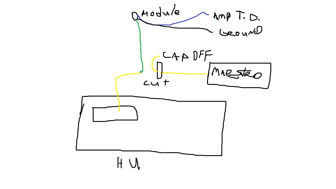

    Well shit, now I'm confused (admittedly easy to do). The harness that plugs into the HU is from the Maestro via the AlP1. So where do I connect it?

    Cut the parking brake wire in that harness to the HU. Hook the end going into the HU to the bypass module. Seal off the other end. Have another Miller Lite.

    Like this?

    This. I just finished this about 2 hours ago after looking at the manual to find the wires to connect to and then followed the directions here to splice in the bypass. Works perfectly!

    Cool. I assume that it's ok to posi-tap the ground in that same harness since it's right there anyways?

    Yep, that’s fine

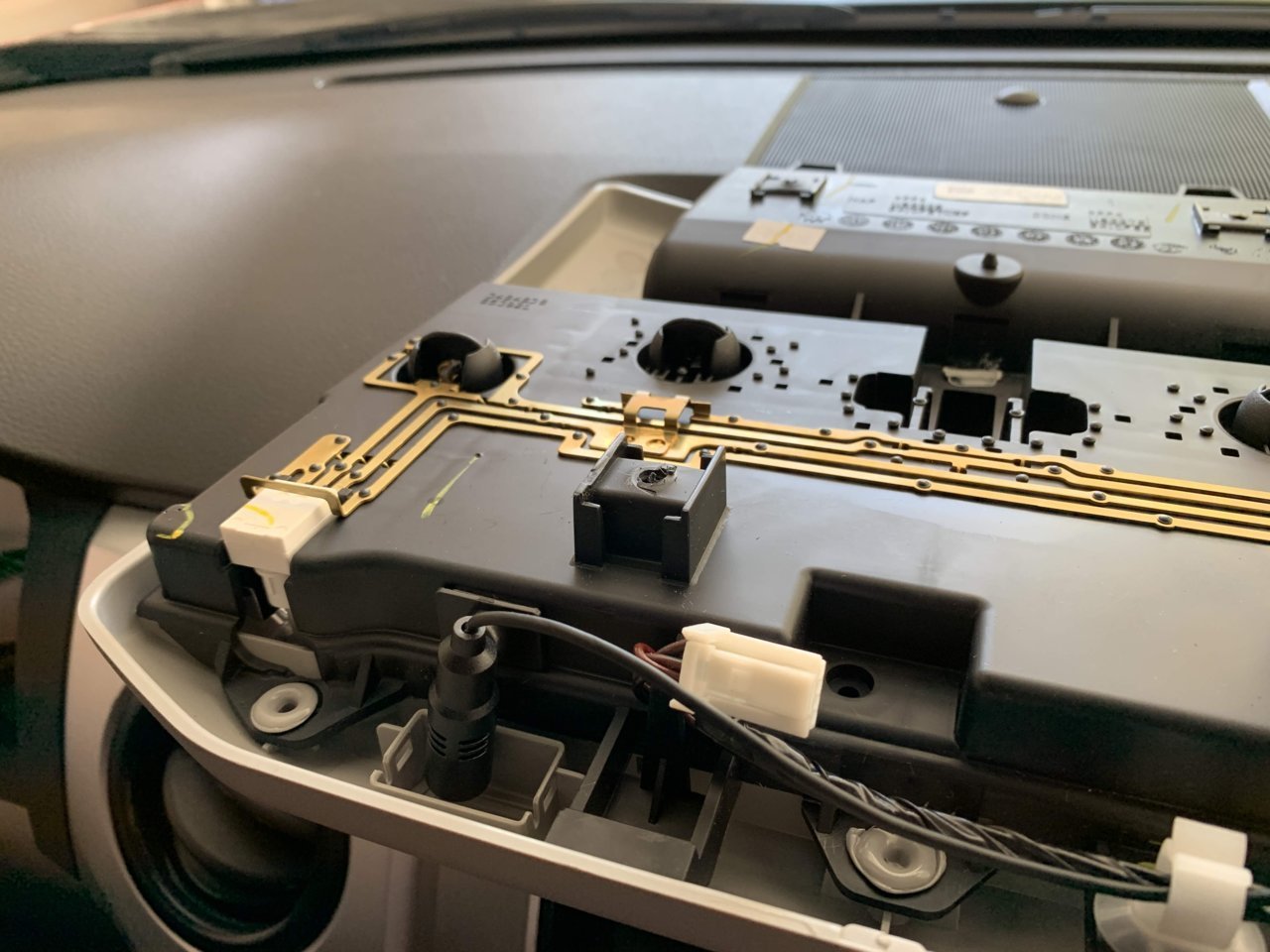

    FYI this is where/how I mounted my aftermarket mic. Just removed the factory guts and threw those in a drawer

    I'm already so sick of wires I took the easy way out. After I finally got that fucking stripped screw out, I just lowered the screen 1 notch so the pocket was still accessible. Drilled a hole in the back of the pocket to run the wire and mounted the mic at the front of the pocket on the left side pointed at the driver.

    Any issues with the sound quality in this location from the aftermarket mic? If not, I may just copy this approach.

    I haven’t had any complaints, and the wife usually lets me know when I do anything wrong.
