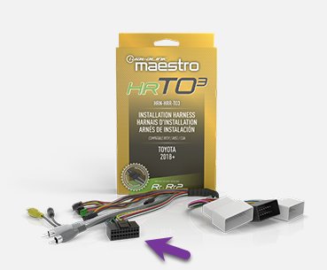

    A question came up today separately, so thought I'd put the answer up here to help clarify things.
    Do I need the HRN-RR-TO3 or the HRN-HRR-TO3 harness for the Maestro? A similar question applies to the Gen2 with the "TO1" harness and the Gen2.5 2014-2019 trucks with the "TO2" harness.
    As shown in the flow chart, the RR harness is not "Plug and Play" while the HRR harness is. But what does that mean exactly?
    The RR harness looks like this. You have bare wires for the speaker connections and you will need to connect all of these bare wires to the harness(es) that came with your radio.
    The HRR harness looks like this. It has a connector with all of those wires running into it. That connector means you will need to buy another harness (specific to your head unit) that will go between that connector and the head unit.

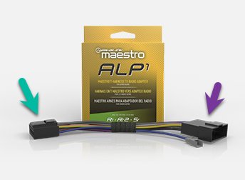

    Here is the Alpine harness (as an example). The purple arrow connector will mate up with the HRR purple arrow. The teal arrow connector will go directly into the back of the head unit (replacing the harness that came with it).
    Do note that if you use the HRR, that doesn't mean you won't still have wires to splice...just a few less of them. Also know that the connector between these two harnesses takes up some space that you might not otherwise need if you were to stagger your splices and shorten up the wires a bit.

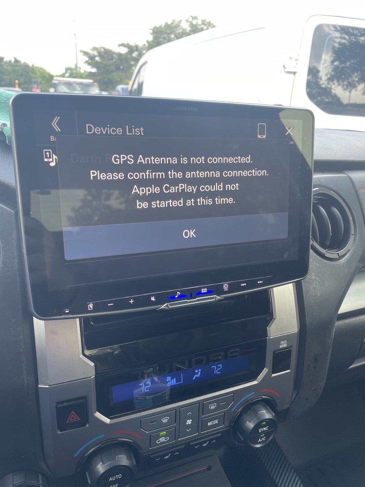

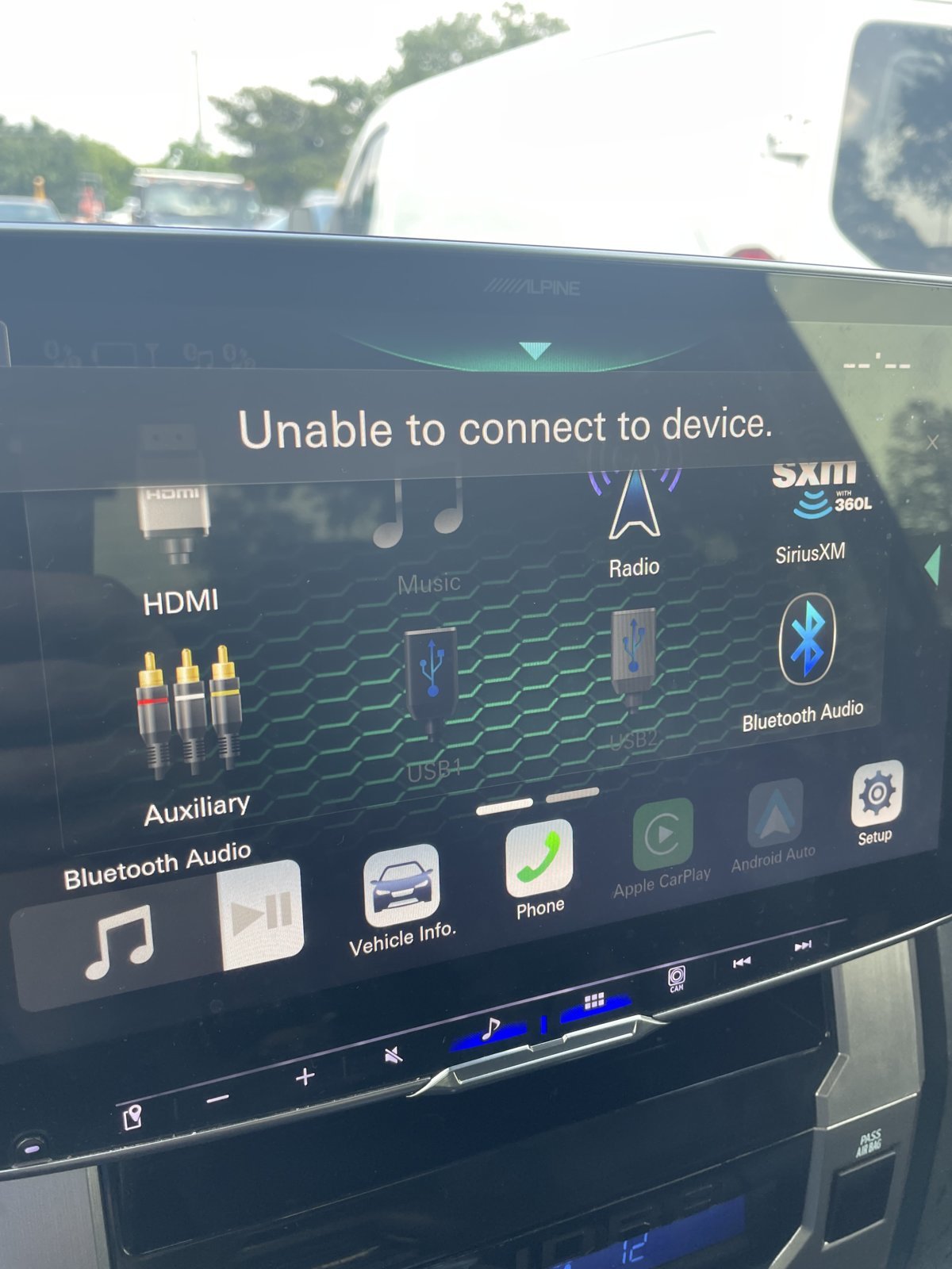

    Alright I have one for you guys.
    Alpine F511
    2020 W/ JBL
    • My compass on my dash isn’t working
    • When I hard wire my iPhone into the CarPlay port, it charges my phone but I get a message that says cannot connect to device
    • Clock on alpine doesn’t work
    • When I try to wirelessly connect to CarPlay, it says my GPS antenna isn’t connected.
      • I’m connected to the white OEM connector with the pigtail from discount electronics
      • XM is working so I should have the right antenna, right?
    I have torn this thing apart a few times now and am now seeking help from the pros. Anyone run into something like this yet? IMG_9836.jpg IMG_9837.jpg IMG_9835.jpg
  14. Jun 1, 2024 at 4:26 PM
    #974
    1794TX
    Nov 21, 2019
    #38971
    4,161
    Steven
    N.TX
    '20 1794
    The compass on the dash was driven by the nav unit in the factory HU, and I don't think you get that back. I use that as my default dash gauge as well, so it's gonna suck a bit when I get a new HU.

  15. Jun 1, 2024 at 6:31 PM
    #975
    Azblue
    Nov 17, 2017
    #11025
    10,134
    The Dirty T ( ^_^)_且
    You did install the additional GPS antenna, not just the stock XM one, right?
  16. Jun 1, 2024 at 6:40 PM
    #976
    GWill
    GWill gods gift to the internet
    Jan 12, 2021
    #57520
    466
    Willis
    Don’t know what you’re talking about
    2020 MGM TRD Pro
    I used the adapters rainman found to connect to the oem antennas. I didn’t use the additional antennas for either the gps or XM
  17. Jun 1, 2024 at 6:47 PM
    #977
    Azblue
    Nov 17, 2017
    #11025
    10,134
    Should be good then. I used the factory XM and the GPS from the Alpine. But as long as you have the 2, I would assume it's good.
  18. Jun 1, 2024 at 7:38 PM
    #978
    RainMan_PNW
    RainMan_PNW [OP] "Oz" SSEM #82 RGBA #4 Unofficial Forum Treasurer Vendor?
    Oct 27, 2020
    #54134
    16,950
    Casey
    Clark County, WA
    2021 Lunar Rock TRD Pro CM
    You’ll lose the instrument panel compass. It’s tied to the factory HU Nav, not much else you can do but get a dash compass or replacement rear view with the integrated compass.
    As for the others, it sounds like a loose connection. White is correct for the GPS (same color as the adapter cable).
    And are you 100% sure you’re connecting hard wire to the CarPlay USB cable (one works for CarPlay, one doesn’t).
    bulldog93 and FrenchToasty like this.
  19. Jun 1, 2024 at 7:50 PM
    #979
    GWill
    Jan 12, 2021
    #57520
    466
    Willis
    2020 MGM TRD Pro
    Ill pull it apart and snag some pics tomorrow. Im pretty sure due to the fact that is says "Unable to connect to device" when I plug in at the bottom of the dash

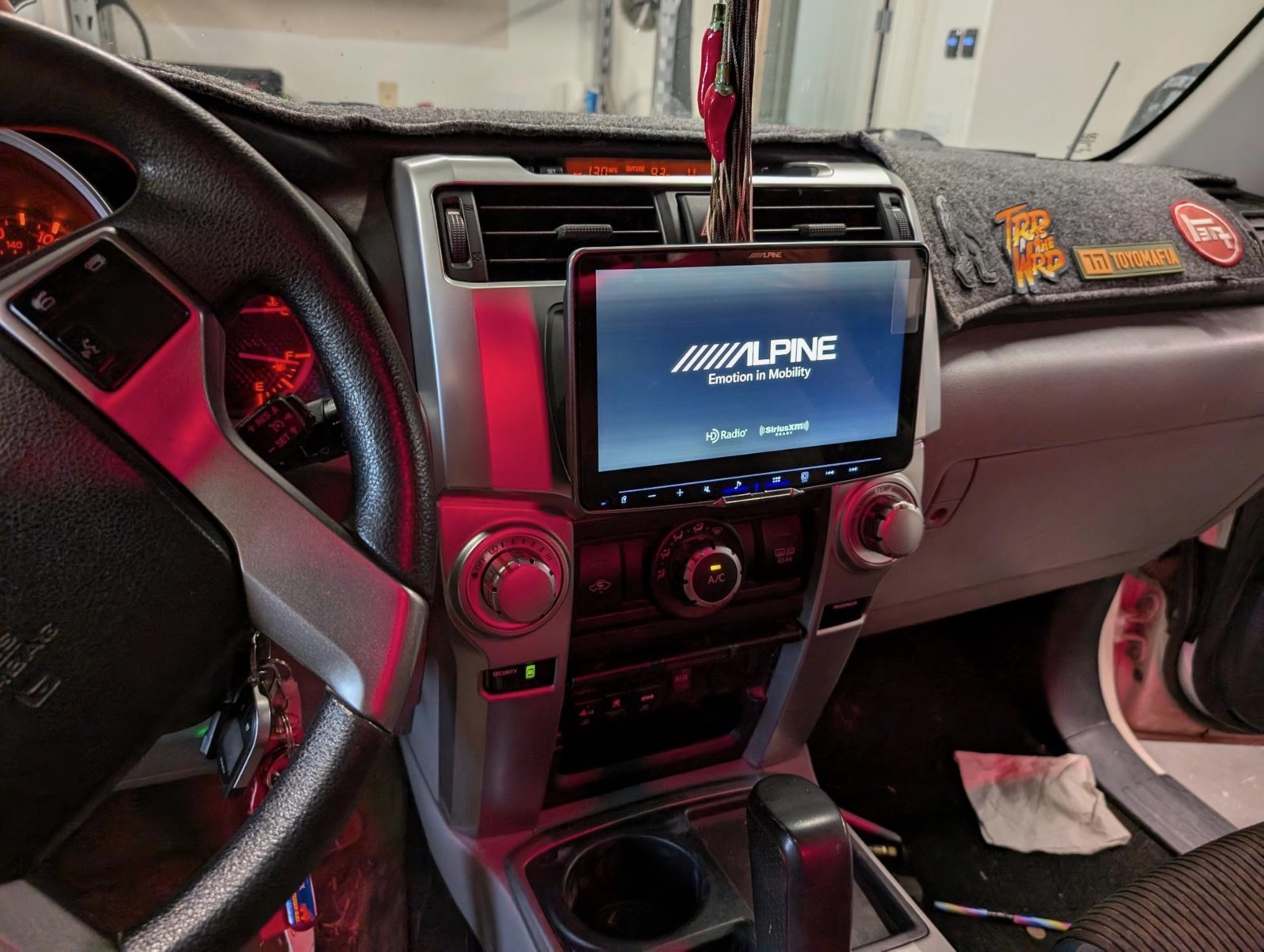

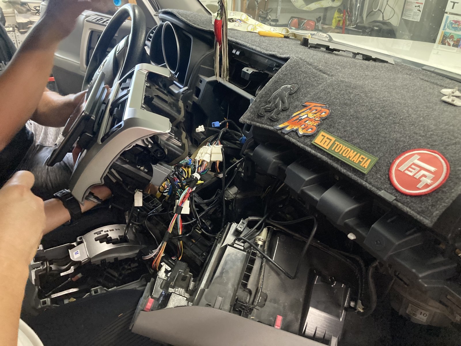

    Well 6 months later I finally got the 9” installed in the 4R!!!! The most difficult part seemed to be pulling most of the dash to fish stuff thru, you almost have to take every panel off just to get to one you need
    Big thanks to @TRDFerguson and @AT x AT for the help with installing! And thanks to @Uncle Bif for the head unit!

    I’m just glad we remembered to hook up the damn mic before we buttoned it back up :rofl:

    that looks like rocket surgery!
    I can only imagine missing a connector somewhere and having to pull it all back apart.

    I’m also impressed with our retention of all the bolts and screws, even with some jumpers in the show

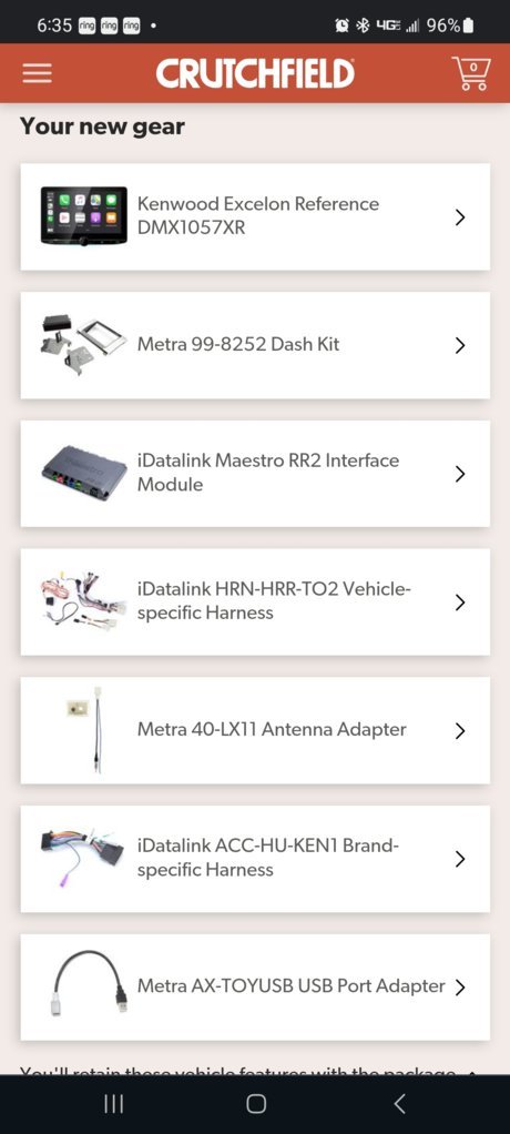

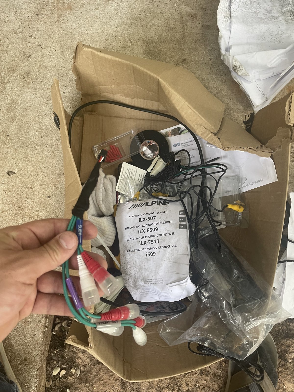

    Need some help.
    Ordered this. And now I'm trying to figure out what to do with these wires.
    The USB adapter, what is that for? It doesn't plug into my head unit does it? I don’t see a USB plug.
    Did your antenna connector require wiring in the blue wire for power? If so, where do I do that?
    The other two shown not used are gps and xm right? I appear to have a different gps antenna and plug in?
    Will the xm adapter suggested on page one work for the oem xm antenna with thus HU?
    Did anyone's back up connecter have to literally be forced on? Mine required scary force.
    Post with pics and me begging for help is here - https://www.tundras.com/threads/need-some-help-with-my-kenwood-dmx1057xr-install.148413/
