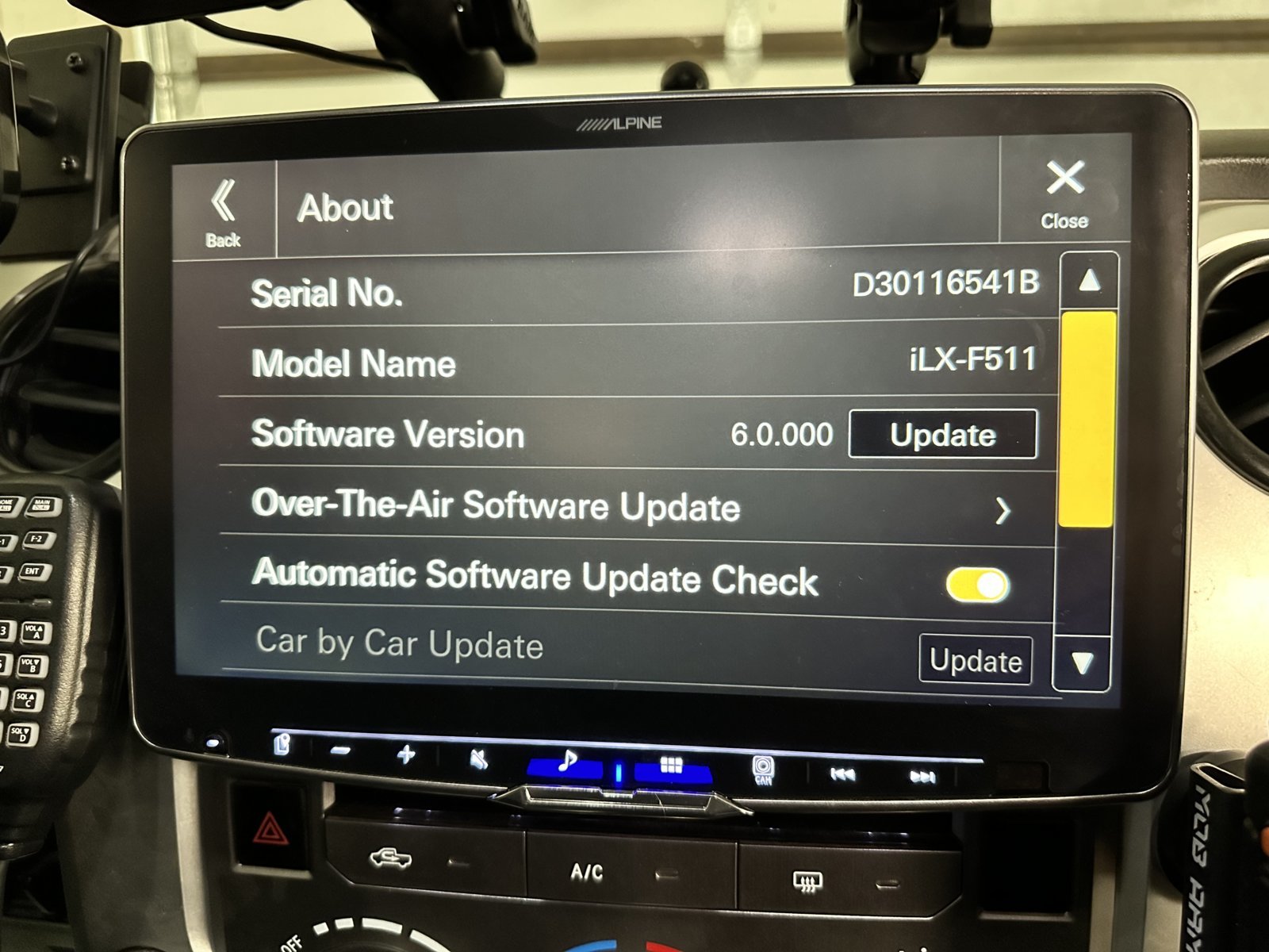

  8. Feb 22, 2024 at 8:13 AM
    #908
    TRDFerguson
    Oct 18, 2018
    #20730
    10,895
    Jake
    Southeast Greater Basin, AZ
    2018 MGM CrüeMax

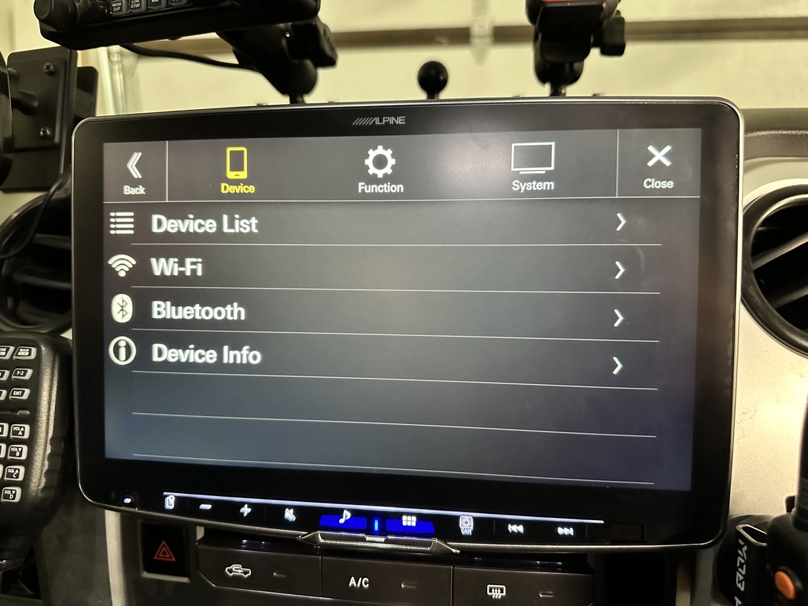

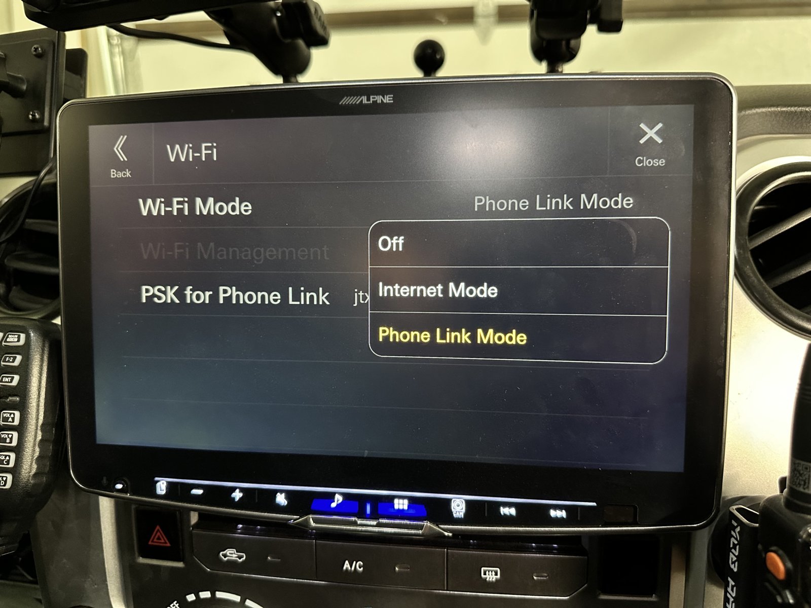

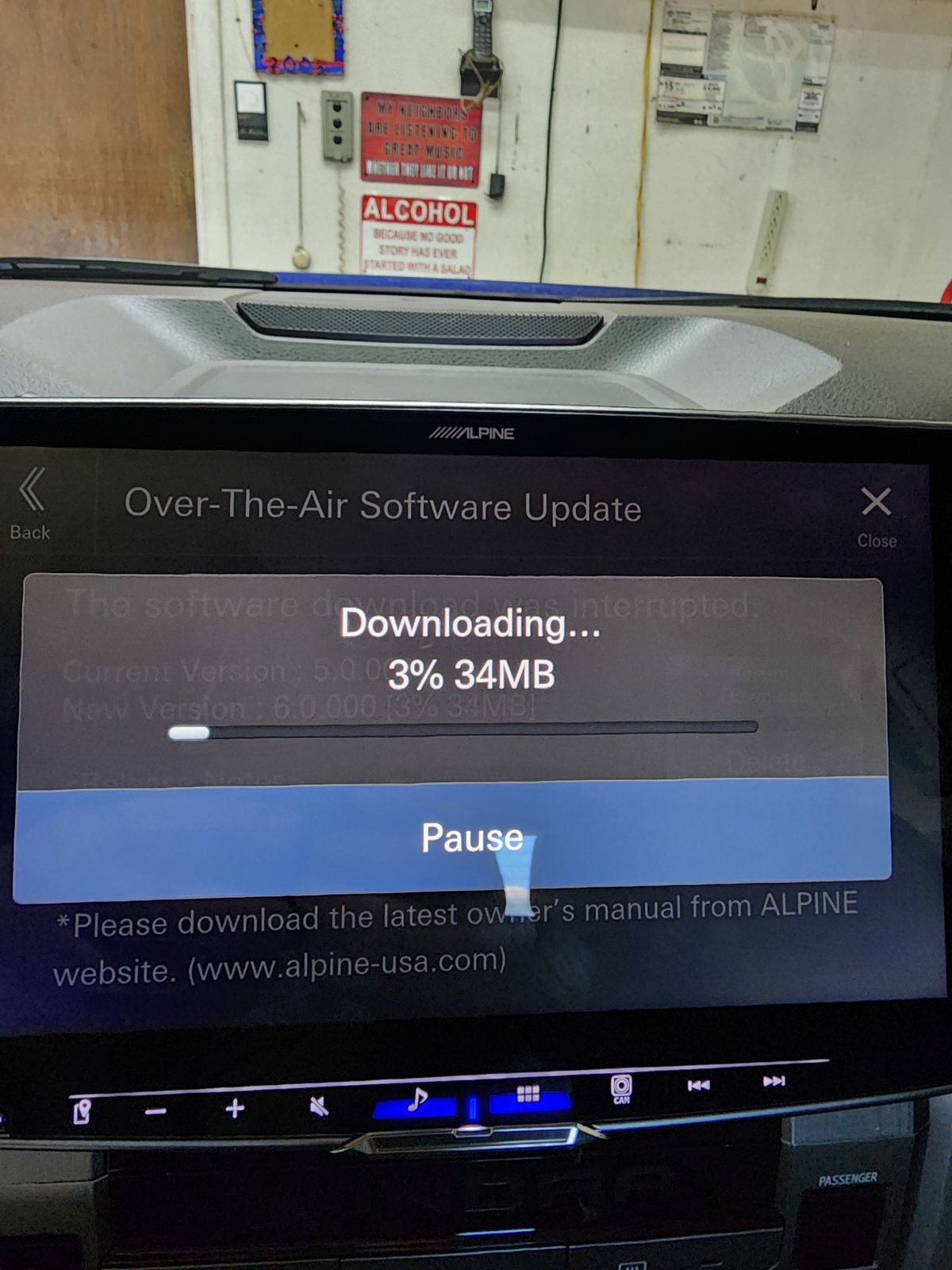

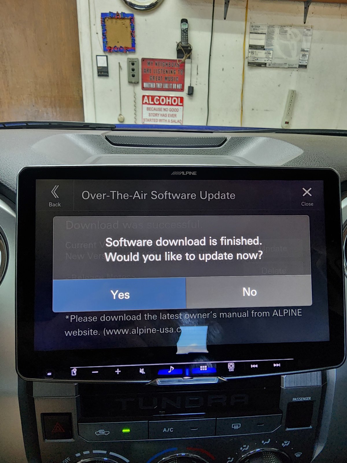

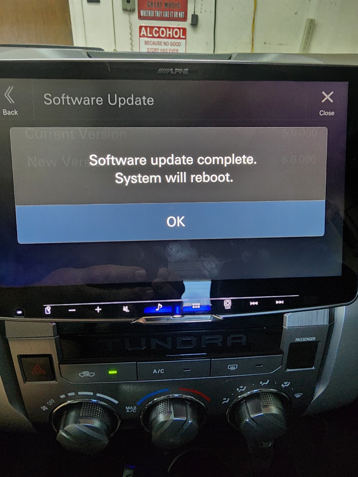

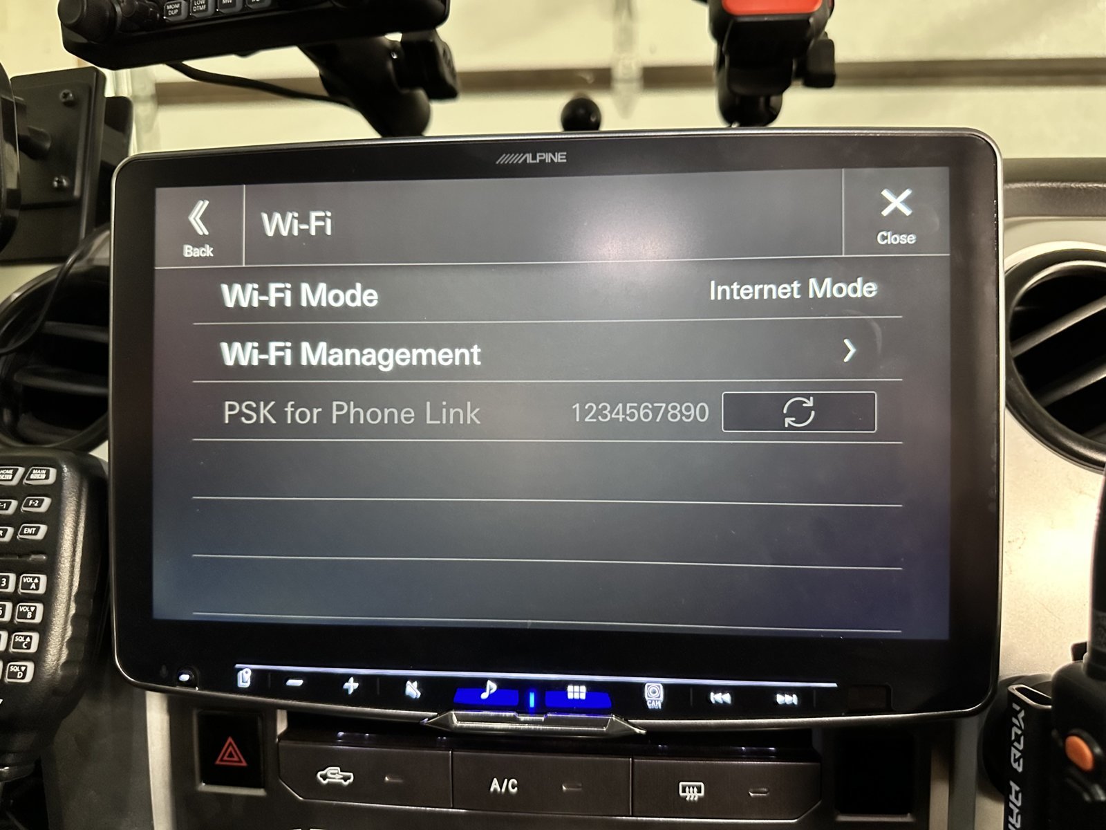

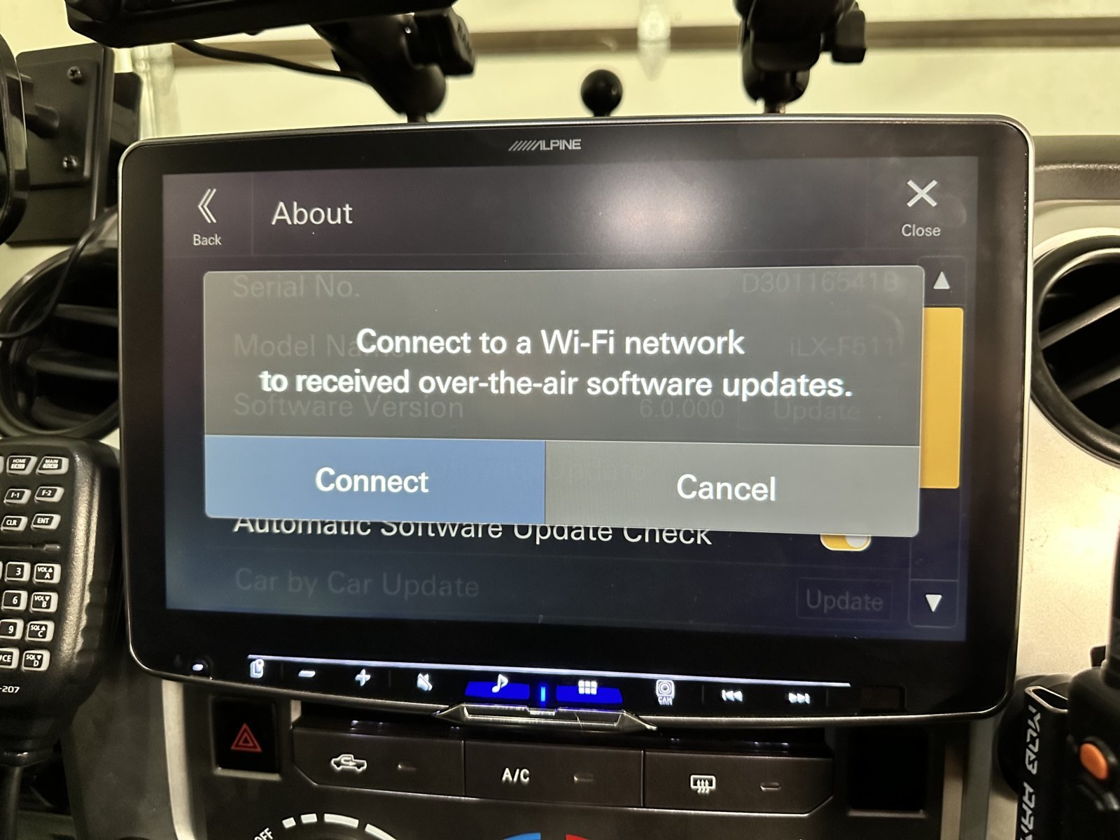

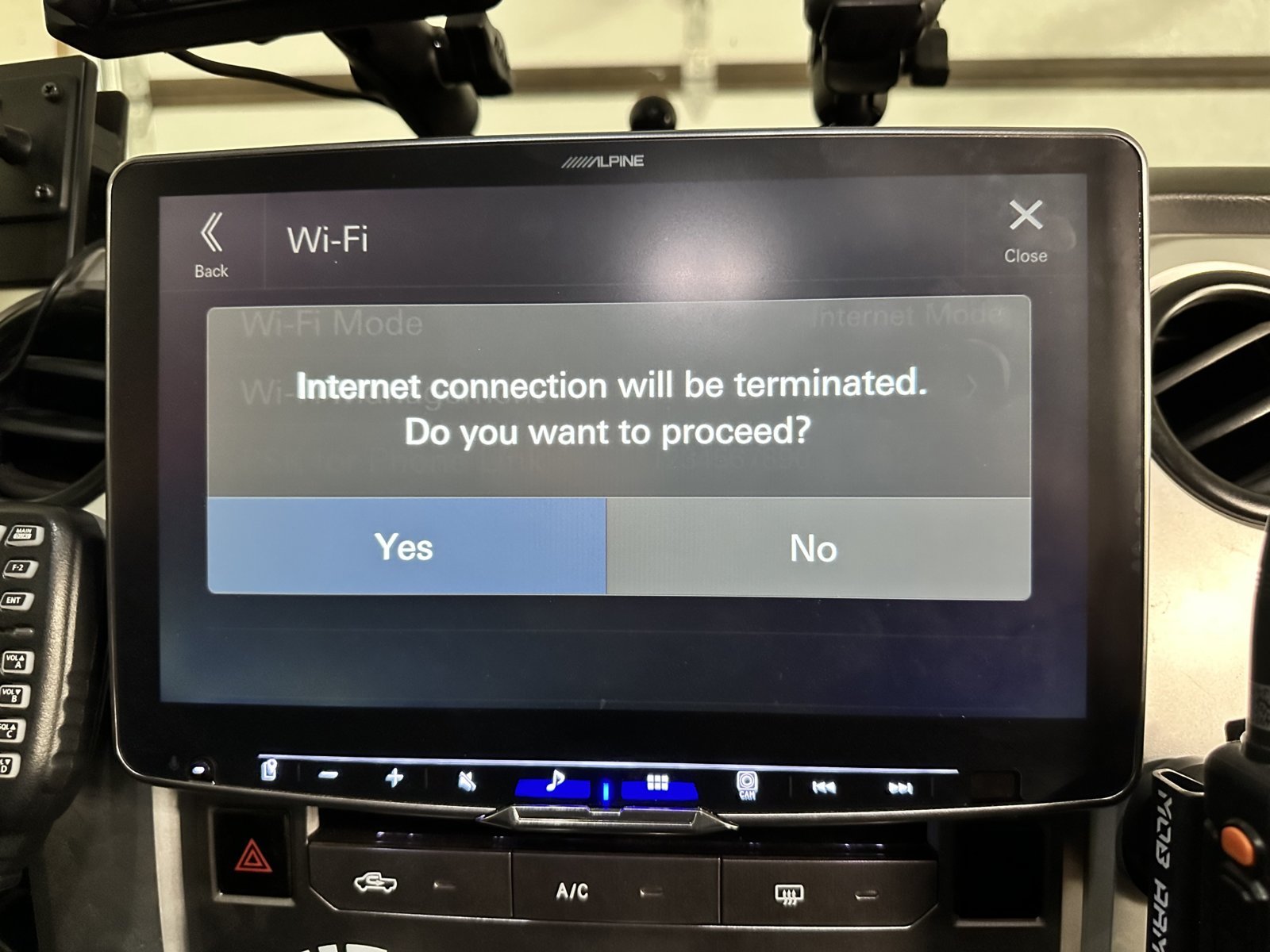

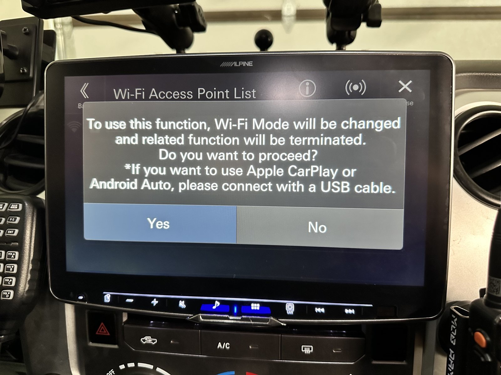

    Finally getting back to this after @wackyhacky asked about updates on the other thread.
    The TL;DR on getting OTA updates to work is restarting the head unit AFTER enabling the wifi connection to check for them.
    Details:
    • Turn your truck on to ACC and head to Settings once the radio is up and running
    • You'll go to the System tab and then down to the bottom option About/Software Update:
    • Tap Over-The-Air Software Update and Connect
    • Add your wifi network if you haven't already and connect, then tap Yes to connect and disable your CarPlay/AA connections:
    • This is where you'll need to turn the truck/radio off for about 30 seconds, then turn it back on. It's important to give it about 30 seconds, as the HU doesn't fully power off right away.
      • I recommend starting the engine and leaving the truck running for the next steps
    • Now go back to Settings>System>About/Software Update and tap Over-The-Air Software Update. If there's one available to download, you'll get the prompt to download and install. If you're up to date, you'll see this:
    • The update will take a good while to download and install, around 10-15 mins if I remember correctly. Don't turn off the power or anything while this is going.
    • Once complete, you'll need to set the Wifi back to Phone Link Mode; Settings>Device>Wi-Fi:
    • Tap Wi-Fi Mode and select Phone Link Mode
    • Tap Yes
    • You're now back in Phone Link Mode and can select your phone to reconnect in the Device menu
    GWill, What the!?, TreeCat and 7 others like this.
  9. Feb 22, 2024 at 3:41 PM
    #909
    Azblue
    Nov 17, 2017
    #11025
    10,134
    The Dirty T ( ^_^)_且

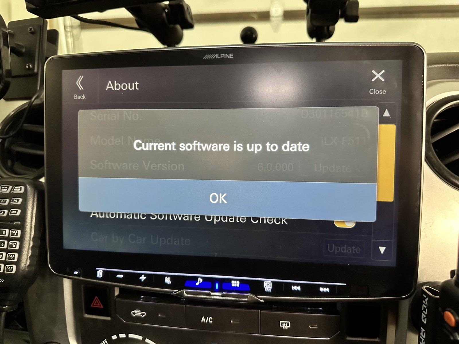

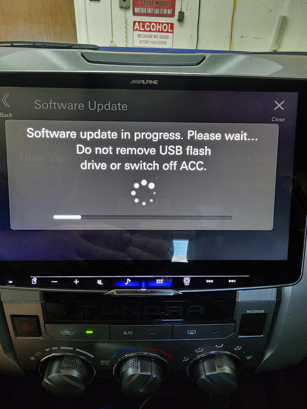

    Well thanks a lot Jake, I followed your instructions and it bricked my H.U. and then my dash caught on fire.
    JK, worked fine. I was on software 5.0 and updated to 6.0. Thanks for the write up!

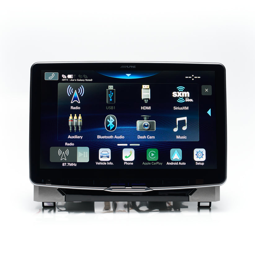

  30. Feb 28, 2024 at 8:36 AM
    #930
    cooper4x4
    cooper4x4 New Member
    Oct 24, 2017
    #10494
    88
    2016 Tundra SR5
    Any suggestions for #1? The steering wheel controls work as configured in the RR2 (based on another post, this should be coming from the OBD connection). I used the attached diagram.
    EDIT...not sure it matters, but I flashed the RR2 after everything was connected and installed. The Alpine didn't turn on until after the flash was complete.
    In lieu of using the "OBDII" connector, I tapped the red/gray wire into the brown wire on pin 2 of the OBDII harness. To mitigate concerns that the splice messed something up, I successfully tested the OBDII port using a scan tool after the splice, so it should be receiving a signal.
    The braided red/yellow wires in the diagram (from the OBDII connector) are labeled "NC" so I assume that means they're not used per another post in this thread.
    The diagram shows 4 connections on the RR2. All four are connected.
    The "Vehicle Info" icon is not showing on the home screen. This is what it should look like: [​IMG]
