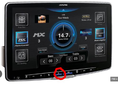

    @TRDFerguson on a side note I think it was you that posted pages back about trying to figure out a way to remove the SiriusXM 360L message that comes up every time you access SiriusXM through the apps screen. Maybe it wasn't you....it was a while ago. Anyways, I found that if you switch sources via the musical note symbol on the bottom of the radio it will change sources and when you get to SiriusXM there is no popup message when accessing through this method. Not sure what you all have connected, but hitting the button twice while on FM radio will get me to SirusXM and four more presses will get me back to FM radio. I haven't found a way to delete the popup message through the apps, but I've been using this workaround for a while.

    Nice! I've honestly never even noticed the music button lol. But, they did remove that stupid popup with the latest firmware update, so it's a non-issue for me now.
