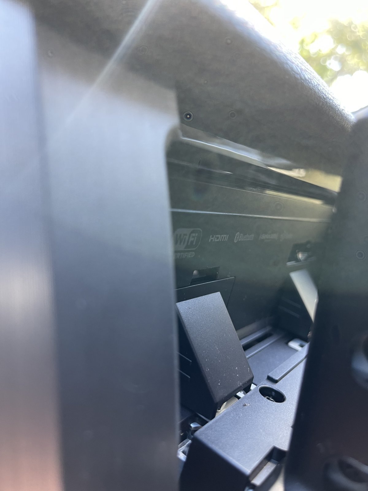

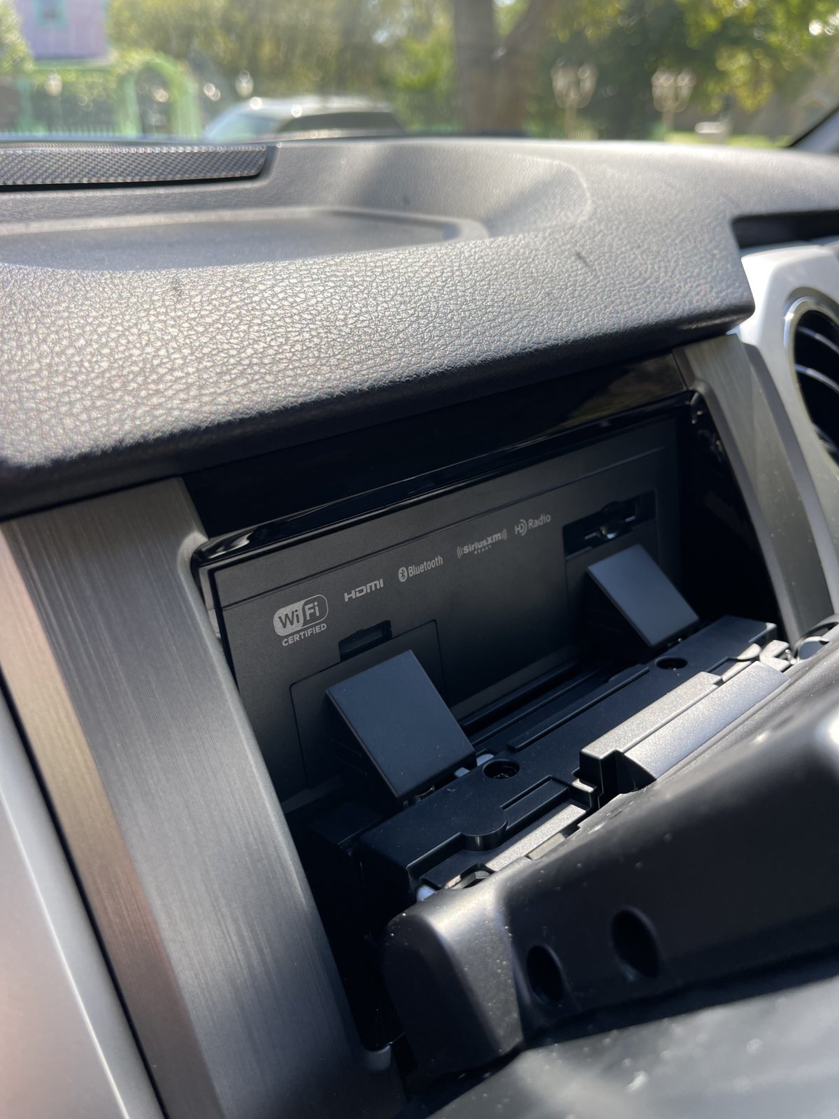

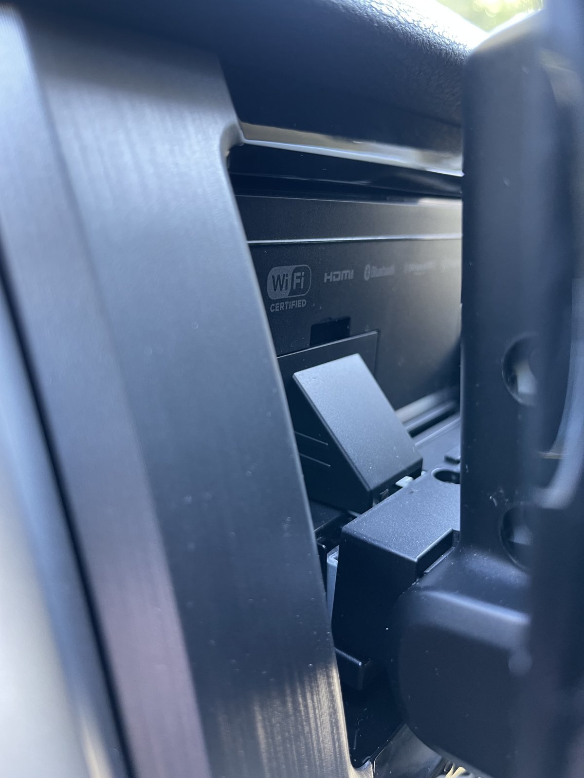

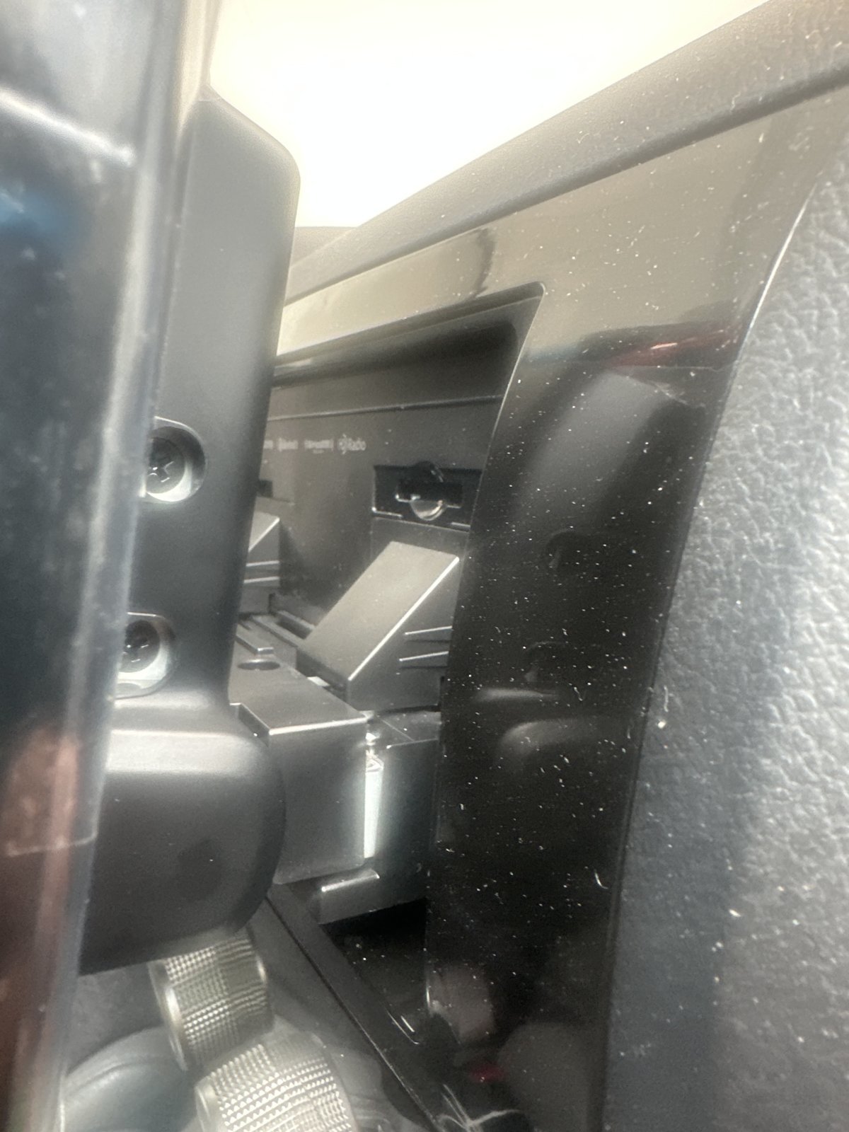

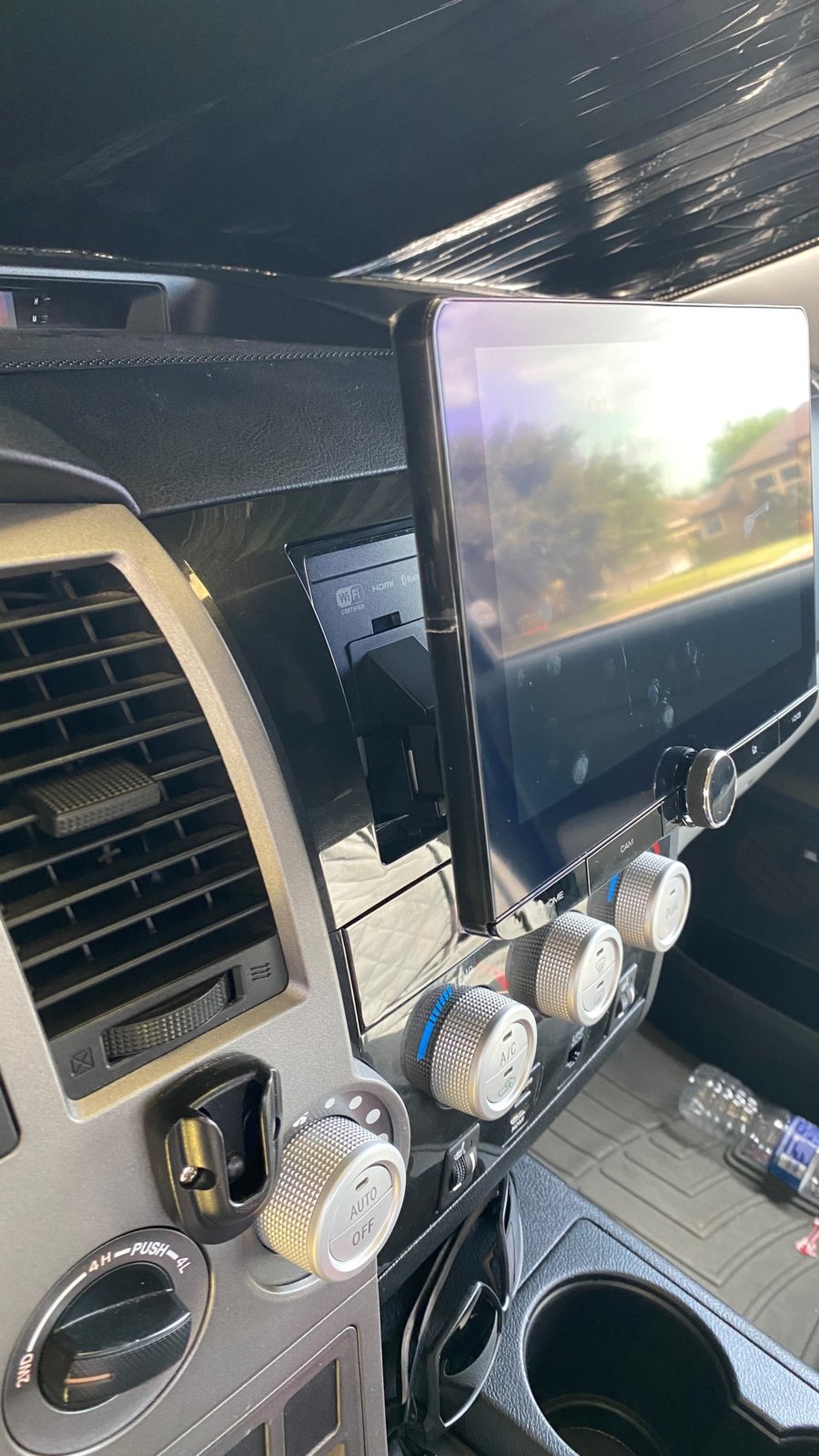

    I finally had a chance to install the Kenwood 1037s from my DMX907s. My question is what did I do wrong that the radio is sticking out so much? I have a 2011 CM using the Metra dash kit.

    https://manual.kenwood.com/files/IM406_ref_K_En_00.pdf
    Page 86 shows you how to adjust the slider position

    Gotcha, thanks.
    I'm assuming I messed up because I watched the 5 Star Car Stereo video on youtube but for a 2.5 gen. He does use the extension like how mine is currently. I will mess with it this weekend and slide it back in.

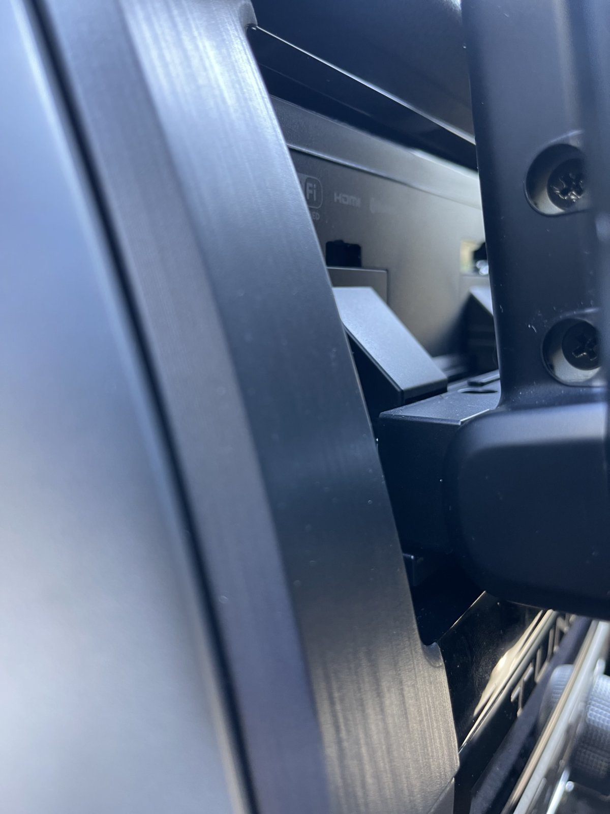

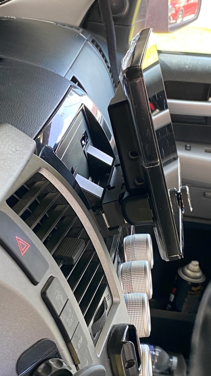

    I don’t think it goes in any farther because of the metal braces you put on it. I thought it was just pushed in like that to protect it during shipping. I futzed with mine for a long time to find the correct mounting on my Dasata trim piece to make it sit flush to the trim opening. Mine seems to sit farther back than yours.

    Wait - it looks like your radio trim sits flush to the dash while mine sticks out. Must be a 2.5 Gen difference.

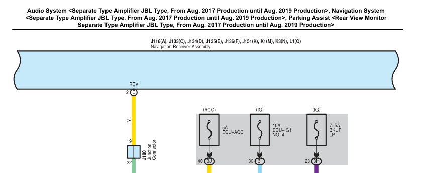

    Im not getting a reverse signal/power out of my Maestro for the backup cam on a Pioneer install, where can I tap a wire (in the dash hopefully) for a 12v signal in reverse? 2019 Platinum.

    Signal comes from the purple white wire. Need to check the box for reverse interrupt on the HU settings too.

    Yeah I got that far, if I push 12v directly to the purple/white wire at the back of the Maestro, the camera comes on. The camera is working, I can manually turn it on as well with the wheel button. So I was just going to hot wire it.
    Do you think it is a Maestro issue?

    Specific to 2018-8/2019 JBL trucks, the REV signal going to the head unit is pin 2 in connector J135 (28-pin white connector). That wire should be yellow (but trust pin number over color).
    I would confirm that the Maestro has a counterpart wire (it should) going to the unit, and then coming from the maestro you have a corresponding wire that goes to whatever the REV lead is for your head unit (check the head unit instructions for that).
    Also look for settings in the head unit itself for activating a reverse camera or for reading a reverse trigger.

    Check the harness for a bent pin.

    Which harness, going into the Maestro? By powering the out from the Maestro and getting camera I confirmed that the wires from the Maestro to the HU are good.

    All of them. Probably not the HU harness since jumping at maestro works but check the OEM to maestro harness connections and the connections going into the maestro box.

    Well, nothing is connected to pin 2, so I tapped that yellow wire and connected it to the purple/white going to the HU, and now I have back cam when put in reverse. Thanks for the intel! I feel like it should have worked without doing this, but whatever.
    Now however, I cannot get the backup cam to come on with the steering wheel control, don't know if this is coincidence or if I pinched a wire or messed with too many setting trying to get the reverse to work. Front camera isn't working either, but this was the first time hooking it up. Flashing the Maestro again tonight and will see if that solves everything in the morning. Thanks for everyone's input.

    If you bypassed the maestro unit input and sent the truck reverse signal directly to the head unit, that would explain why the meastro-controlled steering wheel function doesn’t work.
    To me, the real question is why doesn’t the meastro harness have the reverse signal wire going into the unit.

    This would make sense. The head unit is looking for a trigger on the reverse signal wire to turn it to the rear camera screen and send power to the camera. That reverse signal wire WAS connected from the Maestro to the HU, so when you give it the input on the steering wheel controls it passed that signal to the HU and that turned on the camera.
    What is supposed to ALSO be happening is that the original reverse signal from the truck should be passing into the Maestro as well (or the Maestro needs some other way to know when the truck is in Reverse), so that under normal operation that signal gets sent through the Maestro and on to the HU. When you connected the HU reverse wire directly to the truck reverse wire, you bypassed the Maestro completely for that function so there's nothing making it to the HU from the Maestro to turn on the rear camera at all.
