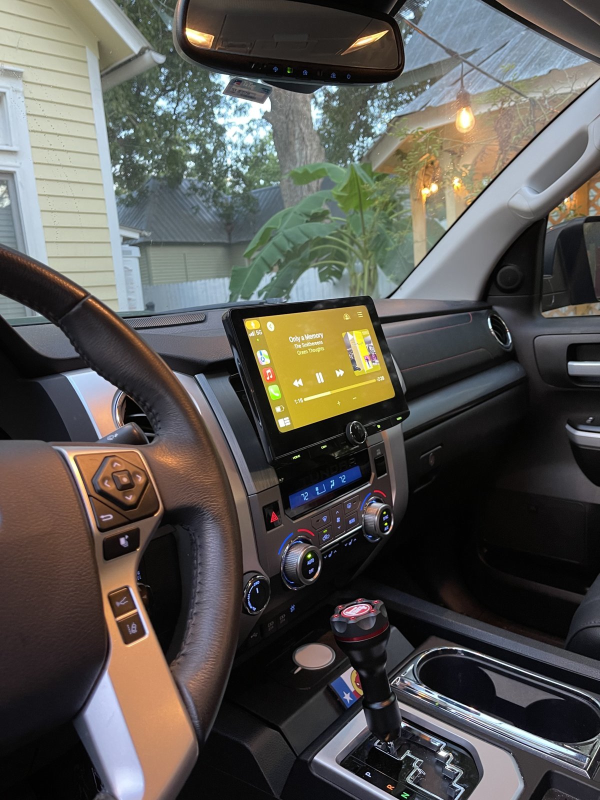

    Kenwood DMX1037s is installed (I did have to contact @RainMan_PNW 911 a few times just to make sure I was hooking up the front cameras right).
    I got distracted and forget to attach the damn idatalink wire and when I was shoving everything to the sides I disconnected the backup camera. Of course I buttoned everything up and then checked. :) Took some searching but I found the missing cable and reattached the backup camera. So far so good.
    I also installed my wife's front camera on her 4runner and have everything already wired up for the Tundra and will take care of it when I get my shim.
    Something that is cool on the Kenwood is the backup camera lines turn with the wheels. I need to read the instructions but is there a why to turn off the OEM lines?

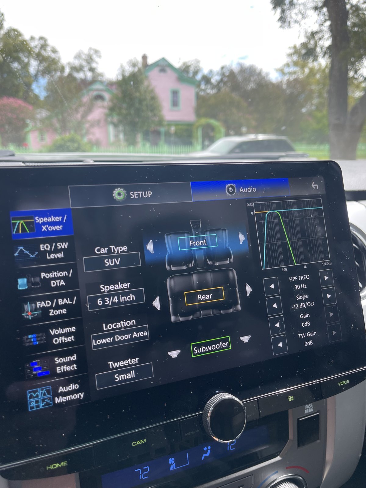

    @BiggHertz - wondering if you can help since you are a Kenwood guy. The call volume is super low on the Kenwood I installed. It sounds like it's only coming from the center speaker and even at level 40, it's a little low. Am I missing a setting somewhere?
  5. Oct 8, 2023 at 7:55 PM
    #725
    BiggHertz
    BiggHertz DZTLIMO
    Nov 24, 2019
    #39101
    2,178
    Chandler, AZ
    IG: dztlimo
    Stuff and Things
    bluetooth or wired connection from phone to the headunit?
  6. Oct 8, 2023 at 8:00 PM
    #726
    TaquitoBandito
    Sep 29, 2017
    #9976
    9,036
    Joel (AKA Bif)
    Bluetooth Apple CarPlay
  7. Oct 8, 2023 at 8:05 PM
    #727
    BiggHertz
    BiggHertz DZTLIMO
    Nov 24, 2019
    #39101
    2,178
    Chandler, AZ
    IG: dztlimo
    Stuff and Things
    When connected via bluetooth, be sure to turn up the volume on your cellphone.

    I did that. Still sounds like a whisper

    Maestro programming, maybe? I know some that use a DSP off the JBL have weird channel issues with some CarPlay functions, though I don’t remember the specifics.

    The front door speakers sound really muddled. I'm wondering if I pulled the RF & LF a little when I pulled it out the 2nd time and missed it.

    Clark County, WA
    2021 Lunar Rock TRD Pro CM
    Technically, wireless CarPlay isn’t Bluetooth.
    It uses BT to negotiate the initial connection and then it uses wifi for the actual connection/stream.
    when connected via CarPlay, none of the phone buttons will do shit for volume.
    siri is also a bit of a bitch to get set up just right - her volume is tough to set over CarPlay without turning it up or down while she’s talking.
    are there any gain or volume settings in the HU for phone calls? Seems like the alpine had something for those in it, but I’ve already forgotten.

    Updated the Kenwood and calls sounds better, I think. It's weird that you barely hear it ring when it calls but then the voice is louder when the person pics up. Also, when someone calls me, my phone rings instead of it ringing over the car stereo. I actually kind of like that though.
    I guess I get so try to set this up... I wish it could just magically set itself up. I'm almost 51 and tired of learning new shit. :(
