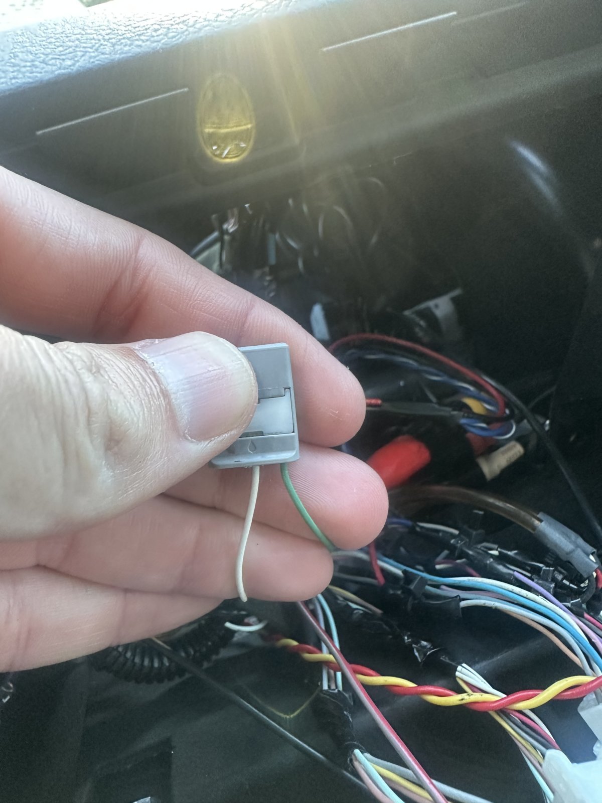

    OK here we go
    issue is fixed
    Called Crutchfield
    on some models you have to pull 12v reverse signal straight through by itself if you’re getting low voltage/no reverse signal and completely bypass the harness
    attached are photos of the connector. The green wire is the reverse wire to tap into
    Some vehicles will have all 3 wires. Some will only have 2,as mine did.
    hope this helps somebody
    on the Kenwood DMX1037s models
