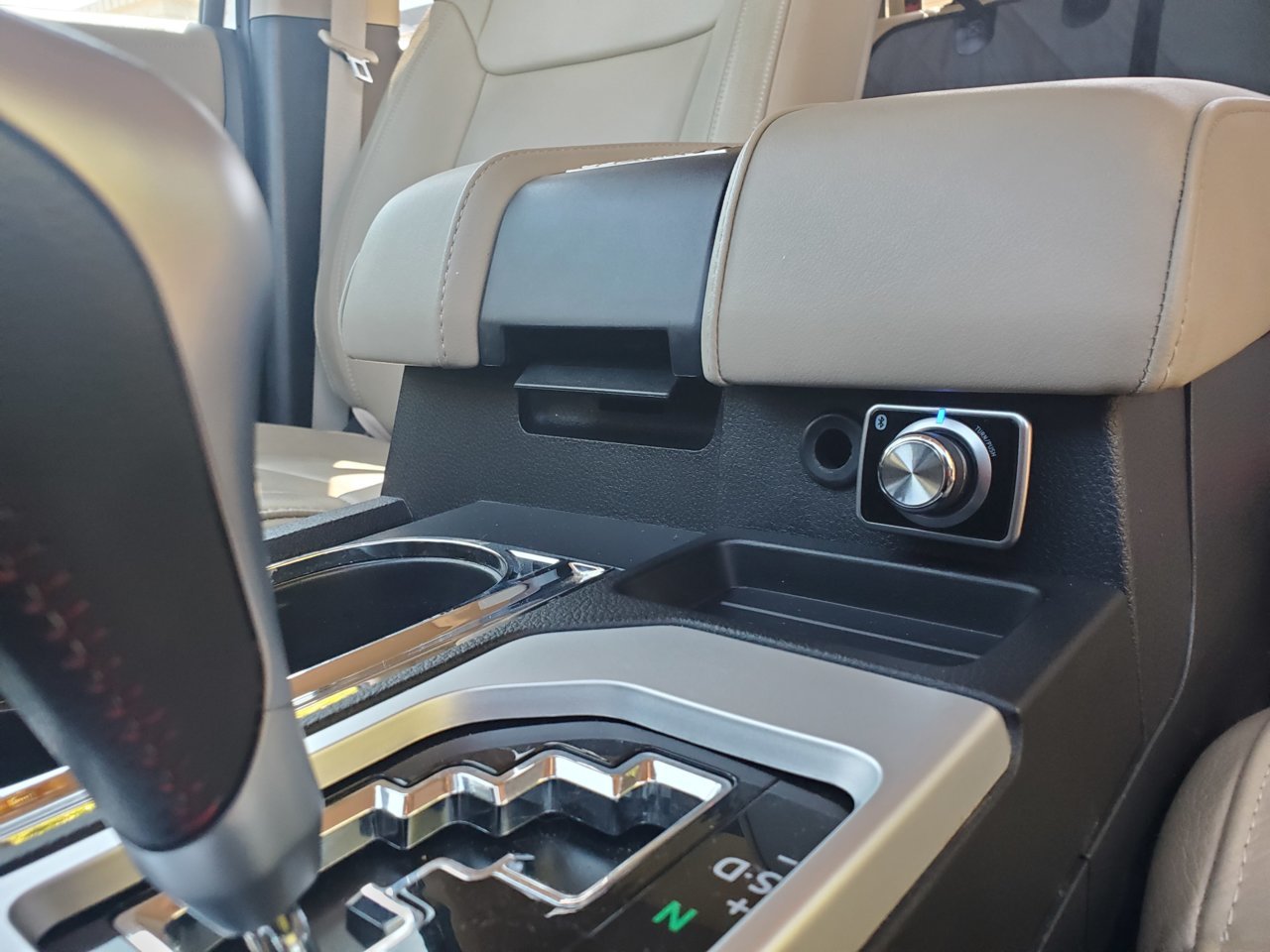

    Picture of the volume/bass knob installed. I placed it where I previously had my FRAC switches. The knob covered one of the holes I had and the other I just popped a grommet in to look a little more refined. The knob works great and is in a perfect position since my arm is always on the center armrest. I wasn't a fan of mounting the knob on the side of the radio with the included bracket.
  30. Sep 17, 2023 at 8:17 PM
    #570
    WFD473
    WFD473 Long Live The V8
    Oct 10, 2018
    #20393
    680
    Northeast Illinois
    2014 MGM SR5 CM 4x4
    Are you having any issues with it connecting when you start the truck? When I first paired it, it worked fine. Ever since it won't reconnect even when I turn it on first before I start the truck.
    AZTundra[QUOTED] likes this.
