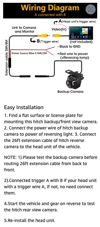

    I was gonna say that swapping the rear camera to the front input proves the input is working. But what about connecting the front camera to the rear input? Methinks something in the powering/triggering of the front camera is at fault here.
    Is the "power" wire you are using actually the trigger wire by the RCA plug?
  3. Sep 4, 2023 at 1:03 PM
    #333
    AZBoatHauler
    Aug 13, 2019
    #34576
    9,388
    So.Arizona
    No, trigger wire is unused. It’s wired just like that diagram.
  4. Sep 4, 2023 at 1:05 PM
    #334
    AZBoatHauler
    Aug 13, 2019
    #34576
    9,388
    So.Arizona
    Is there a trigger wire on the Alpine? If so, that’s probably the issue. I don’t believe the Kenwood used one.
  5. Sep 4, 2023 at 3:13 PM
    #335
    RainMan_PNW
    RainMan_PNW [OP] "Oz" SSEM #82 RGBA #4 Unofficial Forum Treasurer Vendor?
    Oct 27, 2020
    #54134
    16,985
    Casey
    Clark County, WA
    2021 Lunar Rock TRD Pro CM
    For front camera I wouldn't expect the trigger wire to be needed, but am not 100% sure TBH.

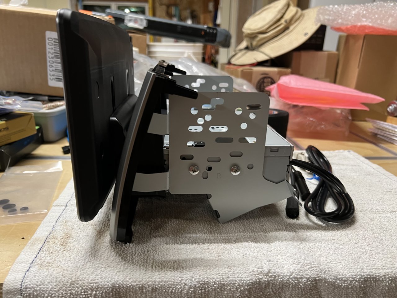

    Started futzing around with fitment on the Alpine tonight. I have the “slide” positioned in the “short” or “in” position (the way it came from the factory). The screen I have set to one position up from the bottom (-15mm according to the manual). The body I have mounted in the lower part of the Dasaita mounting brackets.
    I am aiming to keep it low without interfering with the AC panel, and want to tuck it back as far as possible. I need to pull the radio to actually test fit with the dash, but just based on what I’ve got here I’m thinking about slotting the mounting holes in the side plates to slide it back into the dash a little farther. I may also experiment with dropping it one more set of holes. I am glad to say that none of the screws were overnight on mine.
