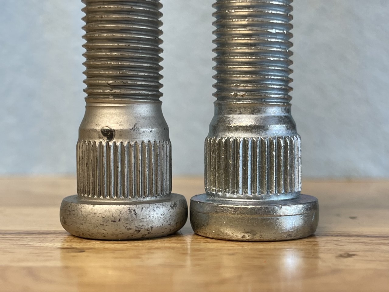

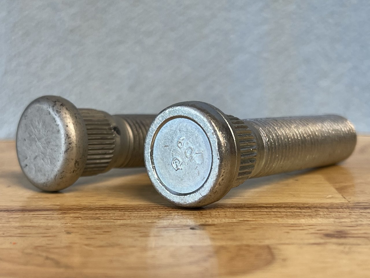

    just a heads up the ones from Japan have a 99 dollar shipping charge… so it’s not like the price reflects the quality. here’s some pics of a brand new OEM stud next to the brand new eBay studs.

    I wanted to get these studs too but just saw on the webpage “16.3mm spline diameter” instead of 16.5mm. Do you feel any difference comparing to your rear ones or being loose?

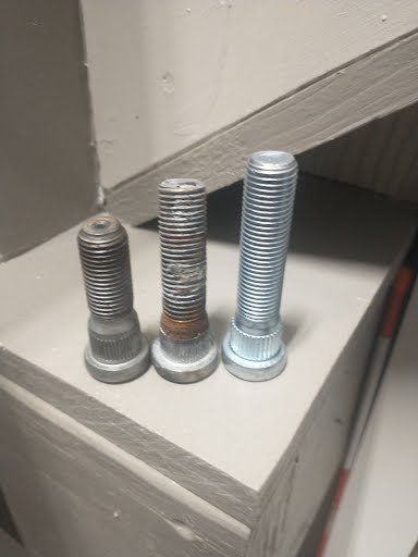

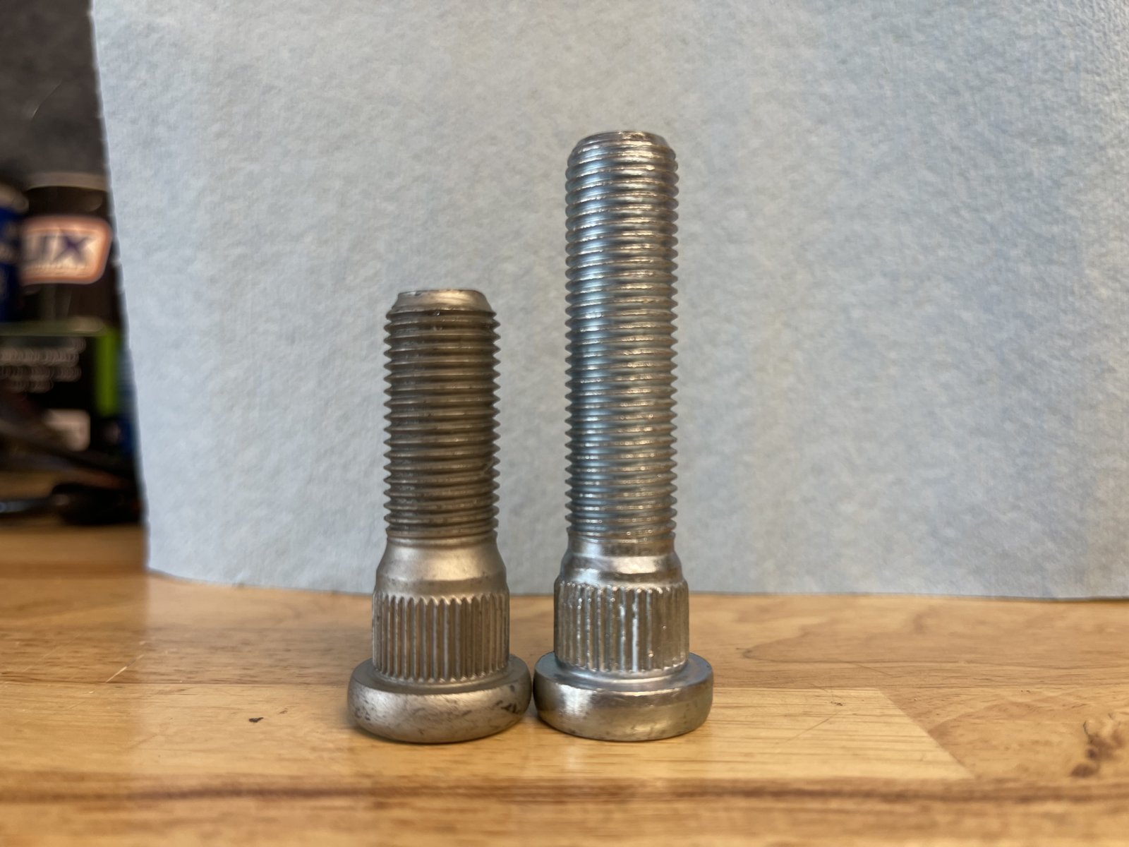

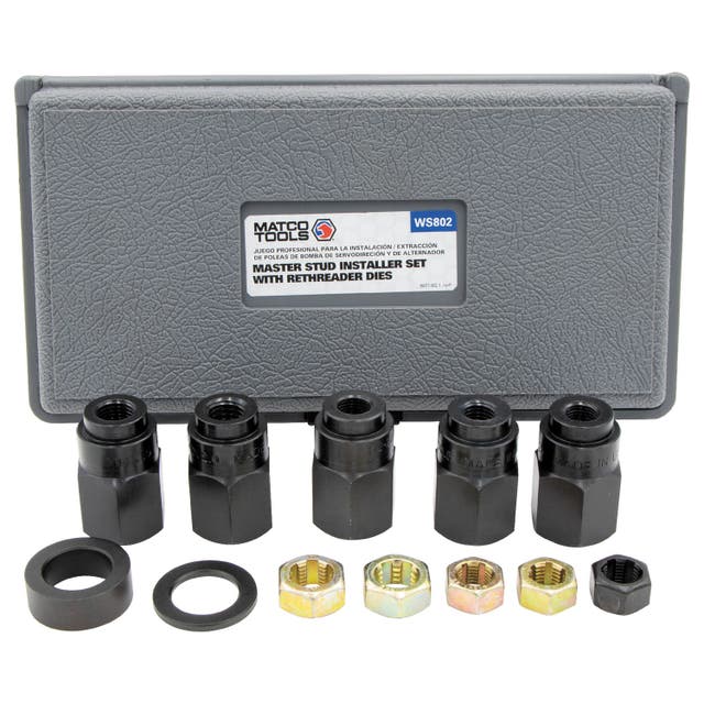

    Installed the Ebay studs today. Pic below shows stock, bent Japanese, and the Ebay. I have to say the Ebay studs were a bear to install. So much so that I didnt have it in me to do the other side today. I ruined 2 lugs installing the ebay studs and had to clean/reathread the threads on all of them. After realizing each lug was destroying the threads on the lugs I got a more heavy duty stud installer. My verdict is the ebay studs are pretty stocky but crap threads and they are too long which makes installation much more difficult. I will see how they hold up and think that they will work but ultimately left thinking we still don't have a perfect solution for aftermarket longer wheel studs.
    edit: also I had a lot of metal flakes during install of each stud. I dont know if it was the studs shearing or part of the tool ie install washer. Just left me feeling pretty unsettled to see that.
    Also here is the stud installer kit I had to use. The bearing tool that someone else posted didn't work so well due to the length of the studs.

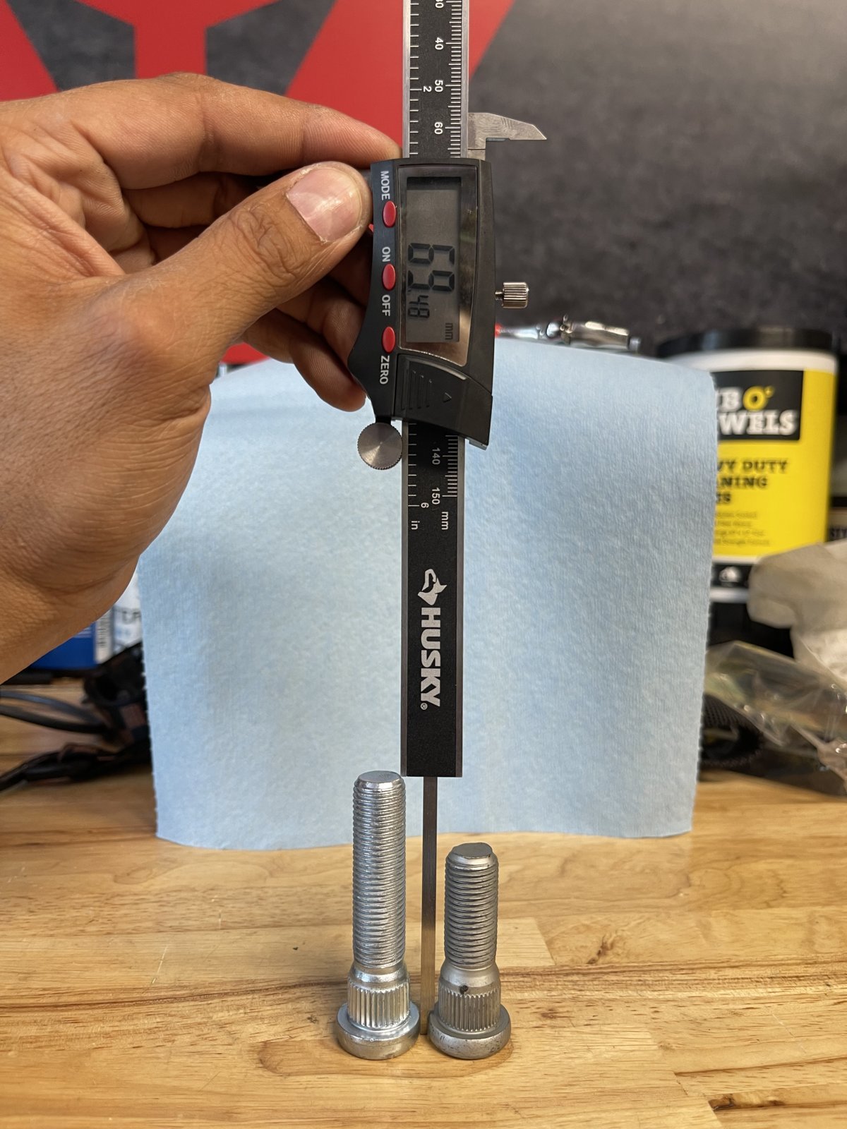

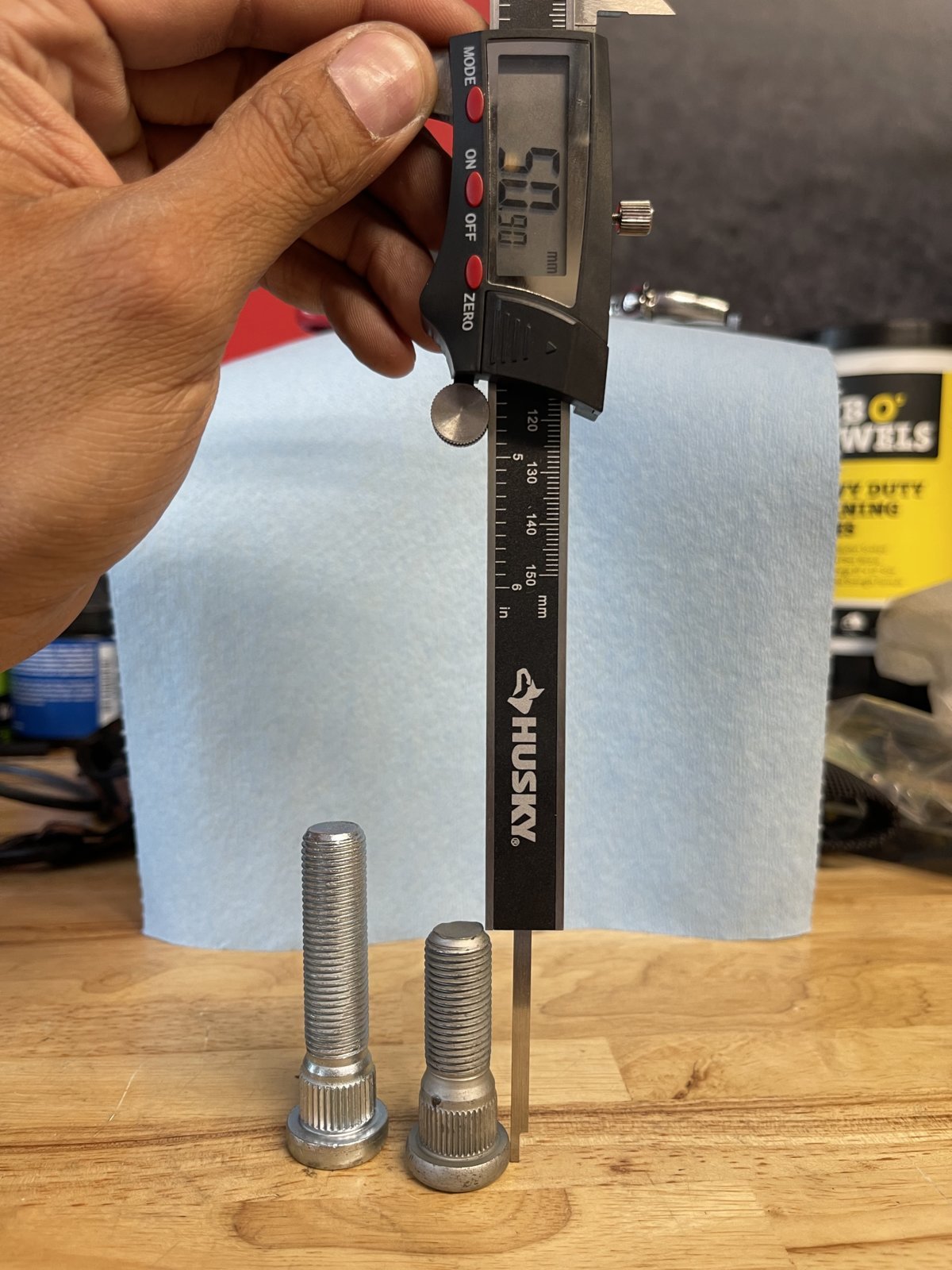

    Pictured is a brand new OEM stud and a brand new EBay stud.

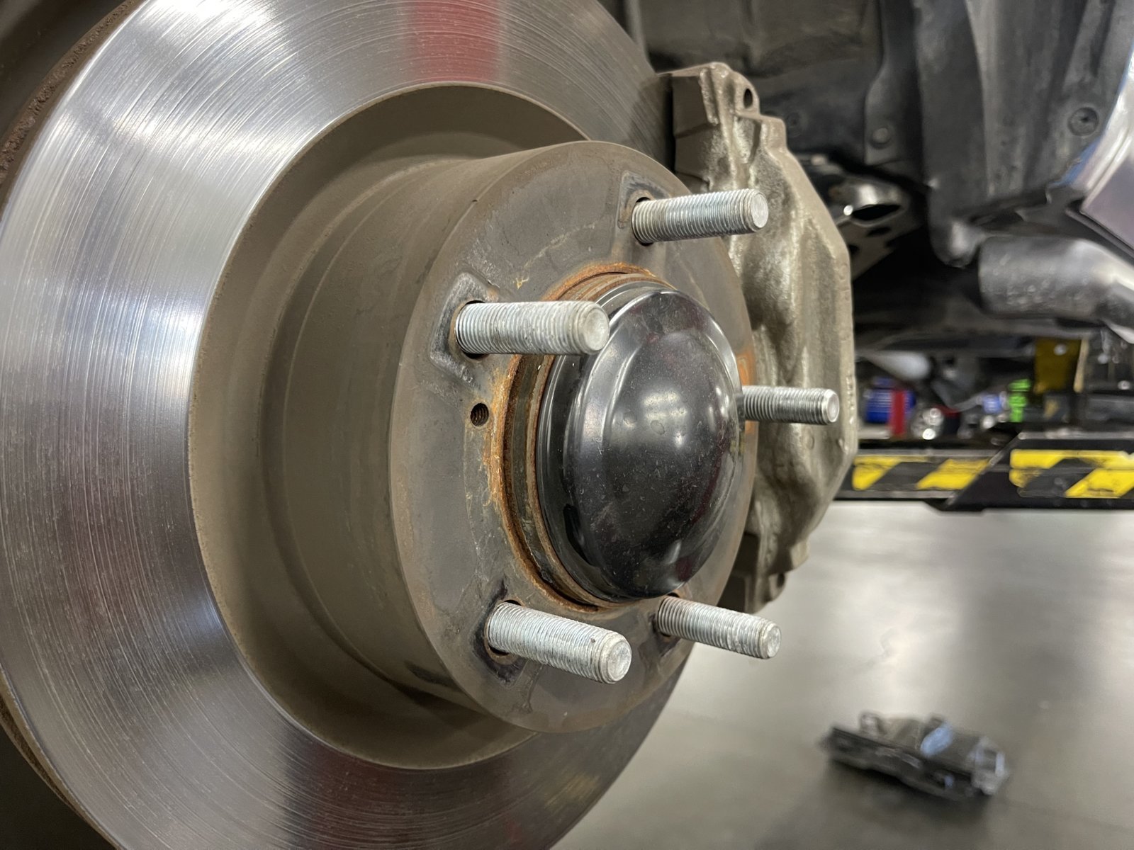

    Update on the eBay studs!
    Installed @ 11,940.
    sadly been horrible at doing my tire rotations. But performed one yesterday at 23,788.
    There is ONE issue. Nothing is loose, cracked, rusted, or compromised at all. Unknown to me was that the locking lugs from RRW are NOT compatible it’s the eBay extended studs as the locking lug bottoms out on the stud BEFOFE it seats against the rim.
    that being said each lug on the front are damaged from trying to tighten the locking lug.
    So if you are going to run these studs please make sure that you run open ended locking lugs. I’m sorry if anyone has also incurred any damage. If you zoom into the lugs and inspect the threads you can see the damage, also the light surface rust on the rotor where the wheel had a slight gap, allowing moisture to get trapped, which can be seen on both sides.
