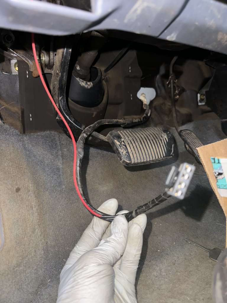

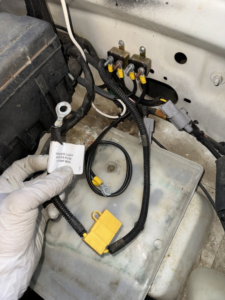

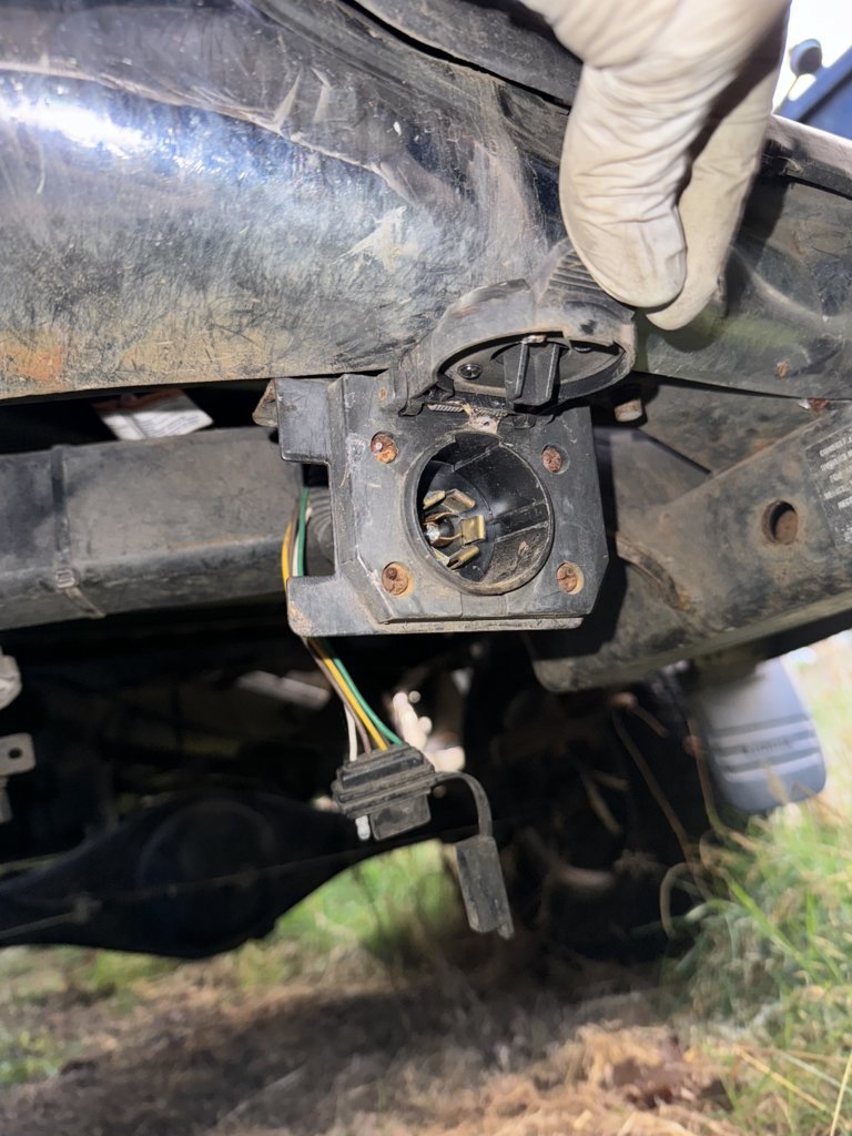

    These are all the parts i bought to convert my 2000 AC from a 4 pin to a 7 pin along with a brake controller. I bought it all at etrailer. It’s definitely not plug n’ play like on the 2002 (or is it 2003) and newer trucks. What all trailer wiring parts do you have so far? Do you need to buy more shtuff?
