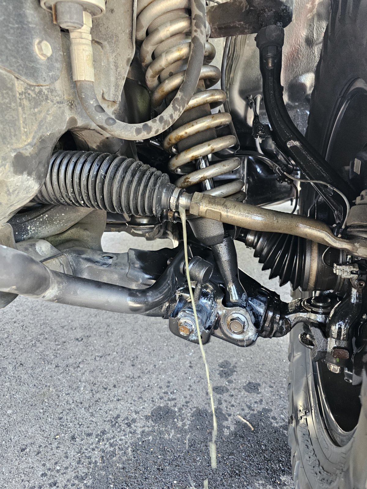

    This thread is giving me the courage I need to get it done. Y'all are awesome. I was quoted $3500 from a local shop. I am mechanically inclined, but don't have the shop space anymore so usually just opt for local mechanics.
    This will be my first rack and pinion install. Would appreciate any feedback or "wish I knew's". Got my Detroit axle parts on order, ive had great luck with their stuff in other applications. Here is my truck tax: 2014 SR5 - 6" RC lift and 35" Toyos.

    I did not end up going with Detroit. After calling around, my local Toyota dealer is giving a lifetime warranty on the OEM part and labor. Even made them reply in writing it wasn't void because of a lift. Ended up about $2600 out the door with tie rod ends and an alignment. But the lifetime warranty took some sting out of it.
